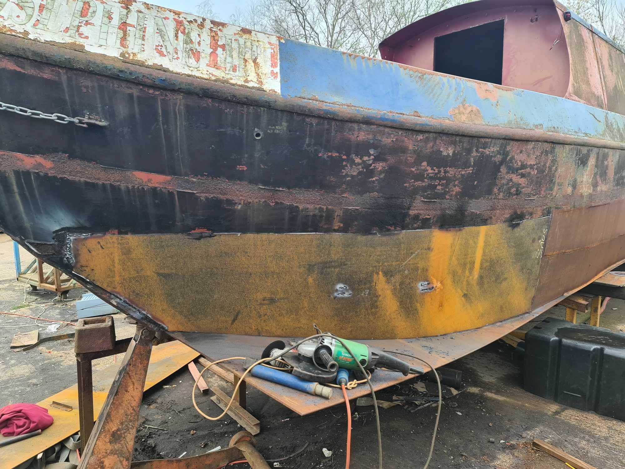

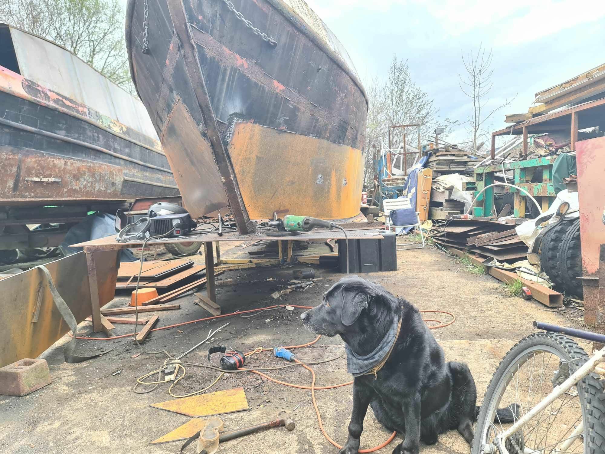

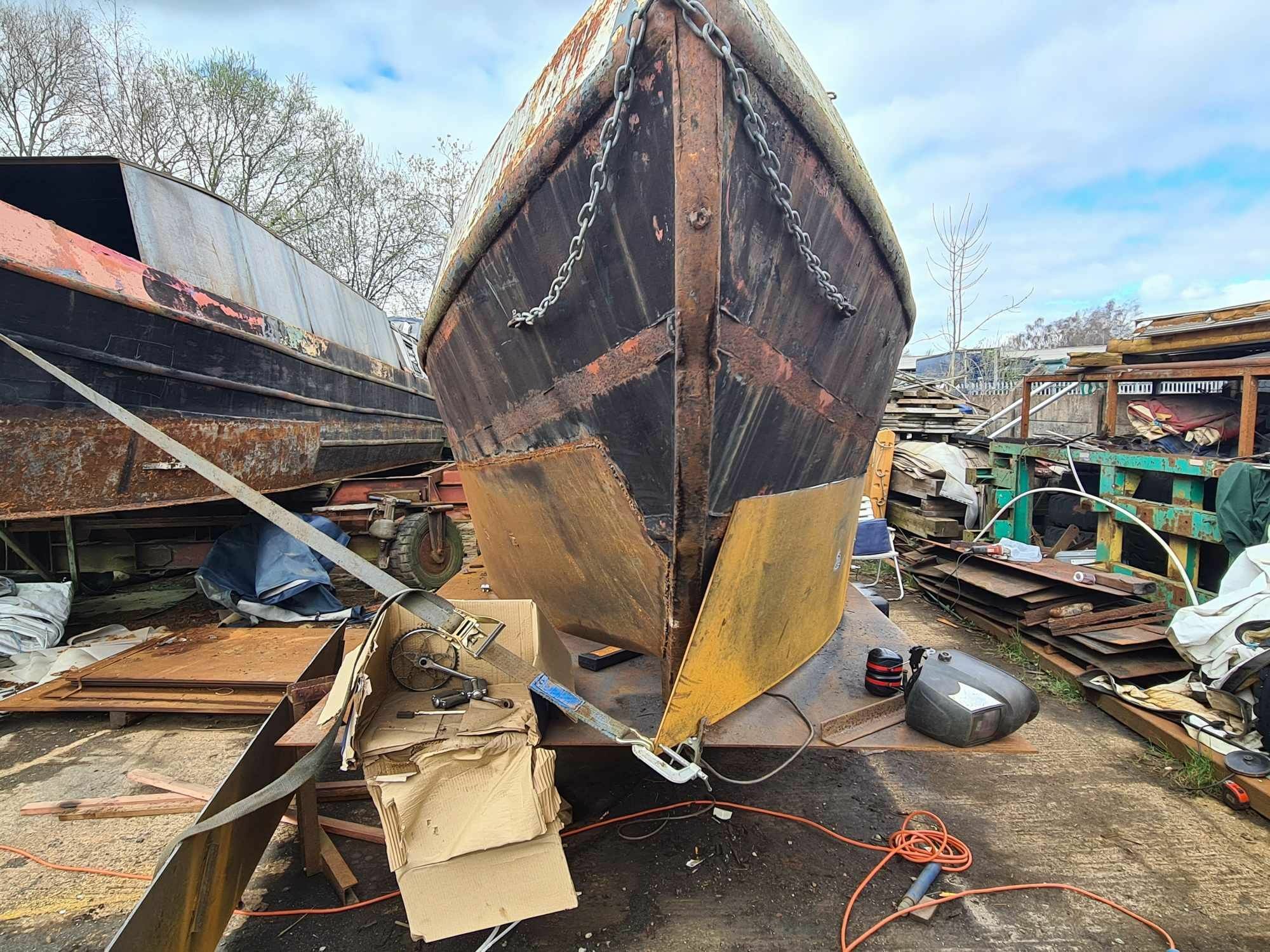

I promise you, it's really easy. Let me show you how...
With the top left corner of the sheet tacked in, the bottom of the sheet could then be pulled in to match the bottom of the hull side where it meets the baseplate. This was done (as ever) by welding an eyelet on the inside and pulling it into shape with a chain hoist, then tack it into place
With that in place the front of the sheet can then be pulled round the existing bow, and used as a ruler to run a grinder along to ensure the plate fits spot on. The original hole is deliberately undersized and is effectively just cut for access. You'd be stunned at how little force it took to bend it, I could get it most of the way round by simply leaning on it.
When the grinder has been run along it a pretty decent level of fit-up is achieved. Note the pitting above where the new steel is going in. It's a bit annoying but it's well above the waterline, i'm contemplating the best way to fill it in, possibly an epoxy fairing filler, possibly lead loading, open to suggestions

Part 3- Hole removed.
If you continue running the grinder along the top of the sheet then eventually you reach the stem bar. At that point you should stop, and your work should look something like this
At which point simply trace a line off the stem bar, cut down it, pull the bottom in and job done! I'll seam weld this up soon, but I was fortunate enough to have "the apprentice" helping out (My dad) and it's not the most entertaining thing to stand around and watch someone wave sparklers about, so we went to the pub.
The observant among you will note a gaping triangular hole under the plate, this forms naturally when the plate bends round. Originally the shell builder filled this in to give a flat baseplate, and this was my plan, however another way of doing it is to jack the baseplate up to meet it. Seeing how rusty the bottom 2" of the stem bar was sealed the deal for me, and i'll be bringing the baseplate up once i've done the other side. A lot of boats are done like this, i've a sneaky suspicion it might make more wash but if it's really terrible it would be easy enough to rework at a later date as there will only be water tank behind it.
The pitting above the new bit is right where it will get clouted by bridge holes, lock mouths and the like.  Epoxy filler will not like it at all.  Nor am I sure that if you leaded it you will be able to get the steel clean enough to get a proper tinning for the lead.  If you can it should be flexible enough  but will dent very easily.
You could either overplate the area and fair the edges very carefully or just lay down a pad of heavy runs of  weld and fair them off with a grinder.  A good way to use up a box of odd or not well kept rods.
Or, as it is mainly  along a guard iron run, a BCN style wide guard over it all.
I was wondering if you'd spotted that triangular hole.
My last boat was quite deep drafted and built with the baseplate flat and the triangle infilled (rather than the baseplate jacked up as most new boats seem to have), and it actually a bit of a pain. The extra 6" of draft right at the pointy bit meant I sometimes couldn't put the bow in as close as I'd have liked to the bank when single handing. Or rather, with the jacked up baseplate style I'd have been able on occasions to get 2ft closer in which I'd have preferred. So basically I'm suggesting you jack up your baseplate rather than infill the gap. Means you'll need a bit less ballast at the bow too, once you're afloat.

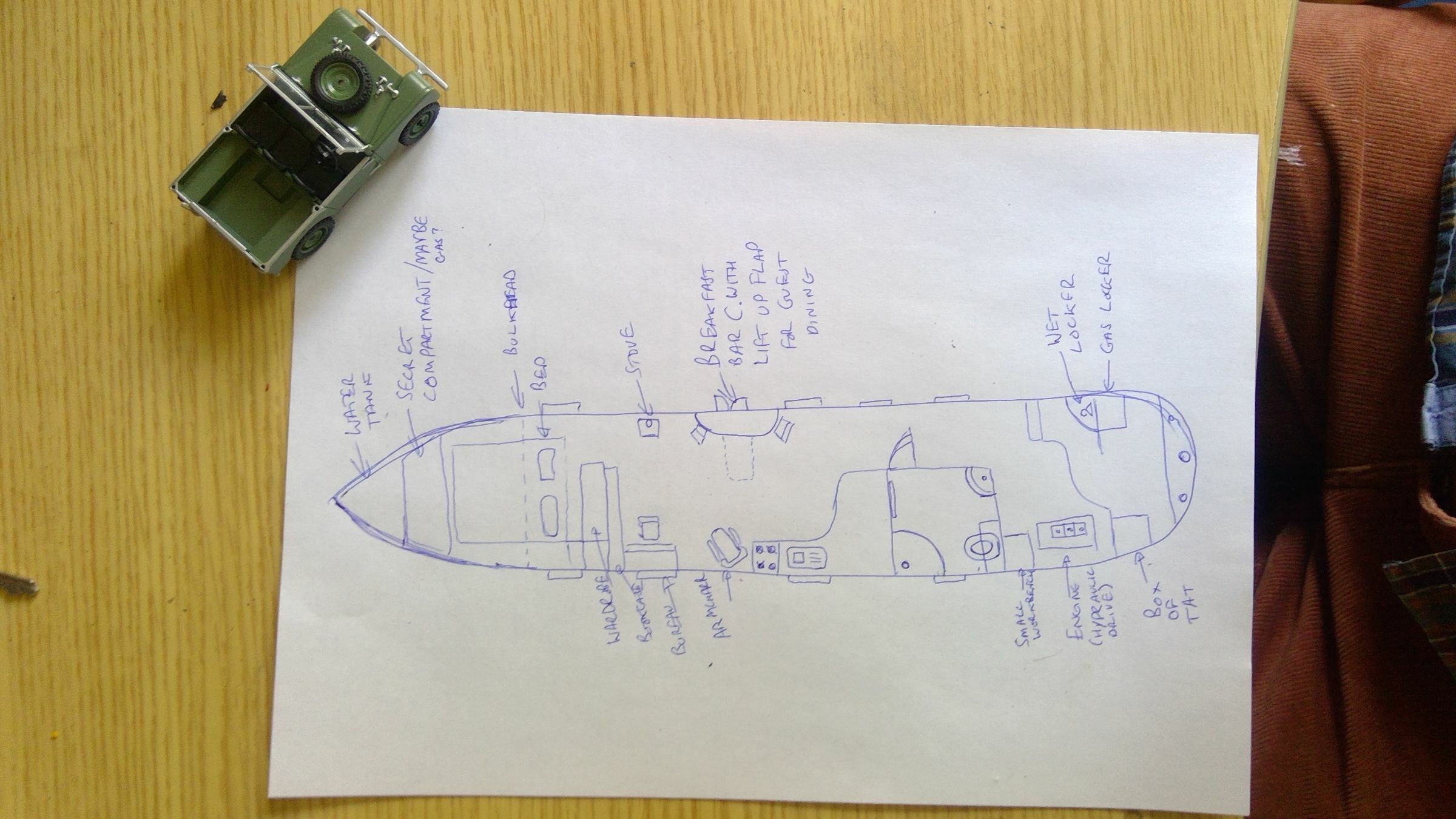

To keep you all amused here's my proposed interior rough fitout, for your critique

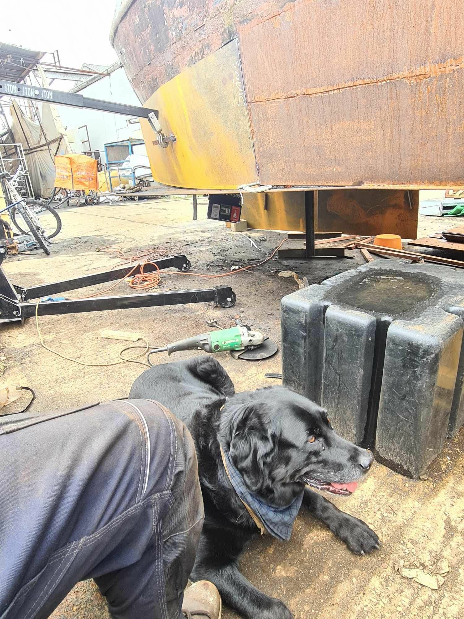

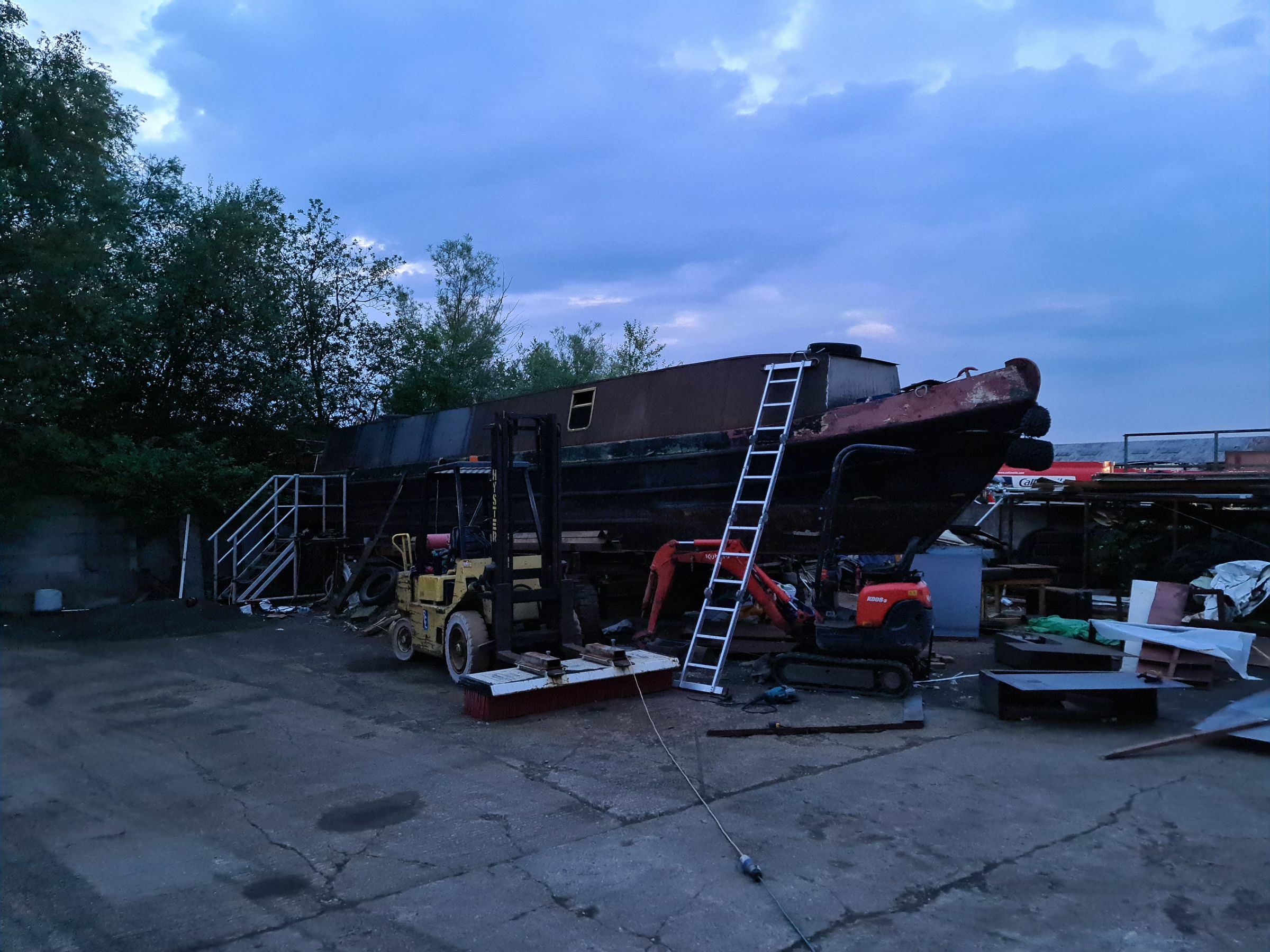

Back at it! Productive weekend with plenty more in the pipeline now, life reconfigured for the better.
Finished off the welding of the plate that I put in last time, and welded up inside the bow (inc fitting the scantlings) as the next major step will be to make and fit the tug deck
The new boatyard* is quite different to the old one, this is a far more involved project than most people have seen done here so they all think i'm a fruitcake
*You may recognise where it is, please don't mention it at the moment but if you're local then feel free to message me to pop round for a chat
