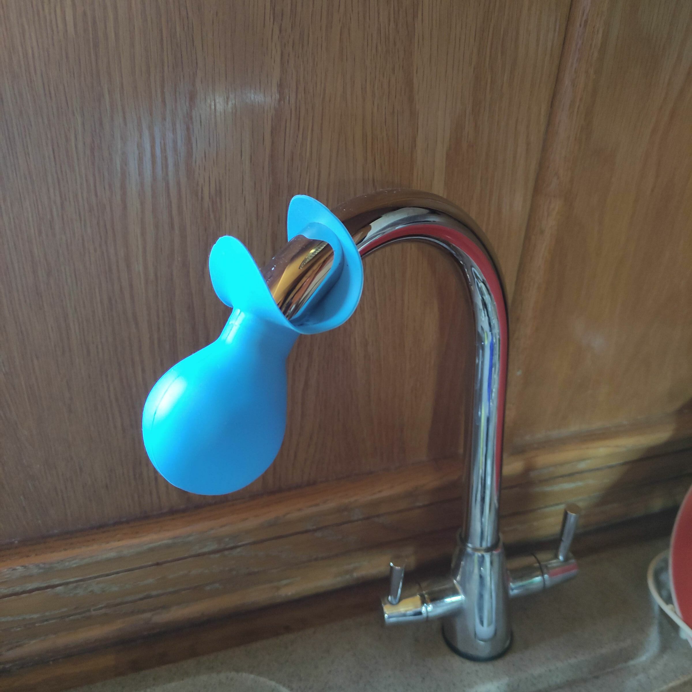

blackrose Posted May 5, 2022 Report Posted May 5, 2022 For those in hardwater areas, how do you remove the build up of limescale on the end of your taps? Also I haven't lived in a house for many years but I never remember it being an issue. Perhaps that's because when I did live in houses and flats I was just renting so I didn't care, I'm not sure. Anyway, I bought this rubber tap scrotum from ebay for a couple of quid. You just attach it to the tap and fill it with vinegar. Seems to work quite well. 1 1

booke23 Posted May 5, 2022 Report Posted May 5, 2022 A very good idea that product. I use food grade powered citric acid....it's much stronger than vinegar and can be bought off amazon in 1kg bags. Just put a teaspoon of it in that receptacle and fill with warm water...stir it a bit and put it on the tap and leave it for an hour or two and it'll be as good as new. You can use the citric acid in kettles, shower heads etc with no ill effects. 1
David Mack Posted May 5, 2022 Report Posted May 5, 2022 I have improvised by wrapping a poultice of toilet paper soaked in vinegar around taps, but that scrotum looks to be much easier. (Did they advertise it as a 'tap scrotum' or did you just make the name up?) 1

blackrose Posted May 5, 2022 Author Report Posted May 5, 2022 2 hours ago, David Mack said: I have improvised by wrapping a poultice of toilet paper soaked in vinegar around taps, but that scrotum looks to be much easier. (Did they advertise it as a 'tap scrotum' or did you just make the name up?) I came up with that name. I think it was just called a tap descaler. 4 hours ago, booke23 said: A very good idea that product. I use food grade powered citric acid....it's much stronger than vinegar and can be bought off amazon in 1kg bags. Just put a teaspoon of it in that receptacle and fill with warm water...stir it a bit and put it on the tap and leave it for an hour or two and it'll be as good as new. You can use the citric acid in kettles, shower heads etc with no ill effects. Thanks, I'll have a look at citric acid if it's stronger than acetic acid (vinegar).

booke23 Posted May 5, 2022 Report Posted May 5, 2022 2 hours ago, blackrose said: I'll have a look at citric acid if it's stronger than acetic acid (vinegar). There isn't much difference in strength, but vinegar is 95% water whereas you can make a stronger solution with citric acid powder. But more importantly, citric acid is a tribasic acid which means the chemical reaction is faster and limescale disappears faster, whereas acetic acid is a monobasic acid so the chemical reaction is slower. 1

Murflynn Posted May 7, 2022 Report Posted May 7, 2022 doesn't the tap have a screw-on nozzle? when I moved into my flat in Abingdon Marina that had been unoccupied for years I found all the taps were gunged up with scale but I managed to remove the bits at the spout end and soak them in vinegar overnight. Job's a good'un.

blackrose Posted May 7, 2022 Author Report Posted May 7, 2022 8 hours ago, Murflynn said: doesn't the tap have a screw-on nozzle? when I moved into my flat in Abingdon Marina that had been unoccupied for years I found all the taps were gunged up with scale but I managed to remove the bits at the spout end and soak them in vinegar overnight. Job's a good'un. Only the kitchen one and it's a pain to get it off.
