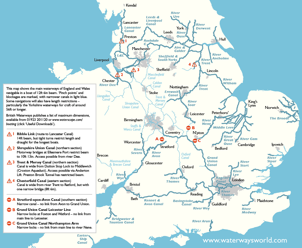

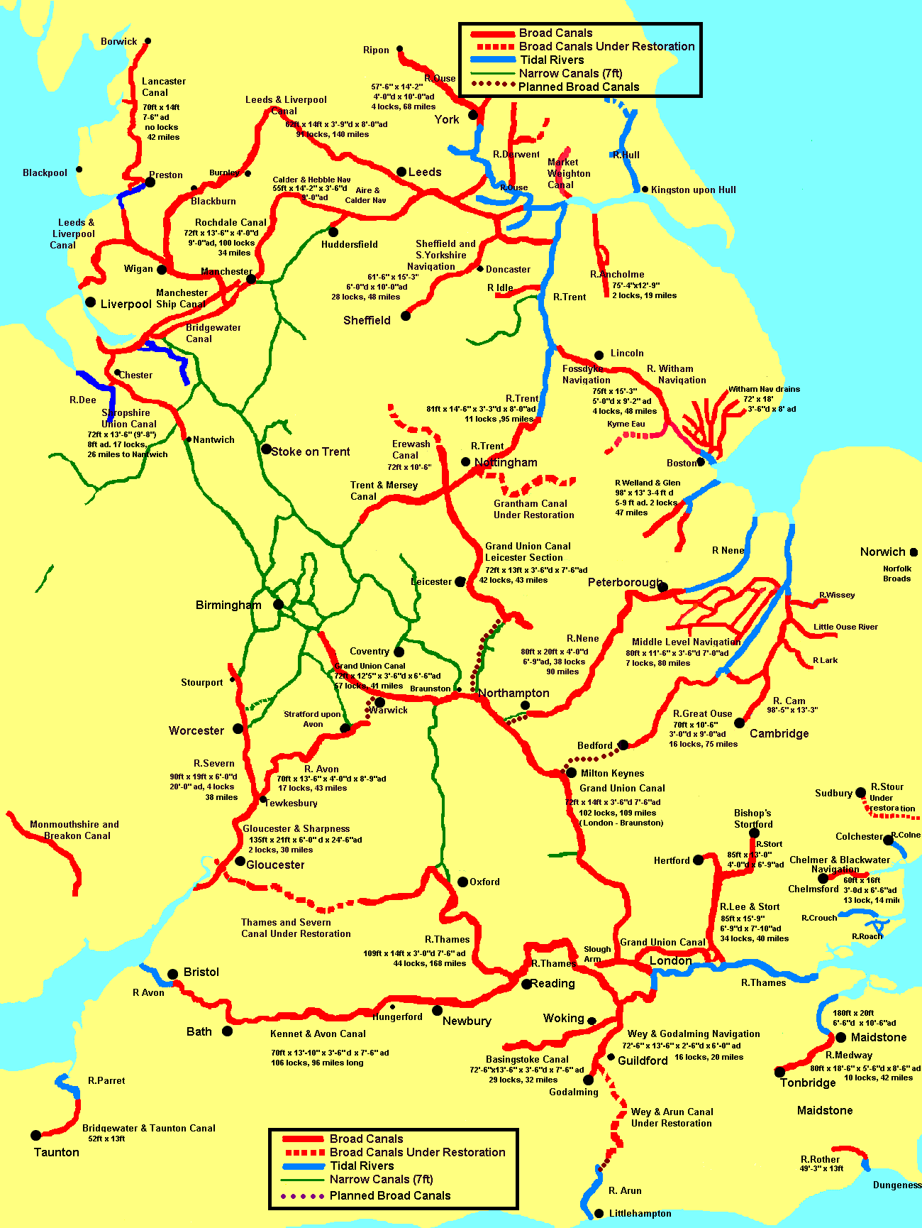

Basically the answer is NO
With a Narrowboat you can go from South to North of Manchester(ish) / Leed(ish) With a wideboat you can get from (roughly) South to Leicester then you need to be lifted out and go from Leicester Northwards to North Manchester(ish) / Leed(ish) You can see a NARROW link from about Northampton to Leicester
Hopefully these maps will show you what is connected to where.
Red = Widebeam canals
Green = Narrow canals
Narrowboats can obviously use wide canals but not vice-versa

The maps Alan has posted show narrow and wide waterways, but don't indicate the maximum boat length.
A 70 ft long narrow boat can operate over the waterways of the south, midlands and northwest, but you are limited to a maximum length of around 57 ft 6 ins for some of the Yorkshire canals (and Leeds & Liverpool east of Wigan).
There are also couple of shorter length restrictions on the periphery of the Middle Level and River Lark, but these are remote enough not to affect most boaters.
And on the yellow map, take no notice of the "planned broad canals". They ain't going to happen in your lifetime or mine.
The "Stanfords Inland Cruising Map Of England For Larger Craft" shows a map of the waterways and (in a table) details maximum lock sizes and maximum lock widths on the single chart.
It may well not be up to date.
For example It shows the River Gt Ouse lock width as being 10' 6" between Tempsford to Earith, or Shropshire Union at 13' 2".
It shows Max length on the Derwent as 55' and on the  L&L as 62'
and so on.

I would say that most of those planned widebeam extensions are not plans at all but somebodies fantasy of what they would like to see.
The upper Avon navigation has been discussed for years and gone nowhere, there is fierce local opposition. It would be good if it did happen.
The Leicester Arm? Foxton locks are pretty much a national monument, is anybody really going to demolish them and build new wide locks?
The Northampton arm would also require destruction of existing narrow locks even though these are maybe less treasured.
The Bedford Link is the only one with any prospect but has thankfully lost its impetus of late, and would not really offer a North-South link anyway.
I propose a narrow canal from Bath down to Cornwall, can we put that on this map please. 😀
