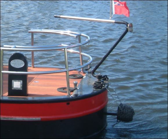

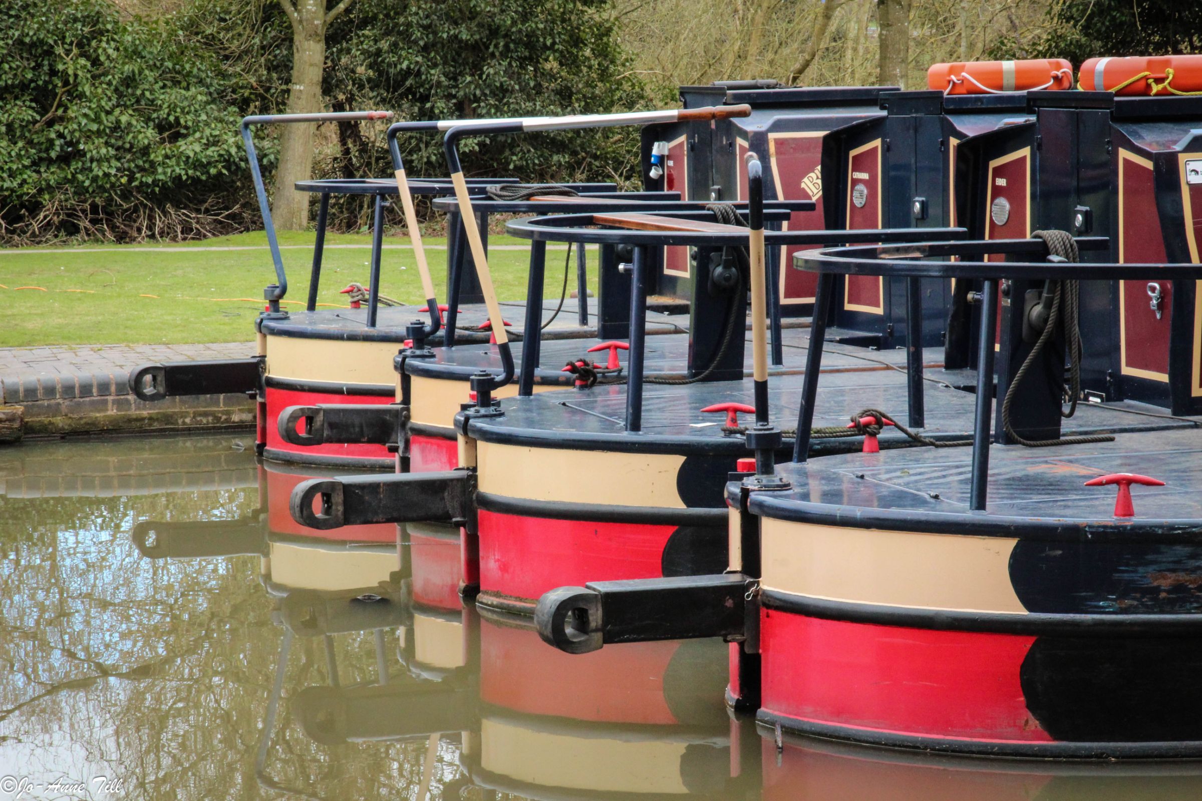

We need to renew our fenders and were considering replacing them with a metal fender as you often see on hired boats.
Any disadvantages/advantages ?

In both cases metal alone is not a good idea as they will not absorb any shock.
If bow and stern, rope fenders are there to both protect the boat and the infrastructure.
Also fenders need to be able to lift or have a weak link in the fixing to avoid getting hung up on lock gates.
Is this what you mean in the photo's?
