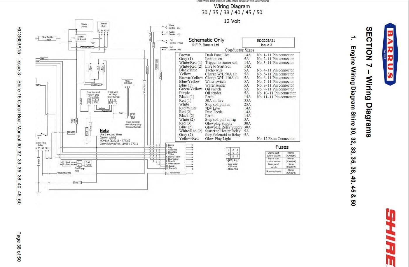

To be fair, I was just picking up on Tracy's post that there was no evidence of stop solenoid wiring on the control panel diagram so where does the stop solenoid get its power from? The complementary diagram that I posted clearly shows a stop solenoid so I was merely wondering whether it gets its power from another connection that is activated by the ignition switch e.g. the diagram shows a White(2) wire from the starter solenoid labelled "stop sol. pull in trig".
Does this diagram help re stop solenoid wiring? No need for any connection at the actual panel? When our Shire engine needed a new stop solenoid a few years ago, it had to come from Yanmar in Japan! Took a few weeks, hope the OP has better luck.
