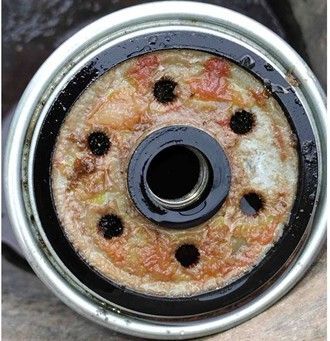

  8. So, from the answers so far, I conclude that: a) winter diesel is not sold canalside, b) it is not common to add something like STA-BIL Diesel Winter to the tank instead, c) waxing might be an issue if one's boat is laid up somewhere that experiences sub-zero temperatures. I'm asking because we've just replaced the filter in the attached photo, the boat having spent the winter in a marina in the Midlands.
  9. It's a bit late now, but is there such a thing as winter diesel for canal boats or an additive that effectively converts normal diesel into a winter version? I don't see anything in the RCR article about it, or indeed in this thread. Or is it not an issue for canal boats?
