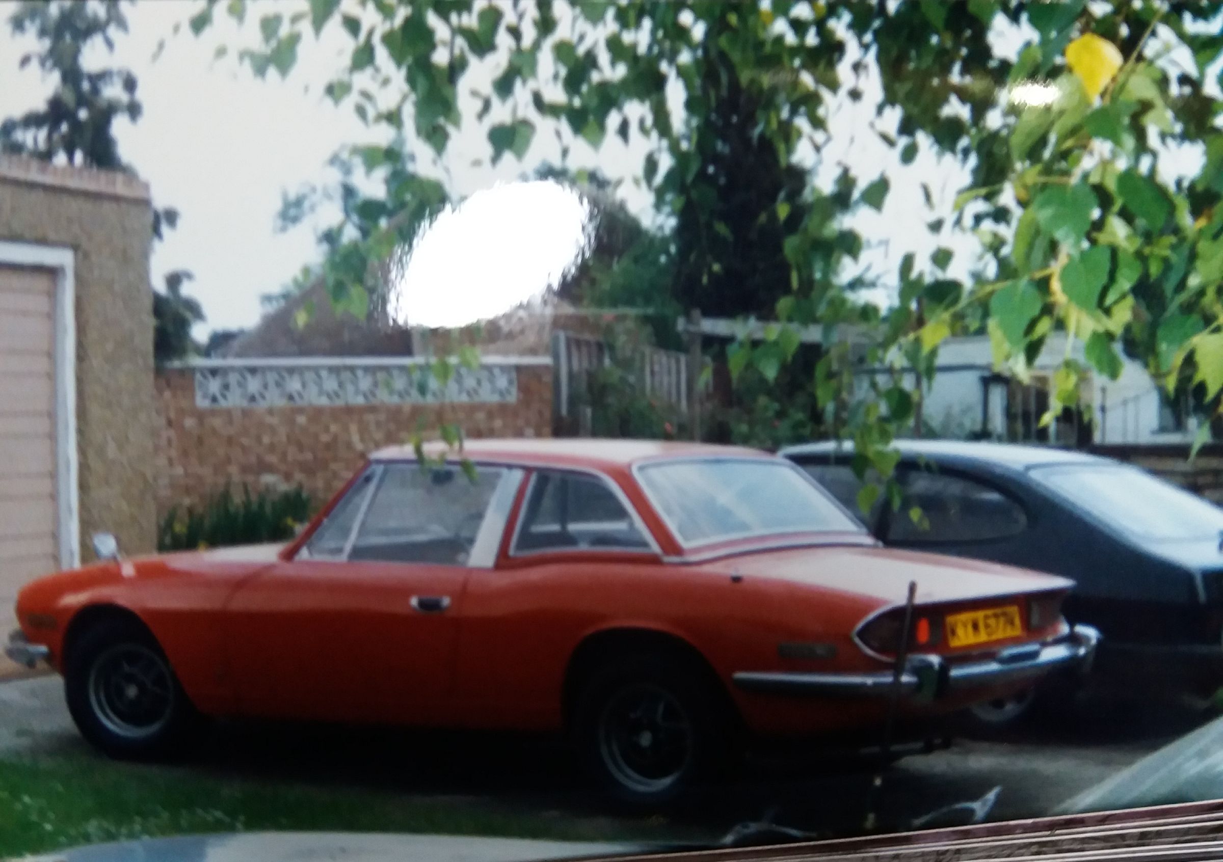

Definitely a good swap, the triumph was an untunable and underpowered lump! I was told that the Triumph V8 was basically two of their four pots grafted together, a product of desperation by their designers.
 I owned one briefly, still the only car i've ever run out of fuel in - twice!
9 hours ago, cuthound said:
The company that sponsored my rallying Mini used to earn most of their profits transplanting Rover V8 lumps into Triumph Stags!
This is the one i had.
