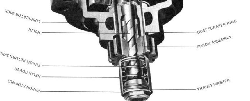

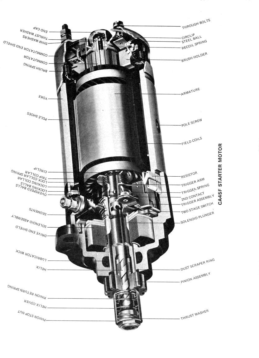

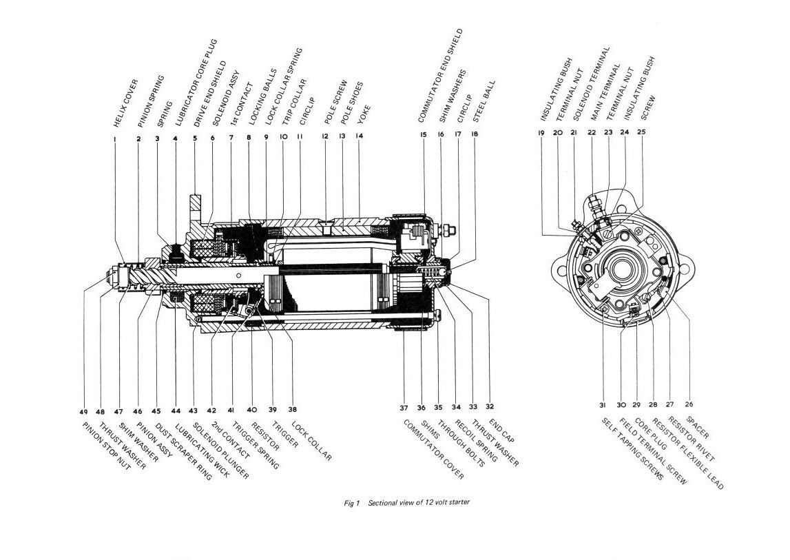

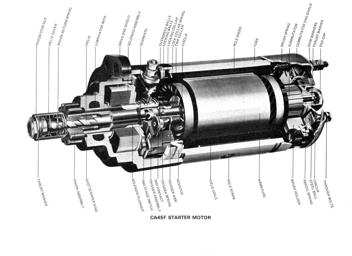

  3. I suspect everything may be working OK but the pinion is not engaging with the flywheel properly. The assembly in the image is an overrun device to throw the gear out of engagement should the operator continue to hold the start button in after starting or trying to operating the starter whilst the engine is running. This seems to indicate a lack of engagement due to , (a) damaged pinion teeth, (b) Starter too close to ring gear due to worn engine register hole. If you slacken the starter mounting bolts slightly can the motor be pushed or pulled a little towards or away from engine gear ring?
  4. "touches against the ring gear but does not engage fully and then just free runs at speed, clanging against the edge of the ring gear." Is it possible the second stage of the solenoid is operating too early?
  5. Sounds like something is stopping the pinion from running up the helical rod.
