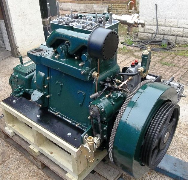

Of course the Lister green thing is a bit of a myth as you could have a variety of colours. Having stripped dozens of them to bare metal I know that, from new, they could be grey, olive drab, light blue, yellow, black and every shade in between. Only yesterday I picked up a 1952 JP2M that has been maroon from new. So paint it whatever colour you like. Red flywheel ? Not unless you want half the forum to hunt you down ?
