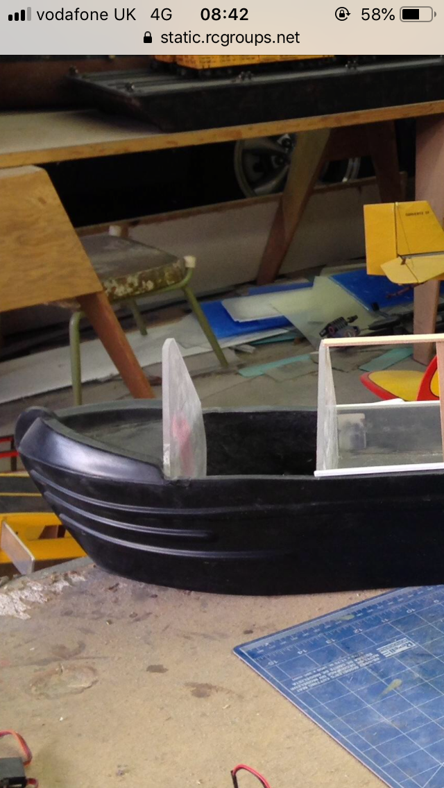

I’m looking to build a RC model traditional working boat on an Orion Mouldings Hull, however being abit of a perfectionist I’d like to model an actual boat...
Anyone know any historic boats which have a similar Hull and Bow to this? Kinda got the impression of a Woolwich by the general proportions of the bow but the deck isn’t right...

I'm sorry, but I don't think it bears much resemblance to any historic narrow boat hull I am aware of.
I don't know why they have chosen not to make it resemble any particular prototype, but in my view it doesn't.
If you want the end result to look like a known prototype, I think you need to look elsewhere, although it is quite probable you would need to build from scratch.
if you are a serious model maker, then building an authentic hull is easy peasy because the prototype was made from steel or iron sheets - easily replicated in sheet plywood or plastic.  Far more satisfying to do so than buying a crude model  hull shell that bears little resemblance to anything out there on the cut.
I would say that model bow has more resemblance to a Springer than any working boat.

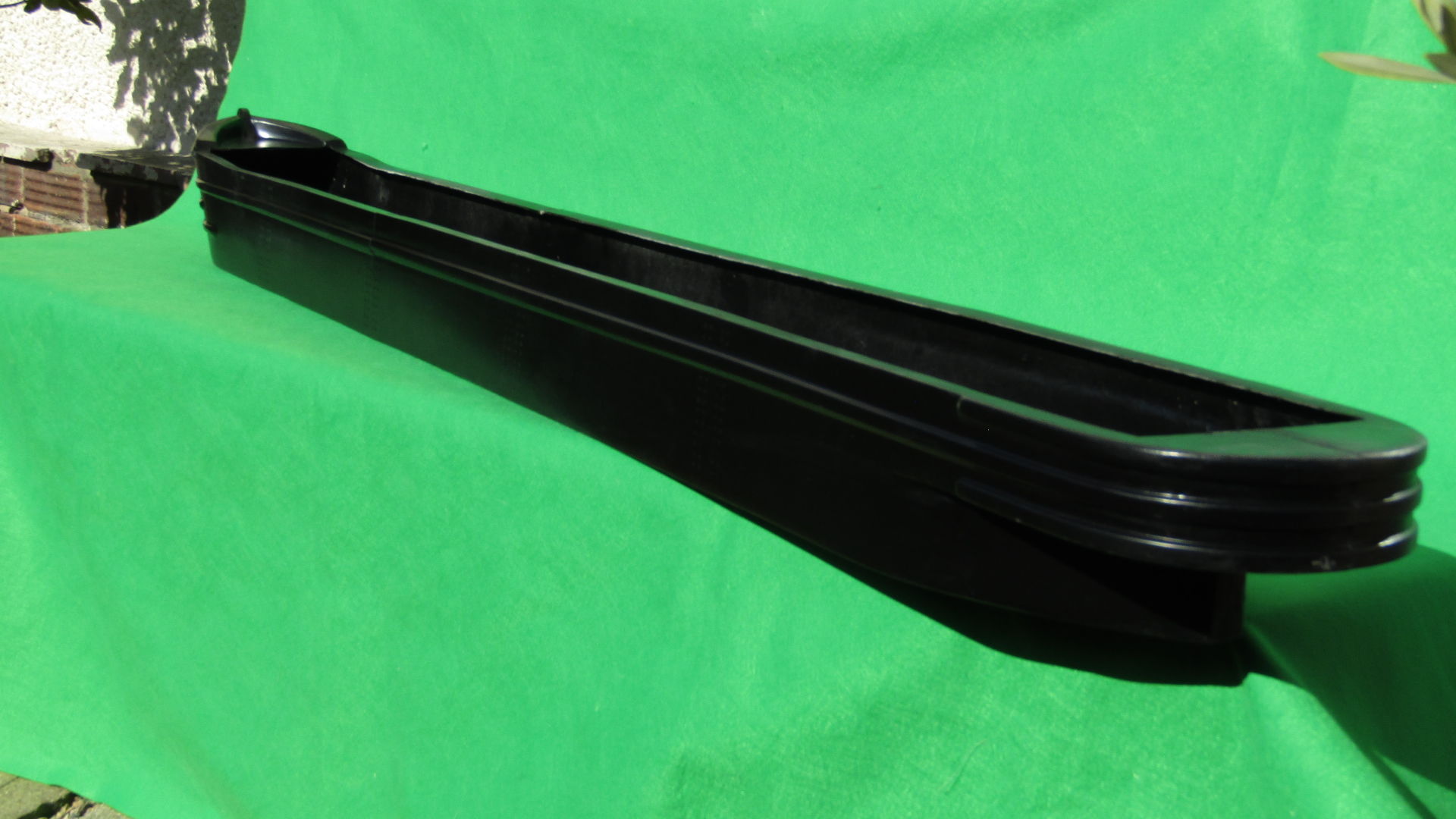

I cant think of the class/designation but i think the closest to your hull would be those of welded construction, they were named after trees - Oak and Ash were two of them, i'm sure someone will add more info.
The Severn and Canal Carrying Company's "Severners" built by Charles Hill in the mid-1930s?
Maybe a bit more similar at the front, if  you ignore the curious raised coaming, but certainly not at the back, as those boats have a fairly pointed counter, certainly not wide and round as in this model.
Apart from that the rivets are one of the better bits - it would be a shame to have to sand them off!
That's the one, it was more the lack of rivets and general bow profile that made it a reasonable option but as you point out there are rivets...

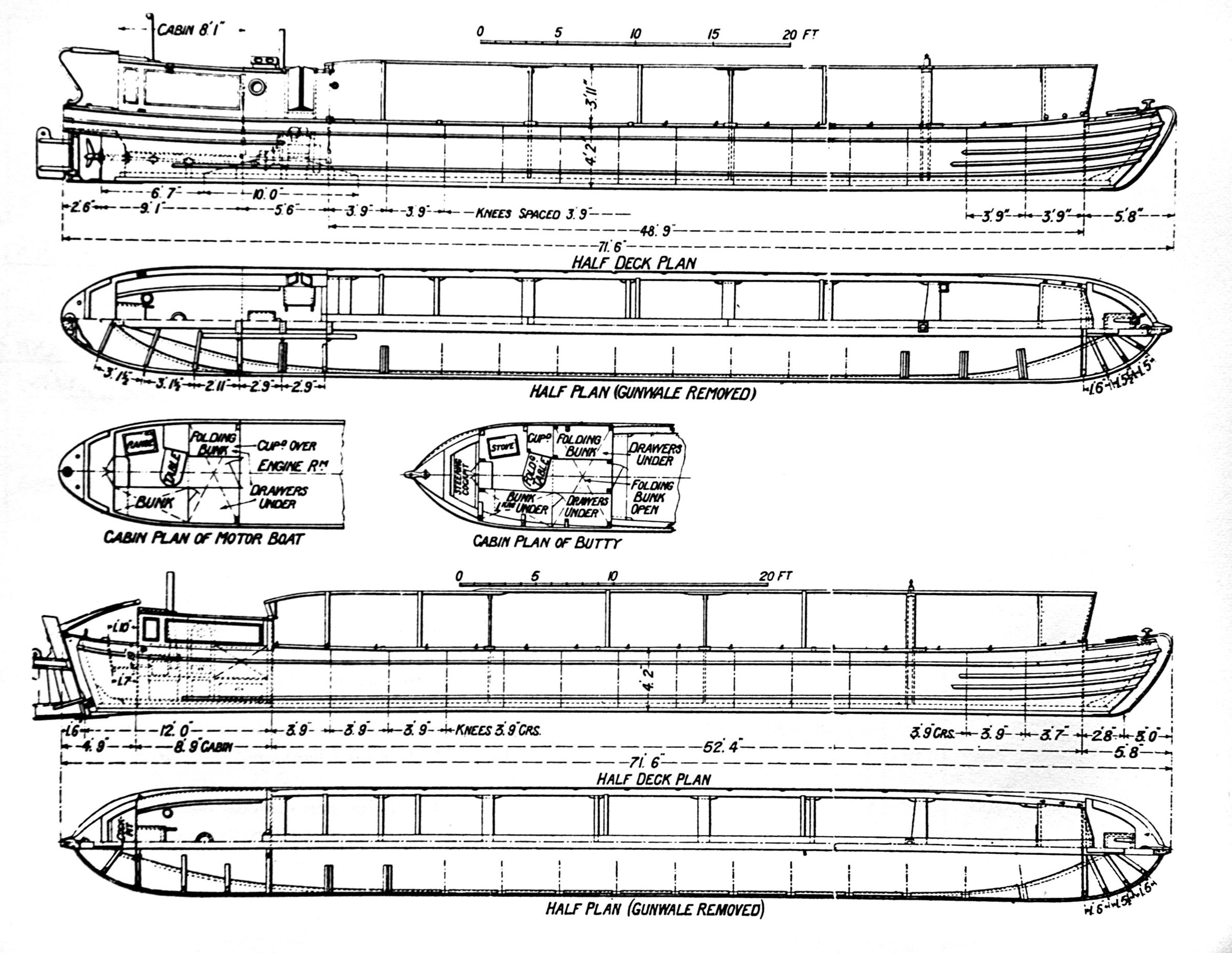

1 hour ago, Pluto said:
Any use?
Although often claimed to be otherwise, I have always assumed this to actually be the "Small Rickmansworth" variety of the "Stars".  So a wooden boat, not a steel one, I think.

Brilliant drawing Pluto, sorry I have to admit I’m abit of a newbie when it comes to narrowboats (predominantly modelled trucks and Railways until now)
is there much difference dimension wise between the wooden build Rickmansworth and the H&W ones?
Thanks, Tom
The differences are probably in a couple of inches here and there, but they can make some difference to the shape, and where you can go with a full-sized boat. However, for a small model the differences become much more difficult to see, though someone is bound to tell you differently! It would certainly be worthwhile having a look at several examples as then you should begin to understand the nuances in shape which are so important to some - that can include me on occasion.
