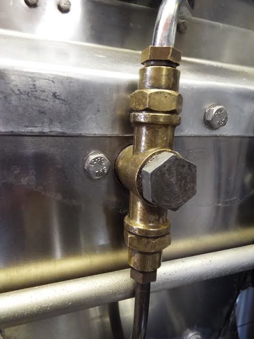

Some of you may know I've been rebuilding a 1937 Armstrong Siddeley Siddeley Special car. It's back on the road now but I've not been able to find an inline double banjo union for the central chassis lubrication system. I think the threads are BSP P. I know it's not a boat but a few of you have good engineering contacts. Has anyone any idea where I might find one of these? I've been trawling autojumbles for the last four years with no success.

It shouldn't be beyond the wit of man to get one made from a lump of brass. Much of it could be turned on a lathe, with hand fettling with files around the junction of the two cylindrical parts. Or if just functional will do, then its just a matter of drilling and tapping a rectangular lump.

Have you spoken to @RLWP, he may be able to point you in a direction of fettle an existing one
Not sure what size you need but there is this:-
http://www.legris.com/Legris_ecom/RechercherReferencesTypeArticle.do?codeActivite=BP&codeGroupe=01&codeFamille=01&codeSousFamille=01&codeTypeArticle=0119&codeFiliale=uk&codeLangue=en_GB
Or this from AMAL
http://amalcarb.co.uk/double-banjo-180-degrees-1-4-bsp-threaded-pre-monobloc.html
Or if you can accept a different "look" you could use two banjo fittings on a longer bolt, these seem to be available from multiple sources.

Thanks, I'll follow up the leads. I had a price to get one made but it was going to be a few hundred quid. The annoying thing is, when dad bought the car it was on it. but in the past 23 years it's gone missing and with him no longer being around to ask, it's been like looking for a needle in a haystack. I've found most of the missing bits and know from previous experience that as soon as I spent a few hundred replacing it, it'll turn up within a week. This has already happened a few times.

Surely once the connector becomes double ended it has lost the crucial attribute that makes it a Banjo?

Maybe that's why I'm struggling to locate one. Using the wrong name... parallel brass hydraulic union perhaps?

I was only joking, I expect that a connector that seals on its face and rotates about a central bolt is the defining thing, and any musical instrument likeness is now just history.   I feel a google coming on.......
