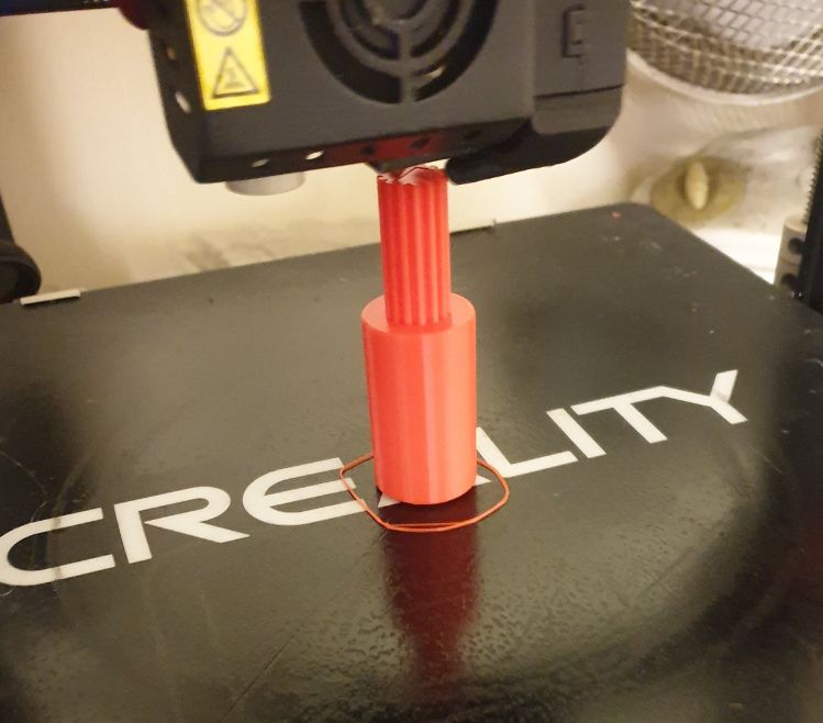

After looking at lots of reviews online I bought a Creality CR10S Pro. It has its issues though. Setup is not as straightforward as they make out, getting the Y axis parallel to the hotbed was extremely difficult. Extremal temperature affects sensors, so does hotbed and nozzle temperature, so it can take a lot of time to setup between prints, this might be more because of where my printer is located in a garage, which gets pretty cold. It took a lot of faffing to figure this out and necessitated replacing the hotbed when it got gouged by the nozzle. I now set the bed and nozzle temperature up and let it settle for 10 minutes before starting a print. Given the above I'm not sure I'd recommend it. It's the only printer I've used so can't recommend anything else. Once the issues are understood and it's setup right, the print quality seems pretty good.

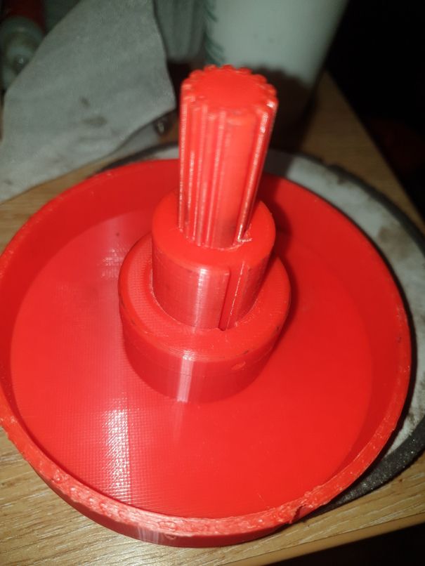

Tony, I took on board your comments yesterday and can assure you that it fits over the studs and the notch is within about 2mm of the pointer. Rob
Thanks. No it's not hollow on this version but I'll give that a go. The first trial was a bit of a tight fit and actually broke when I tried removing it from the drive gear, so was thinking of putting a cap head bolt down the centre. Freecad. No prior experience but have been watching lots of tutorials and although half the time I don't understand the terminology, I've so far managed to make a few parts for my pre war Armstrong Siddeley car and now this.
Still a work in progress but I have now got a usable printed timing tool for the 1500. To make it involved learning how to use CAD software which was an interesting lockdown distraction. It took about 9 hours to print in total, I'm sure the printer settings can be tweaked a bit to reduce that, perhaps that'll be the next lockdown project.
That's excellent Rob! What did you use to establish the proper angle between the master spline and the timing notch that you have on the outer disc? I see in the manual some mention of 208 deg but really not sure what that means. 208 degrees from the master spline? I was lucky enough to borrow a genuine universal timing tool once. The zero degree mark is in the centre of the master spline. So, yes its 208 degrees from the centre of the master spline.
Thank you, I did wonder but when I compared these figures to NA petrol engines that I have compression ratio and pressure data for they correlated, so there's some extra info needed for diesel engines? There is a master spline and reference marks so it shouldn't be possible to get the timing in the wrong position. The outer is still a work in progress but thank you for pointing that out. I'll make the changes for the next iteration which I'm working on now. Your comment has made me notice the outer wall is also too thick, so needs a few more tweaks. I'm almost fifty but every day is a school day. Your patience is appreciated. Rob
