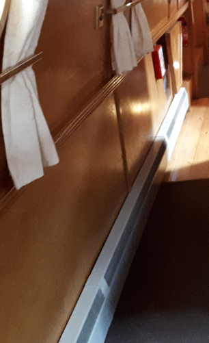

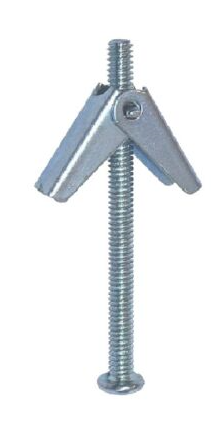

robtheplod Posted September 22, 2019 Report Posted September 22, 2019 (edited) Hi All, working through basics in the boat and we now have a TV. I'd like to mount it just under the gunwales in the cabin, but the wall is the oak ply type, so not too strong. Not sure how I can find where the battens are behind? Anyway, the TV we have is a very light (2.6kg) 24" so thinking this might not be too much of an issue and so looked around for mountings - came across the screw mount below and wondered if anyone has any success with these or has any other recommendations? Edited September 22, 2019 by robtheplod
steve hayes Posted September 22, 2019 Report Posted September 22, 2019 Problem with these sorts of swing arm mounts is they are expected to be fitted to a masonry wall, not even easy in a modern house. What I’ve done with ours is fit it to a reasonable sized bit of plywood and the fit that to the cabin side with many screws spread over a larger area 1
WotEver Posted September 22, 2019 Report Posted September 22, 2019 Spreading the load as Steve suggests is the best way. If you did want to use single point mounting screws don’t use toggles, they’re the spawn of the devil. Use something like Rawlplug Hollow Wall Anchors instead. 1

cuthound Posted September 22, 2019 Report Posted September 22, 2019 (edited) 1 hour ago, WotEver said: Spreading the load as Steve suggests is the best way. If you did want to use single point mounting screws don’t use toggles, they’re the spawn of the devil. Use something like Rawlplug Hollow Wall Anchors instead. Indeed, the problem with the toggles is the sprung loaded toggle falls off if the scews are ever removed. Edited September 22, 2019 by cuthound To remove a letter masquerading as a space
stegra Posted September 22, 2019 Report Posted September 22, 2019 Those spring toggles are intended for hollow walls. I find they work very well in lath and plaster walls where nothing else is suitable. Also good in plasterboard for heavy loads. I think they would be fine for your application if the plywood is at least 9mm; 6mm ply would probably sag when the arm of the mount was extended. Tis true what Cuthound says, the toggle will fall off if the screw is removed but they're cheap to replace anyway.

Sea Dog Posted September 22, 2019 Report Posted September 22, 2019 Rob, have you ascertained how thick your ply is? My vesa mount for a heavier telly than yours is screwed directly to the ply, no fancy fixings, and is rock solid. I'm guessing mines 12mm.

robtheplod Posted September 22, 2019 Author Report Posted September 22, 2019 1 hour ago, Sea Dog said: Rob, have you ascertained how thick your ply is? My vesa mount for a heavier telly than yours is screwed directly to the ply, no fancy fixings, and is rock solid. I'm guessing mines 12mm. no, not easy to see.... will take on board all suggestions, thanks so much for replying!
Richard10002 Posted September 22, 2019 Report Posted September 22, 2019 (edited) 2 hours ago, Sea Dog said: Rob, have you ascertained how thick your ply is? My vesa mount for a heavier telly than yours is screwed directly to the ply, no fancy fixings, and is rock solid. I'm guessing mines 12mm. Like you, I have a 24” tv on a vesa mount directly to the ply wall in the lounge. I don’t think the ply is particularly thick, but the mount is solid as a rock. The tv wobbles If waggled, but the ply doesn’t move even slightly. I also have a 22” tv on a vesa mount in the bedroom, and this is screwed into 10mm ply, so definitely solid as a rock. For the OP, you can often find vertical supports by tapping. The bit whetevthe support is will sound different. Checking at various levels on the vertical will confirm you are in the right spot. Edited September 22, 2019 by Richard10002

dor Posted September 22, 2019 Report Posted September 22, 2019 (edited) My 24" (or is it 26" - can't remember) TV on a vesa mount is fitted in similar manner to richard1002 above. A piece of 9mm ply about 150mm x 250mm is screwed to the 6mm ply cabin side with six screws. Swivel mount then fixed to that with two screws. Been like it a couple of years with no problems. TV is now mounted higher than shown and fixed to the cabin side, so it will stow almost parallel to the cabin side, but swing out to a better viewing position. Edited September 23, 2019 by dor
