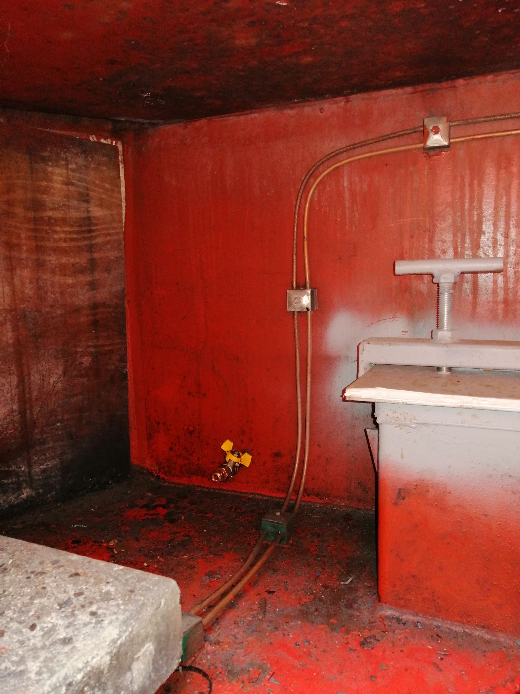

TGweeder Posted April 25, 2019 Report Posted April 25, 2019 Hi everyone Two questions today ? The weed hatch on my boat doesn't have a access cover, l am obviously intending on putting one in but wondered if I would be as well to just extended the hatch up to floor level. If doing so would I need to fit a baffle plate lower down (if that makes sense) And then just seal the top. Doing it this way would save me a lot of work, but is it workable with such a long drop to the prop. Second.. I the image you can see a tap (bottom left) it used to supply a diesel stove. I was wondering if I could convert it into a fuel level sight guage. Would this cause problems for the BSS or anything thing. Thanks again looking forward to your input ?

BEngo Posted April 25, 2019 Report Posted April 25, 2019 Yes the baffle plate still nedds to be a counter level. You will need very long arms to reach down from the deck above- remember that you may need to get at something wedged at the lower edge of the prop. The spare tap could makre a sight glass, but BSS generally does not like them and has a heap of special requirements. The bottom tap needs to spring close for example and you would need a top fitting, not just an open pipe. Read the BSS guide for all the gory details. N

NB Esk Posted April 25, 2019 Report Posted April 25, 2019 Surely the yellow tap was designed as a tank drain. Fuel being drawn off to supply something should be taken from the highest point of the tank, via a dip tube.

David Mack Posted April 25, 2019 Report Posted April 25, 2019 13 minutes ago, NB Esk said: Surely the yellow tap was designed as a tank drain. And if that is a simple tap and an open ended pipe it is a BSS fail. Pretty sure the BSS requires the tank drain (if fitted) to be only openable using tools.
NB Esk Posted April 25, 2019 Report Posted April 25, 2019 Just now, David Mack said: And if that is a simple tap and an open ended pipe it is a BSS fail. Pretty sure the BSS requires the tank drain (if fitted) to be only openable using tools. No, it can be a normal tap but the only thing screwed into it should be a blanking plug. If the tap in the photo was accidentally knocked, the fuel would be in the bilge (to the op)
Chewbacka Posted April 25, 2019 Report Posted April 25, 2019 1 hour ago, David Mack said: And if that is a simple tap and an open ended pipe it is a BSS fail. Pretty sure the BSS requires the tank drain (if fitted) to be only openable using tools. 1 hour ago, NB Esk said: No, it can be a normal tap but the only thing screwed into it should be a blanking plug. If the tap in the photo was accidentally knocked, the fuel would be in the bilge (to the op) You are both correct in that the final seal to the ‘system’ in this case ‘a bit of pipe and ball valve’ must be sealed with an effective seal requiring tools to remove. So a screw in blanking plug is common (after the tap).

TGweeder Posted April 25, 2019 Author Report Posted April 25, 2019 (edited) Sorry for not replying sooner everyone and thank you for your feedback. Sorry I might not have explained very clearly. Yes #Dave Schweitzer exactly it's a pain and close to impossible to get to the prop as it is. 7 hours ago, Chewbacka said: 8 hours ago, David Mack said: And if that is a simple tap and an open ended pipe it is a BSS fail. Pretty sure the BSS requires the tank drain (if fitted) to be only openable using tools. 8 hours ago, NB Esk said: No, it can be a normal tap but the only thing screwed into it should be a blanking plug. If the tap in the photo was accidentally knocked, the fuel would be in the bilge (to the op) You are both correct in that the final seal to the ‘system’ in this case ‘a bit of pipe and ball valve’ must be sealed with an effective seal requiring tools to remove. So a screw in blanking plug is common (after the tap). The tap used to have a brass supply pipe into the cabin to a diesel stove. The pipe had been left in and just folded over at the end halfway into the boat, I have currently drained the tank and removed the pipe. If it's problematic to fit a sight guage I will just blank it off. 9 hours ago, mark99 said: It looks like the access cover is just plywood or similar. It's white sealer not my doing... there is no rubber seal at present. Thanks everyone I will stick with putting in a access panel with gutters and drains was just wondering ?. For your interest the following images are what I have been doing today ? Edited April 25, 2019 by Tim Gilbert

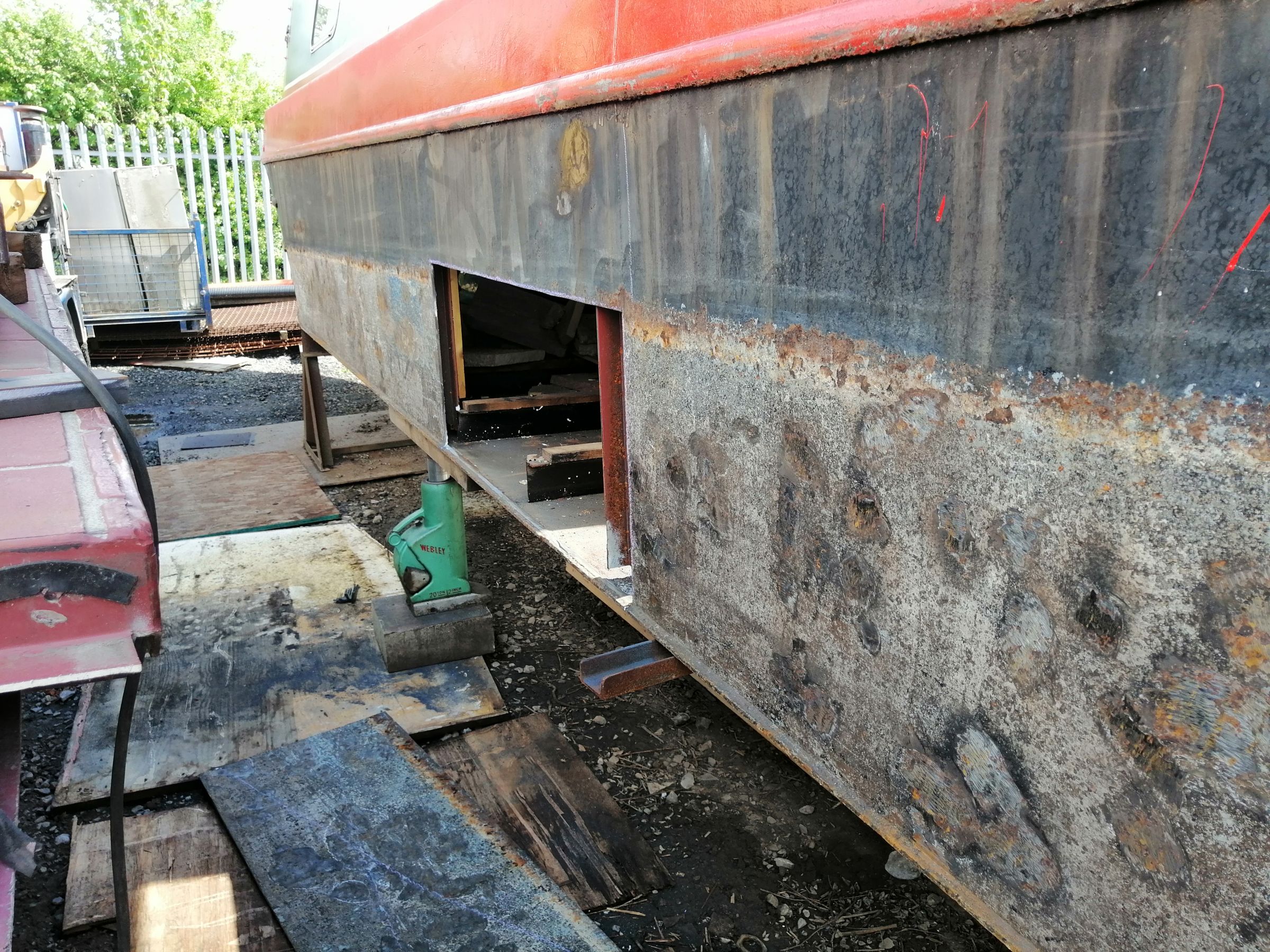

TGweeder Posted April 25, 2019 Author Report Posted April 25, 2019 1 minute ago, matty40s said: You are bricking up the interior?? ? No that's a imitation brick shed flat packed. For sale if anyone is interested ?

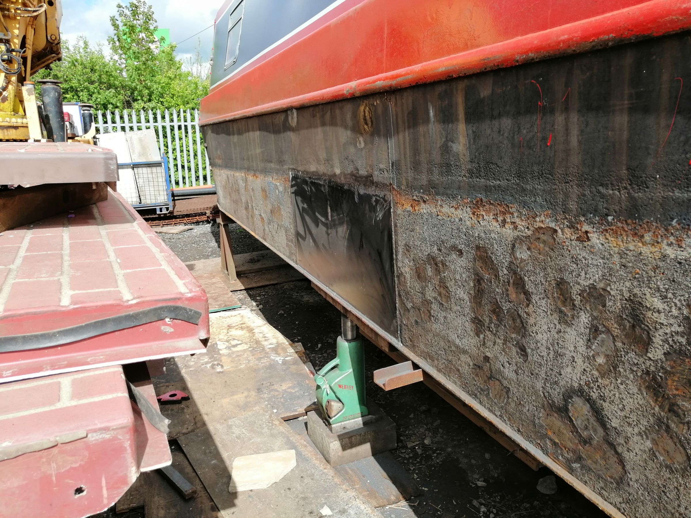

TGweeder Posted April 25, 2019 Author Report Posted April 25, 2019 Just now, mark99 said: That hull looks very corroded. It's more me being picky I am going to Zinga it so just gone over it over the top I expect. The plated section was just a large area of pitting so chopped it out. Couple of 2mm pits around but most was at 1mm. 6mm sides. It's in our yard easier to do it now than later ? 1 1
NB Esk Posted April 25, 2019 Report Posted April 25, 2019 50 minutes ago, Tim Gilbert said: It's more me being picky I am going to Zinga it so just gone over it over the top I expect. The plated section was just a large area of pitting so chopped it out. Couple of 2mm pits around but most was at 1mm. 6mm sides. It's in our yard easier to do it now than later ? Good man, I like someone who's not afraid to get stuck in, look to be doing a good job, is that your welding?
