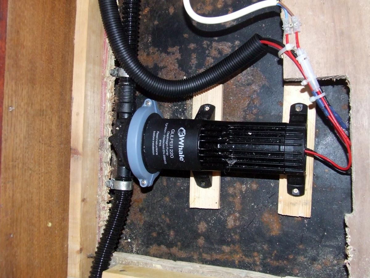

My newly installed Gulper is on the bottom plate of the boat held down by magnets. I leave the boat unheated for a few weeks at this time of year. Is there a need to tip some kind of antifreeze down the bath plughole in severe frosty weather to stop the dregs from freezing in the pump? If so what should I use?

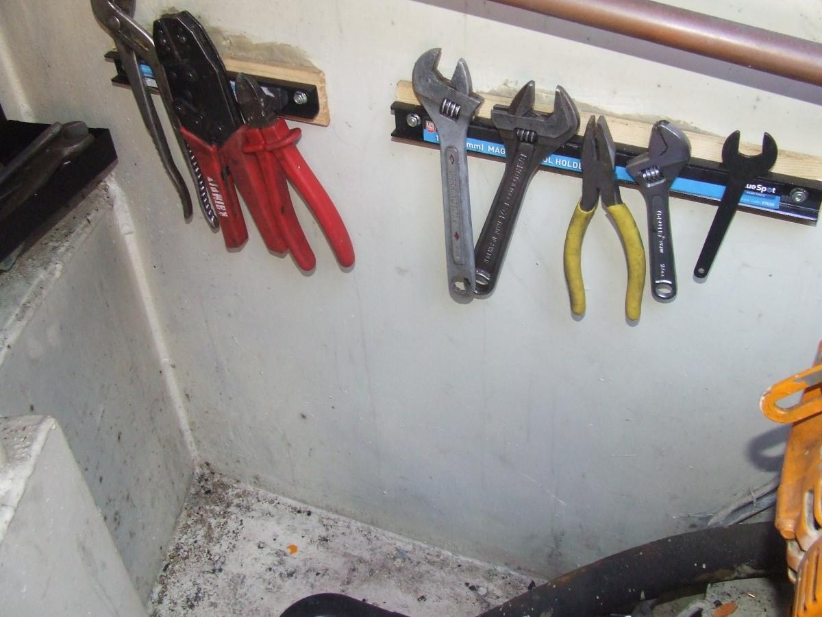

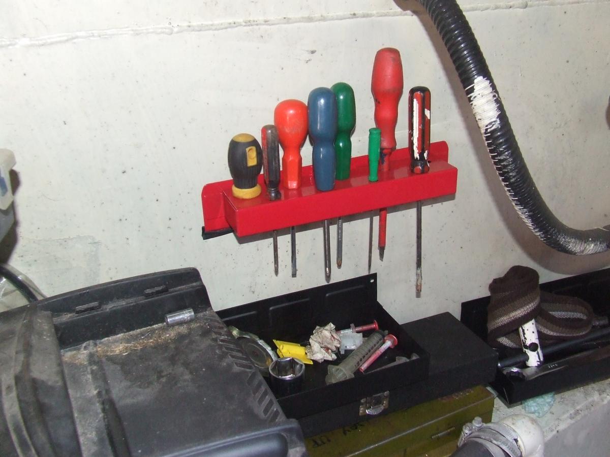

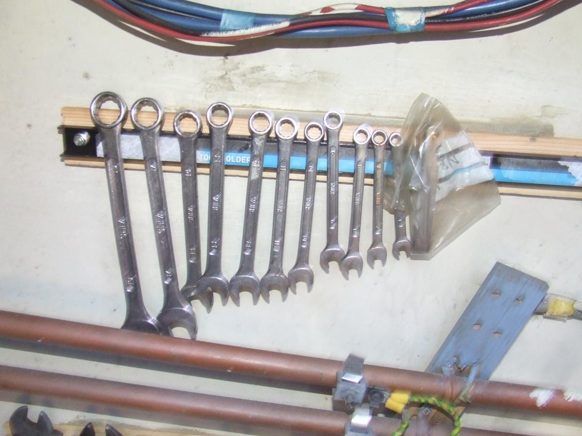

I find myself using magnets more and more for fixing stuff to the steel shell. So cheap and powerful now. All tools/storage boxes etc now hung in engine hole with magents. One day my boat will stick to a steel piled embankment and refuse to move wink.png
Edited by Guest
Where do you get your magnets from?
Mostly Ebay. The trays and screwdriver holders are intended for going on the side of mechanics metal boxes. Machine Mart have them too. Loose magnets are two a penny on Ebay now, available with holes in etc.
But for mounting a pump I'd have thought you'd want it "floating" on its rubber mounts to reduce vibration and noise rather than having a pump mounted with any metal to metal interfaces?
Sorry Mike, I should have been more specific. I used timber to mount the feet to, then in turn the timber fixes to the shell with magnets (magnets Araldited to timber in this case.) Seems OK to date, just fits nicely where the old sump thing used to be. Before anybody shouts at me, the choc blocks will be replaced with crimps, and the wood needs tidying up somewhat! It's on my "to do" list wink.png
Edited by Guest
Its a single diaphragm pump is it not? I agree that it is unlikely to freeze down there but even if it did as long as it was not operated frozen I think all would happen is that the expanding ice/water would flex the diaphragm a bit and push it out of the way. I can't see the diaphragm splitting.
