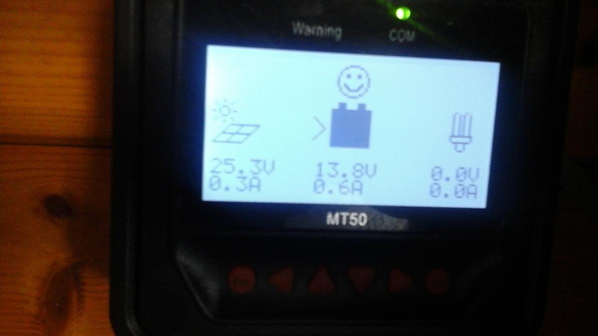

Rickent Posted August 29, 2016 Report Posted August 29, 2016 (edited) This is what 175w of solar does to your batteries on a nice sunny day. Edited to add , plus mppt controller. Edited August 29, 2016 by Rickent
