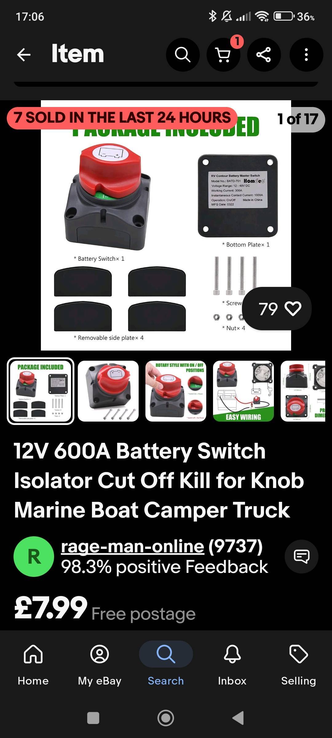

I just bought one of these cheap generic battery isolators from eBay which is a copy of the BEP mini isolator and I have to say the quality looks just as good as the genuine BEP isolator cluster I fitted to my batteries about 10 years ago. But is it a mistake to judge the quality just by looking at it?

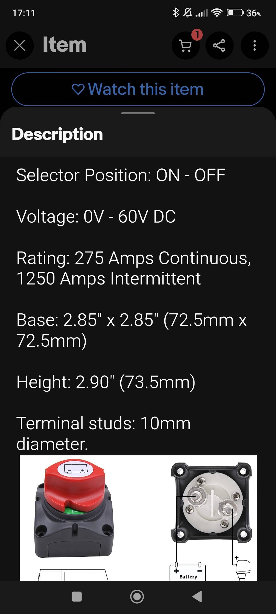

The continuous rating is 275A rather than the stated 600A. I'm not sure where that comes from? Maybe they list it as 600A as that's approx halfway between the continuous and intermittent ratings?
Edited by blackrose
So it says 600A on the headline, 300A "working current" on the sticker under the switch, 275A "continuous rating" in the text.
Any or none of these might have the same rating as for the BEP isolator, there's no way of knowing, There's a lot of cheap copycat Chinese junk on the market, no doubt some is cheap and OK and some is cheap and nasty/counterfeit, the issue is how to tell which it is... 😞

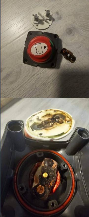

Here's an example for the exact BEP switch you mention, and a melted cheap copy which looks just like the one you posted:
https://marinehowto.com/counterfeit-electrical-components-just-say-no/
Edited by IanD
Thanks, I notice they keep talking about "fake" electrical items. However unless an item actually falsely states it's made by a particular manufacturer it's a copy rather than a fake.
I wonder what the stats are on numbers of melted generic switches compared to branded?
I don't know, presumably the cheap copies fail more due to corner-cutting in construction/materials. With no name or reputation to worry about, why spend more building it than you absolutely have to?
However for high-current circuits, given what can go wrong I'd always prefer to go with a reputable supplier/manufacturer not a generic one off eBay -- saving a few quid doesn't seem worth the risk.
Others may think that price matters more, and it'll probably be fine.
P.S. The pukka BEP one is about £60 compared to £8 for the copy -- I leave it to you to speculate why... 😉

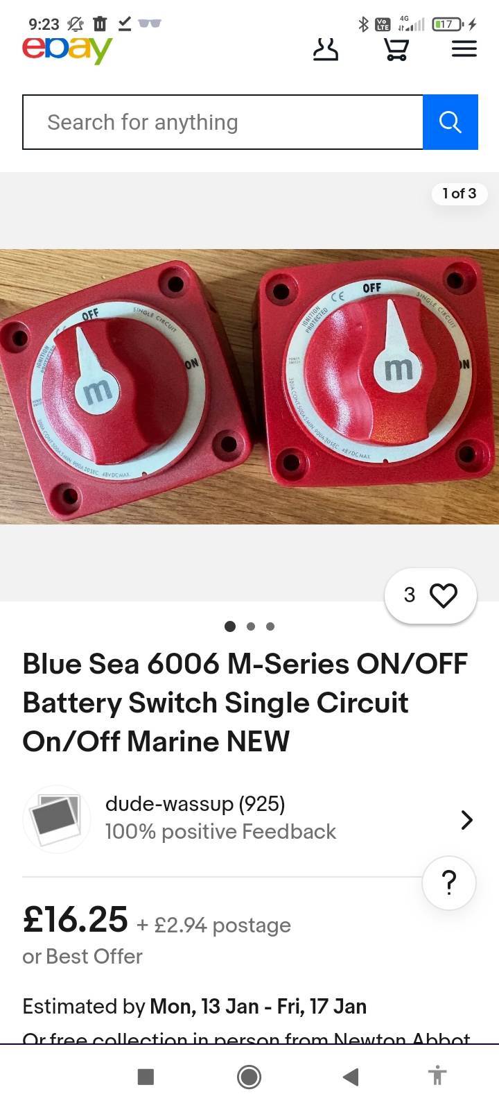

I'm going to be getting a battery switch for one of the launches.
I came across that one but it just looks wrong to me. Its not the price its just that the actual article to me looks tinny and puts me off.
I prefer this one as it looks better. Might still be crap inside to be fair. I think it is a copy not a real Blue Sea as they are more expensive.
