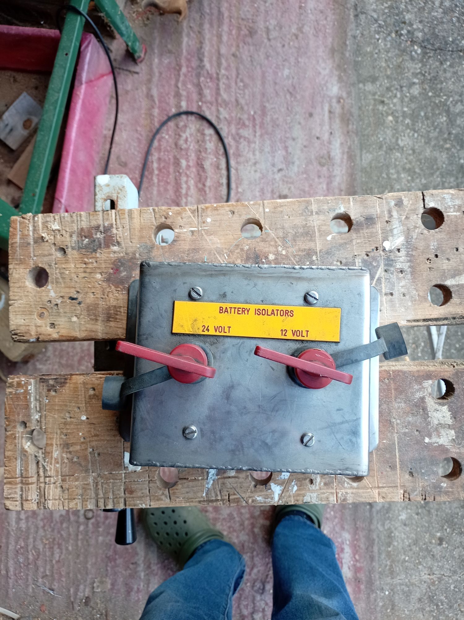

I'm going to be getting a battery switch for one of the launches.
I came across that one but it just looks wrong to me. Its not the price its just that the actual article to me looks tinny and puts me off.
I prefer this one as it looks better. Might still be crap inside to be fair. I think it is a copy not a real Blue Sea as they are more expensive.

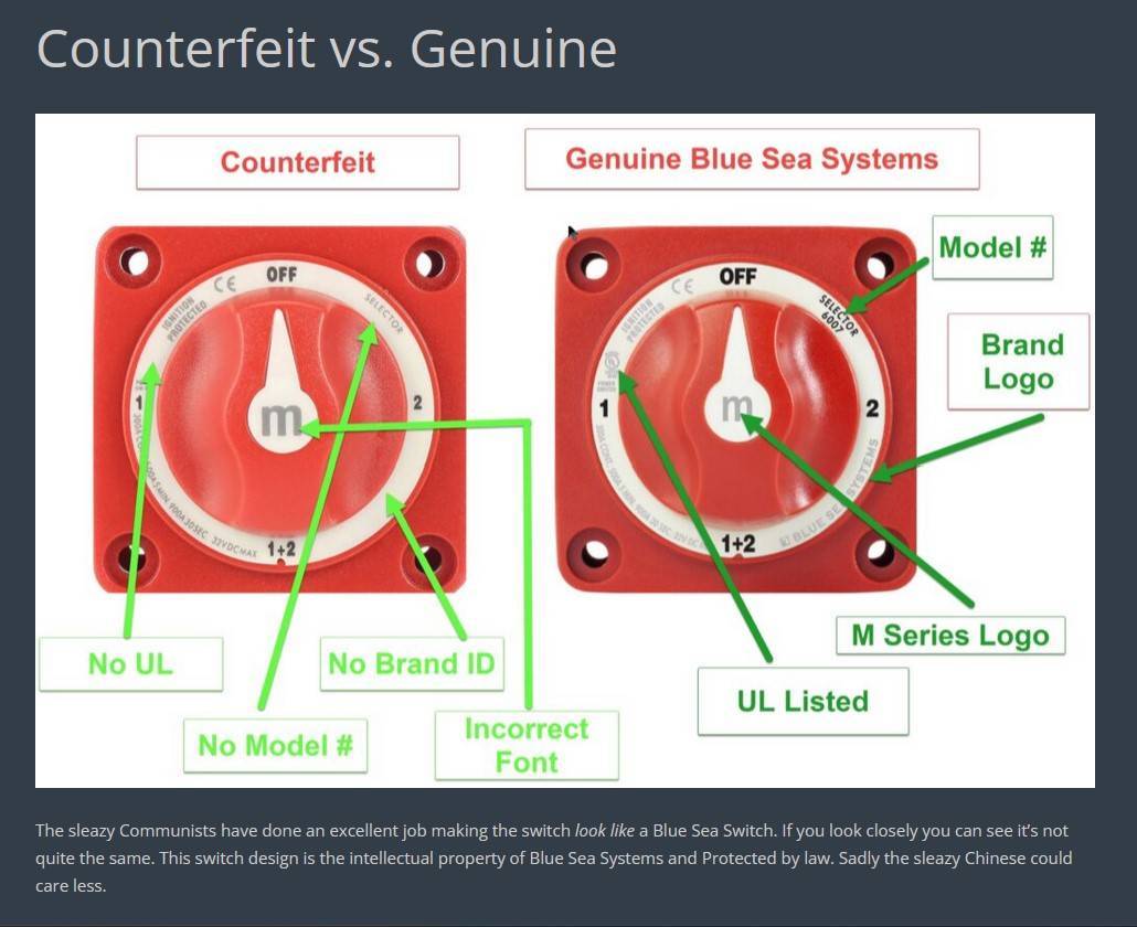

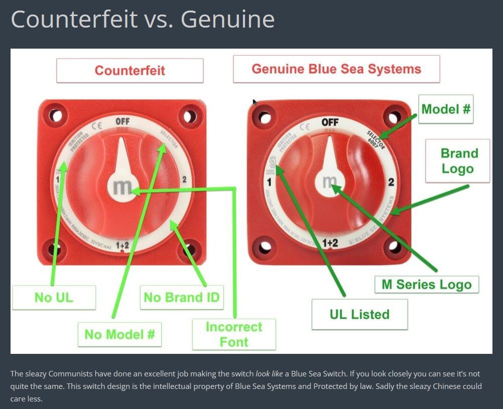

Blue Sea are a reputable brand -- assuming that's the genuine article and not a cheap Chinese copy. Which it is, see here...
https://marinehowto.com/counterfeit-electrical-components-just-say-no/

I agree, but that doesn't change the fact that there's a lot of solid information on there which is difficult to find elsewhere. You don't have to take any notice of the comments, and other people can decide for themselves whether to be offended by them... 😉

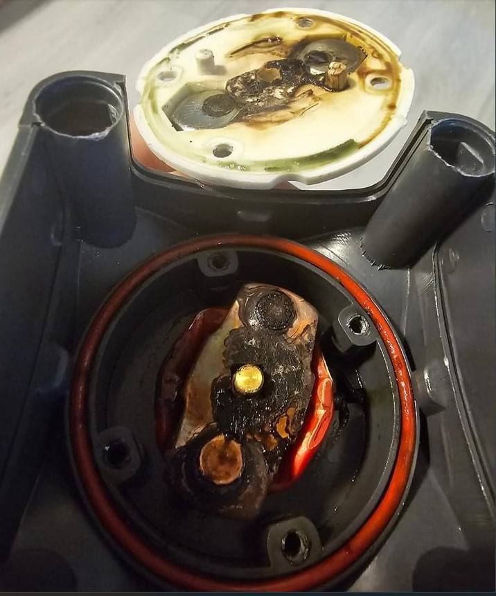

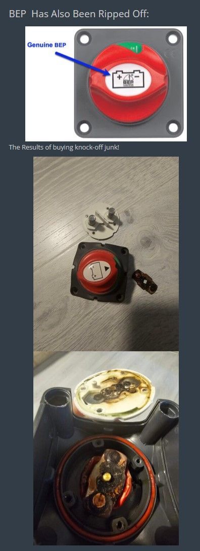

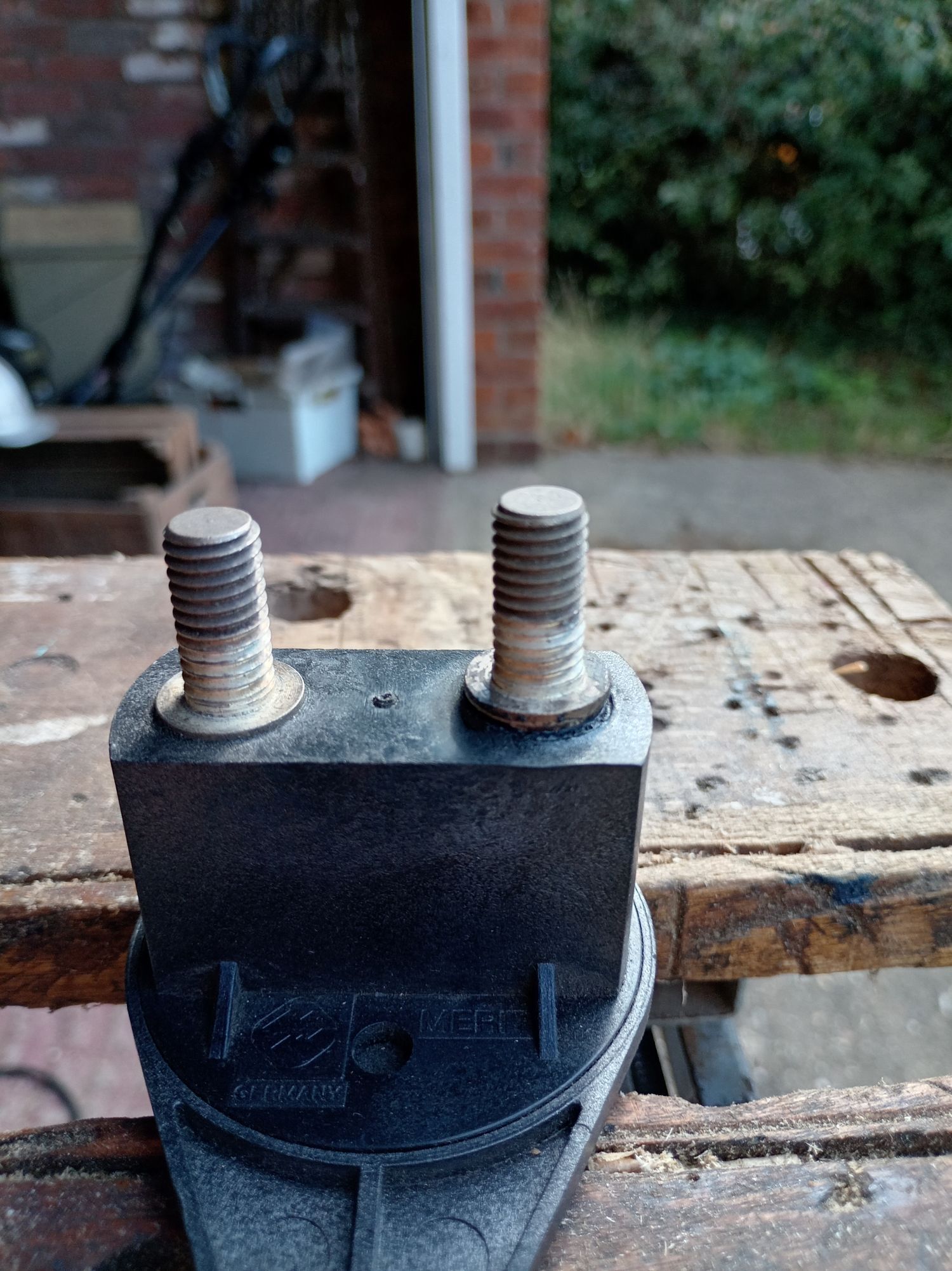

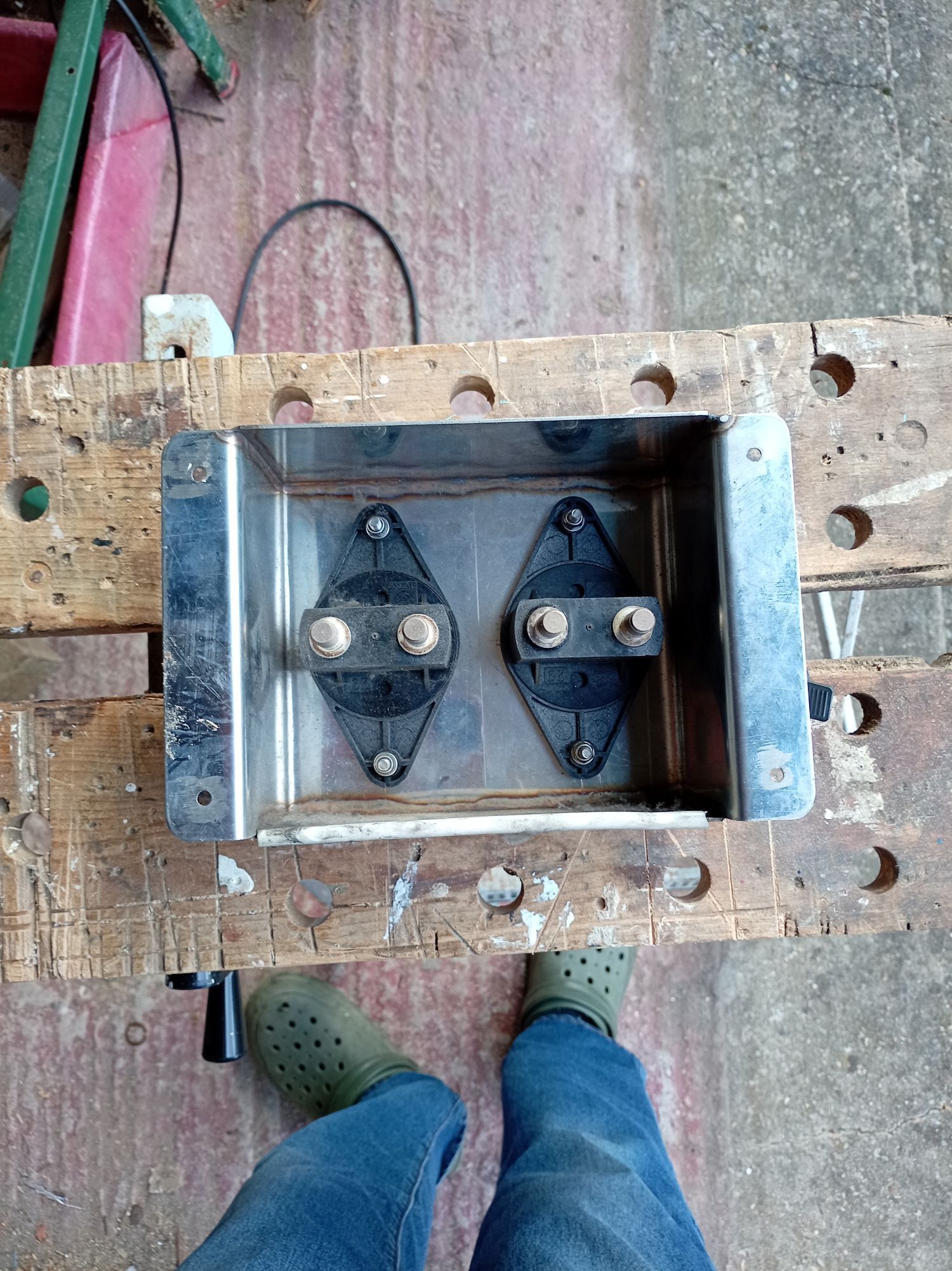

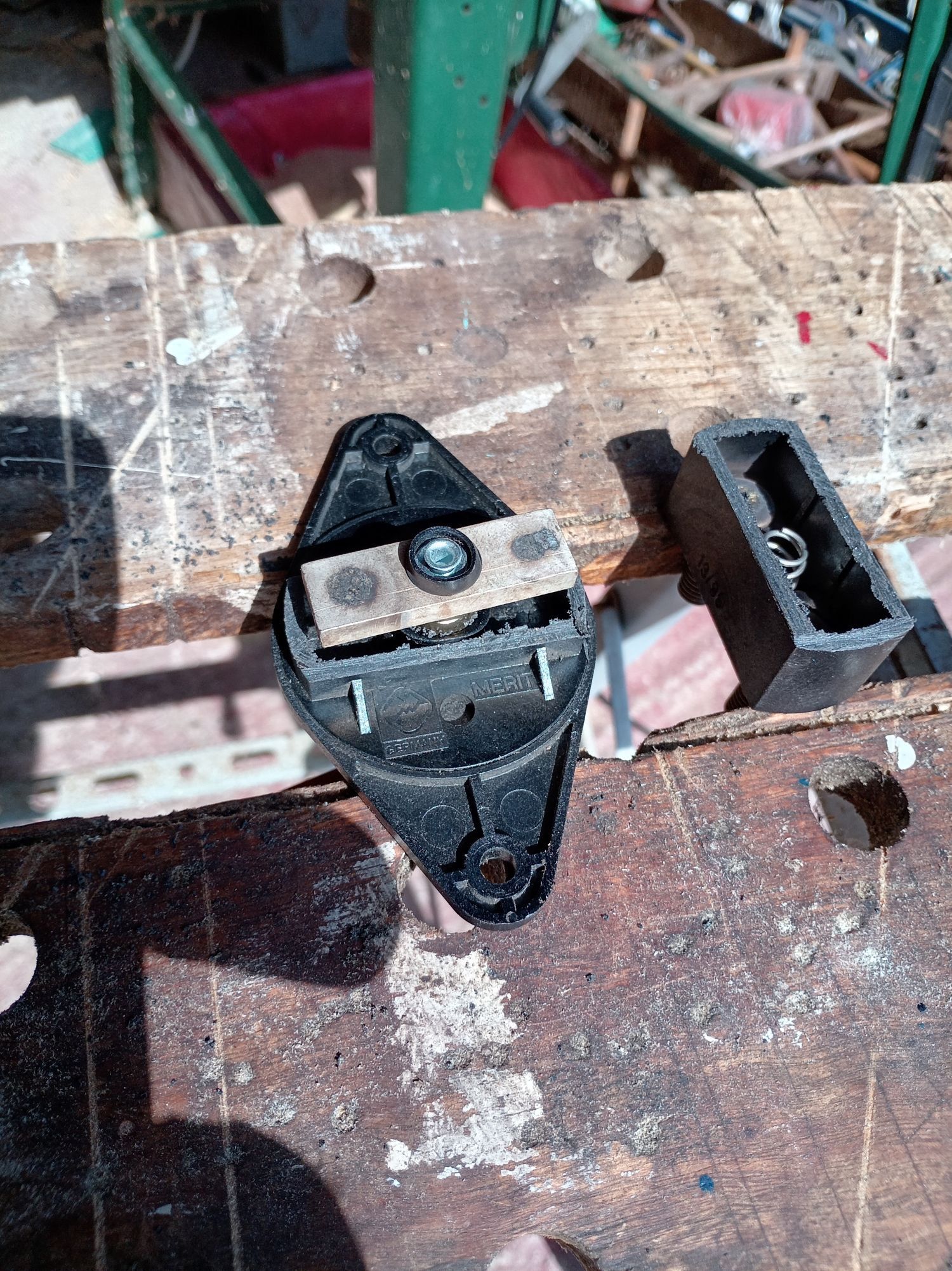

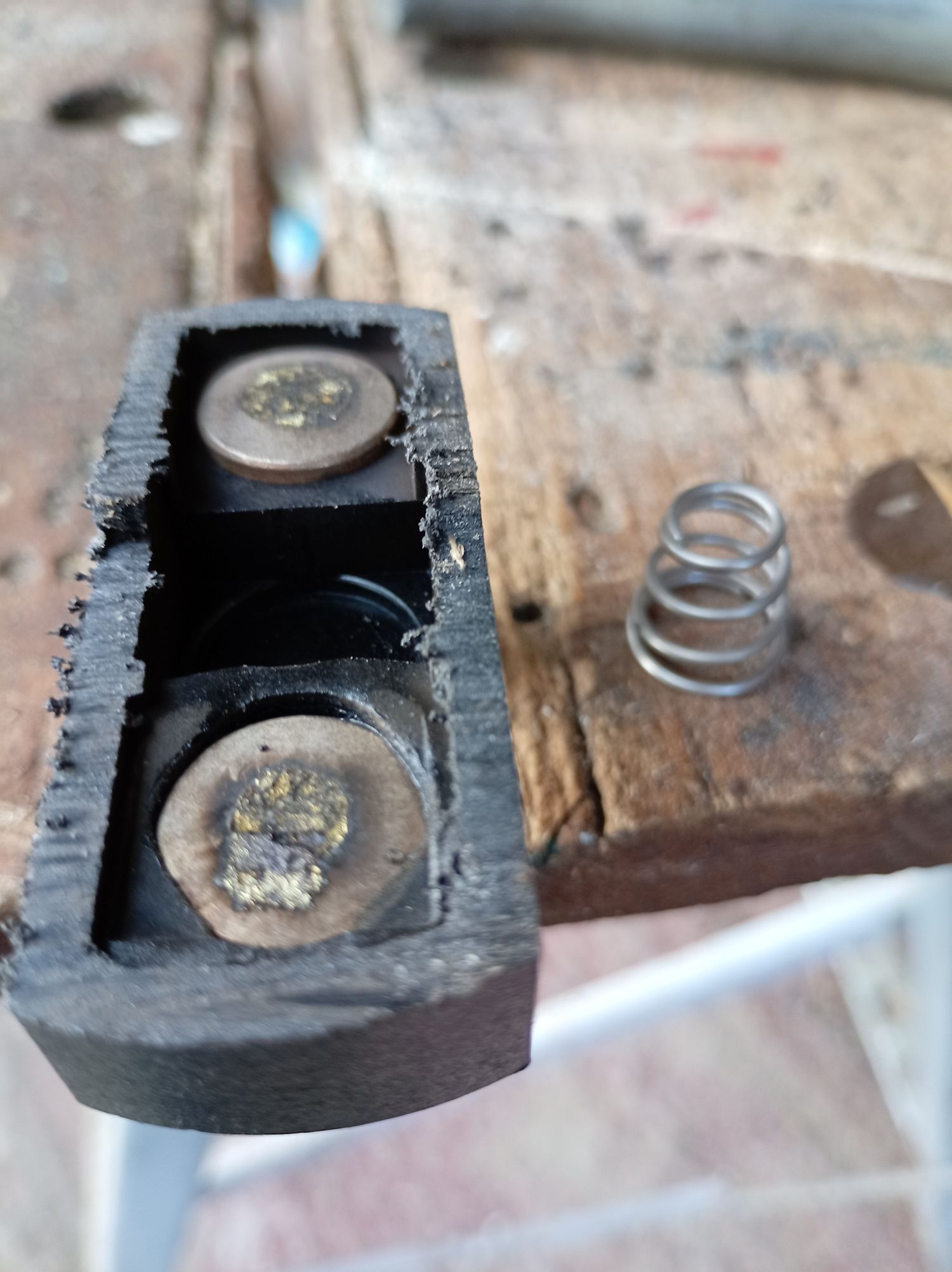

The inside of the burned cheap copy of the BEP switch, which from the pictures looks identical to Blackrose's...

Well I have just joined the band of failed battery isolators, yes it has a red knob but it was far from cheap coming from ASAP Supplies some 25 years ago, but it gave up the ghost just as Diana was finishing cooking diner Saturday night. Thinking about it you only need the tiniest spot of ark on the contacts to get a high resistance connection
Yes they all look identical, that's the idea. As has been discussed, that doesn't necessarily mean they are identical. You seem to be contracting yourself. On one hand you're saying don't fit Chinese copies based on them looking the same as premium products, but then on the other hand you give an example of mine looking the same as one that's failed. Either we can make assessments and assumptions based on the look of a product or we can't, make your mind up.

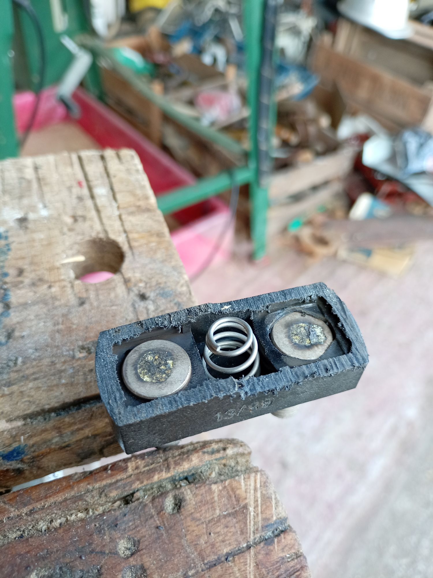

Given the fact that my boat originally came with those really cheap battery isolators with the pull out keys, the contacts of which have been known to fuse together over multiple uses, I really don't have a problem with the ones I've fitted as they're far better quality than a lot of the cheap isolators I've seen being used on friends' & neighbours' narrow boats.
On 10/01/2025 at 13:30, cheesegas said:
Blackrose hasn't pulled one apart to see how it's made, and nor have they done any testing - it's just an assessment based on the look and feel.
I have pulled one apart and it seems to be made in exactly the same way as my genuine BEP switches, although haven't done any testing.

Nope, no inconsistency. The cheap copies often look *similar* to the original/expensive ones (and each other) but not the same. Here are two examples:
