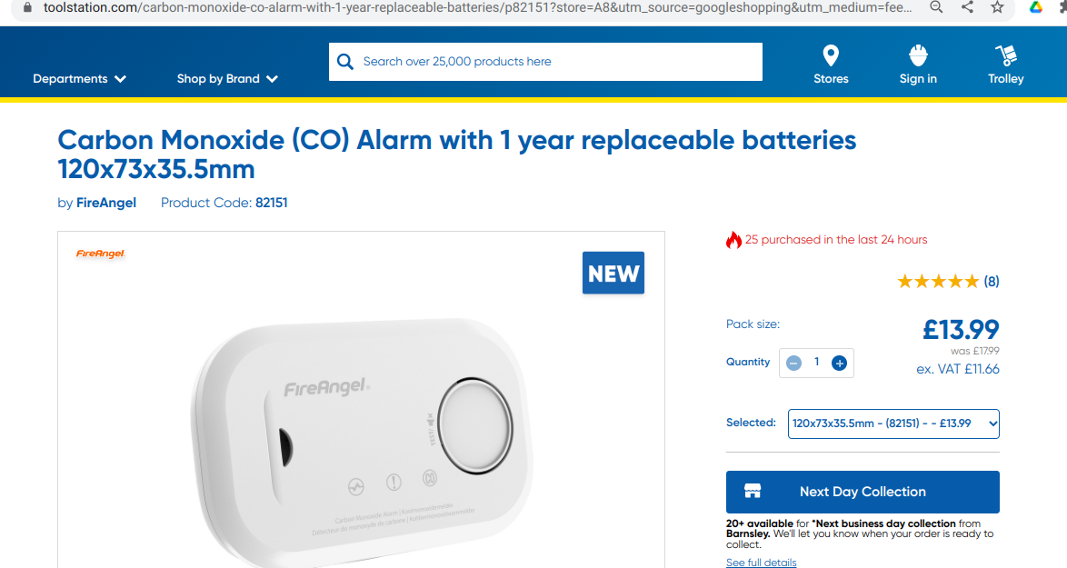

Is didn't take long to find a CO detector with replaceable batteries
