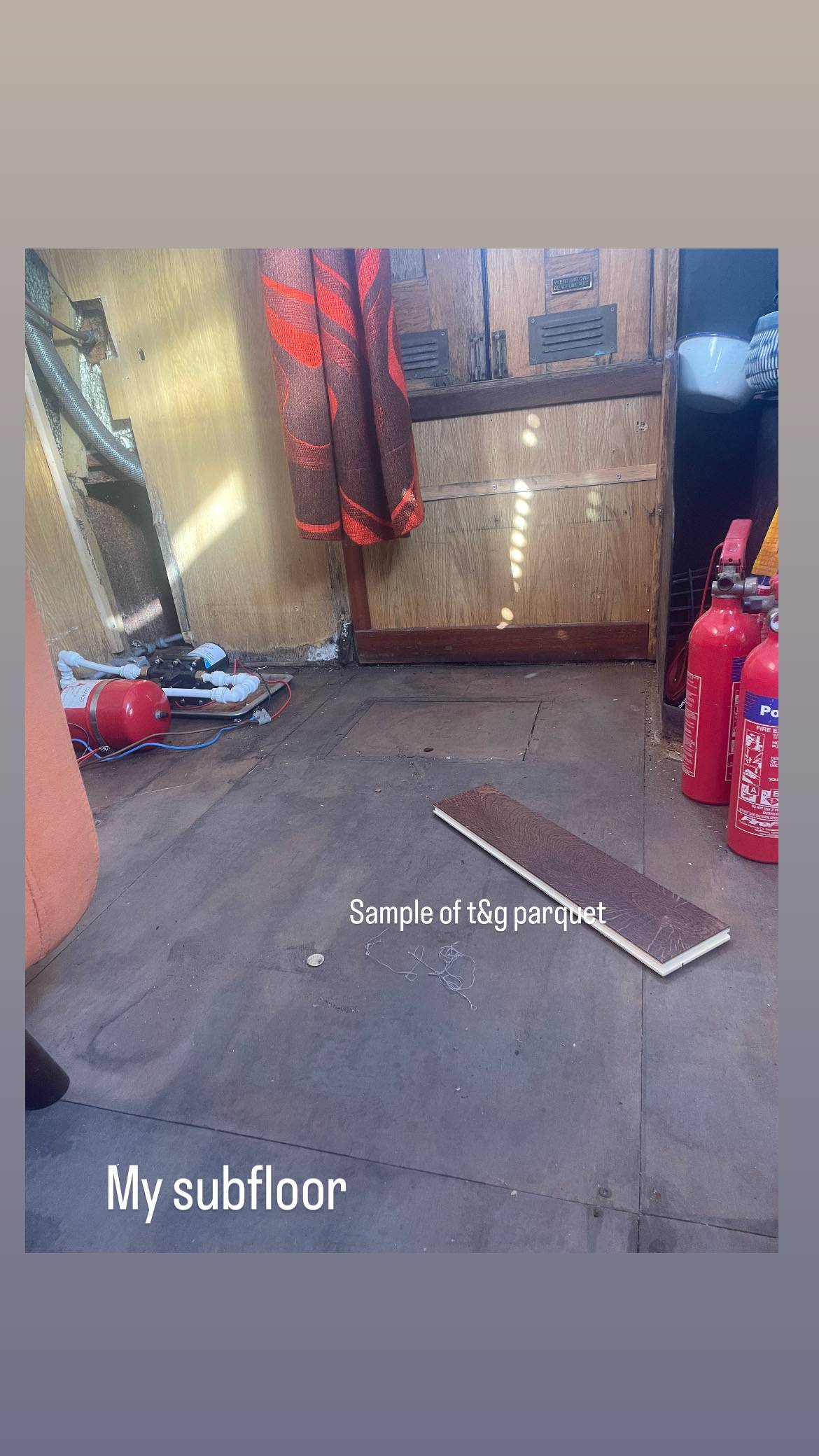

I’ve just ripped up all my floor so I can lay a new one, I’m down to my subfloor which looks in pretty good condition.

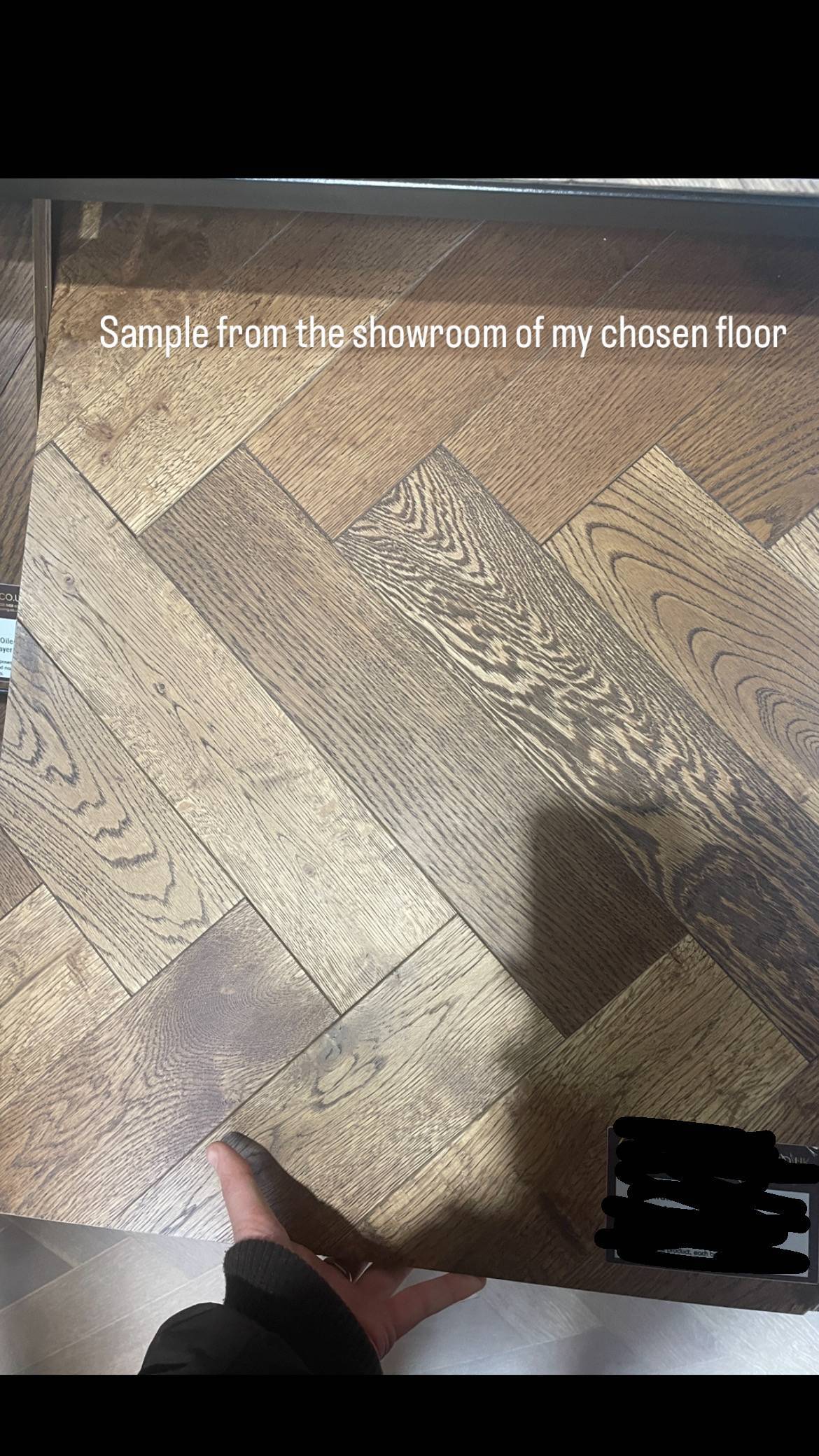

I’m going for an engineered, tongue and groove, parquet in a herringbone pattern (sample in pic). The manufacturer recommends gluing it down with a flexible glue.

Is that a damp issue below the left hand side of the front door? Looks like one of those difficult to trace and fix leaks to me. Personally I have always used carpet, it is a warm surface, it is insulating in itself (especially with underlay)  it is not expensive unless you choose something special and it is virtually disposable, when it gets dirty you can replace it. Its all a matter of taste but it makes sense if you have to get the floor up.

Thanks everyone for your replies.
Aesthetically I absolutely could not stand carpet tiles, so thats out of the question. Likewise LVT, I looked into it before but its a no from me.
I think I'll be laying some thinner ply on top of my subfloor and will glue my parquet to that, of course allowing for access hatches. Probably wont bother with a layer of insulation.

Your subfloor appears to be sound.

You do have an obvious issue of wet related rot by the door. That is a huge warning indicator.
