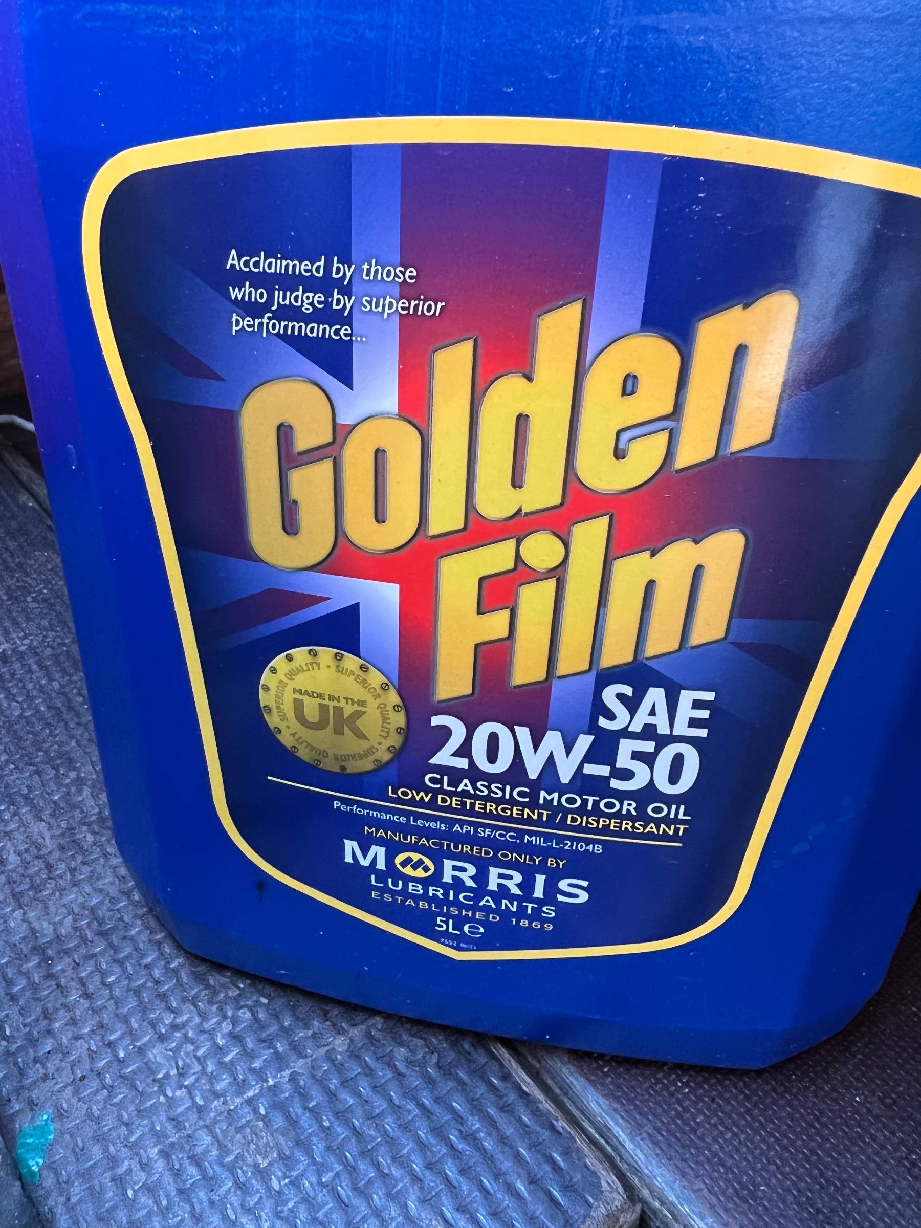

Essex Motor Factors of Bishops Stortford stock the range of Morris oils. I use them in boats and in my car. Very good service.  = Essex Motor Factors 01279 653211.

AFAIK Morris don't do a 15W/40 in their Golden Film range - a shame as it meets the API CC requirement.
I've not re-checked, but over the years I have used Morris 10W/40, 20W/40, and straight monograde SAE 30.
I thing those are your only possibilities for Golden Film API-CC.
The Morris 10W/40 states it is suitable to use where 15W/40 is specified.
