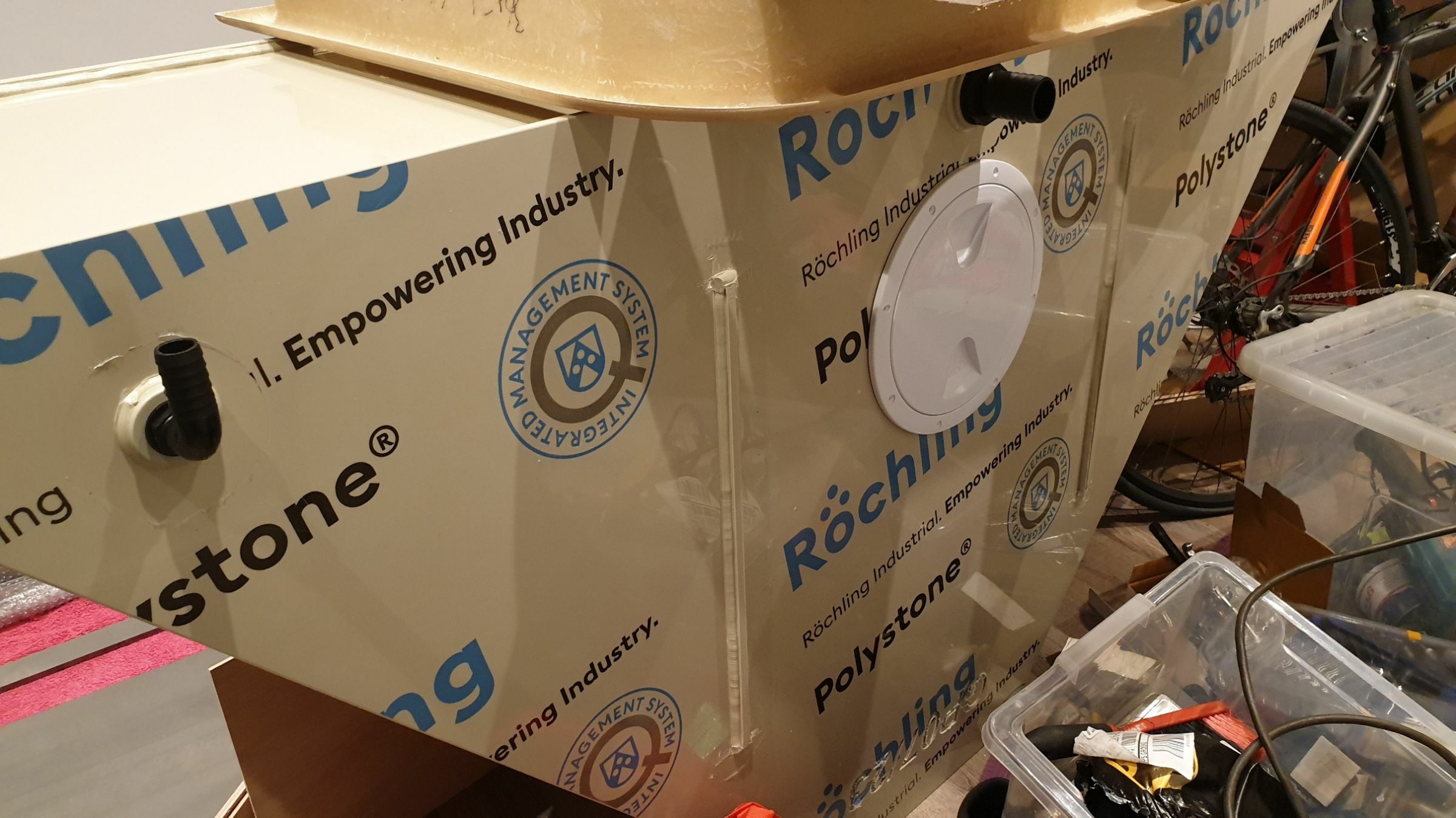

I used Goodwin Plastics, too. They are on Facebook and have hundreds of photos on their page.
Got mine with filler inlet, main outlet, breather and inspection hatch. Also has baffles fitted.
