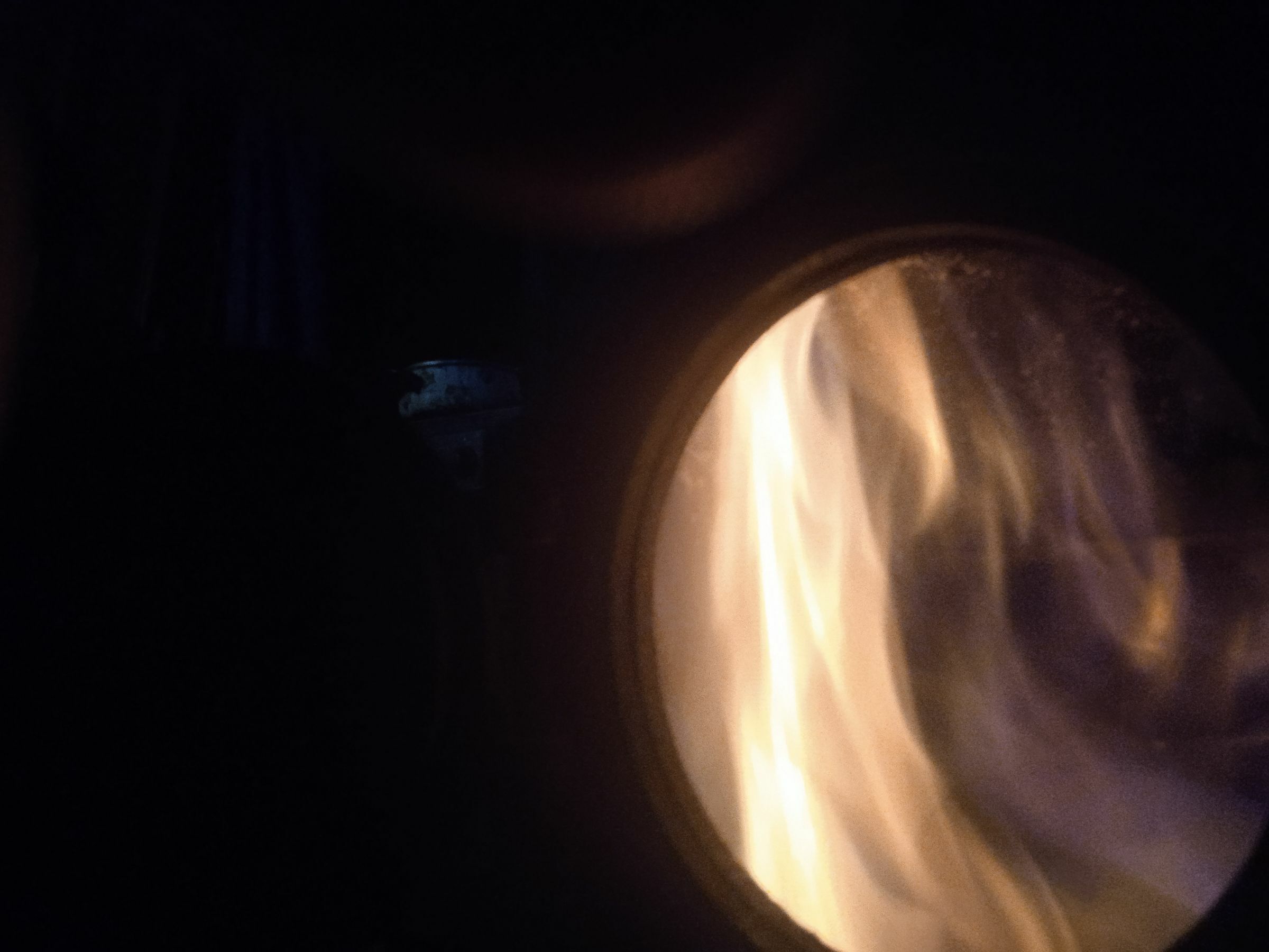

Can you post a good photo of the coal burning in your stove?  I would expect a good orange glow under all the coal, and with full air a few little flames.
