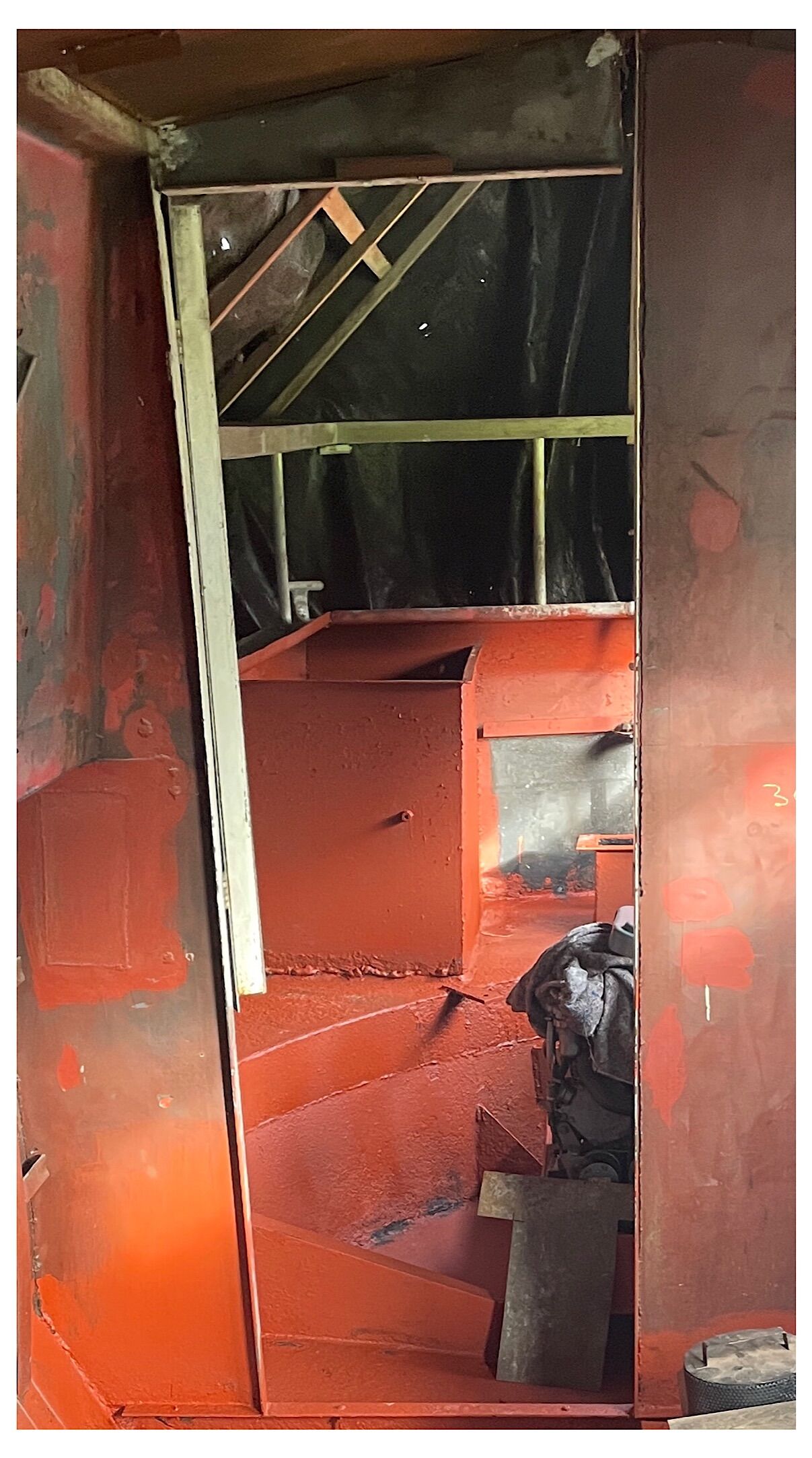

Flipflop Posted November 29, 2023 Author Report Posted November 29, 2023 I may have answered own question from old pis I’ve found but advise still much appreciated even I’ve spelt wrong… Engine bay now cleaned out 2

BEngo Posted November 29, 2023 Report Posted November 29, 2023 To answer the original Q. Wooden deck supports are entirely feasible, but, even if made of treated timber are liable to rot, particularly at joints. They will also not channel water overboard, so the bilge will be wet when it rains Steel channel, with good sized drain holes is a better bet. N

Bee Posted November 30, 2023 Report Posted November 30, 2023 Cor, that's a job, well done for tackling it. In my opinion (frequently wrong) you will, as you say, have to keep the steel channel just to drain water away but tanalised wood - that's the greenish stuff - will be OK for a sub frame but it will eventually rot anywhere that the deck boards join over the wood. "Cruiser sterns" do tend to suffer from problems with drainage and rot/rust unless they are carefully designed and built.
