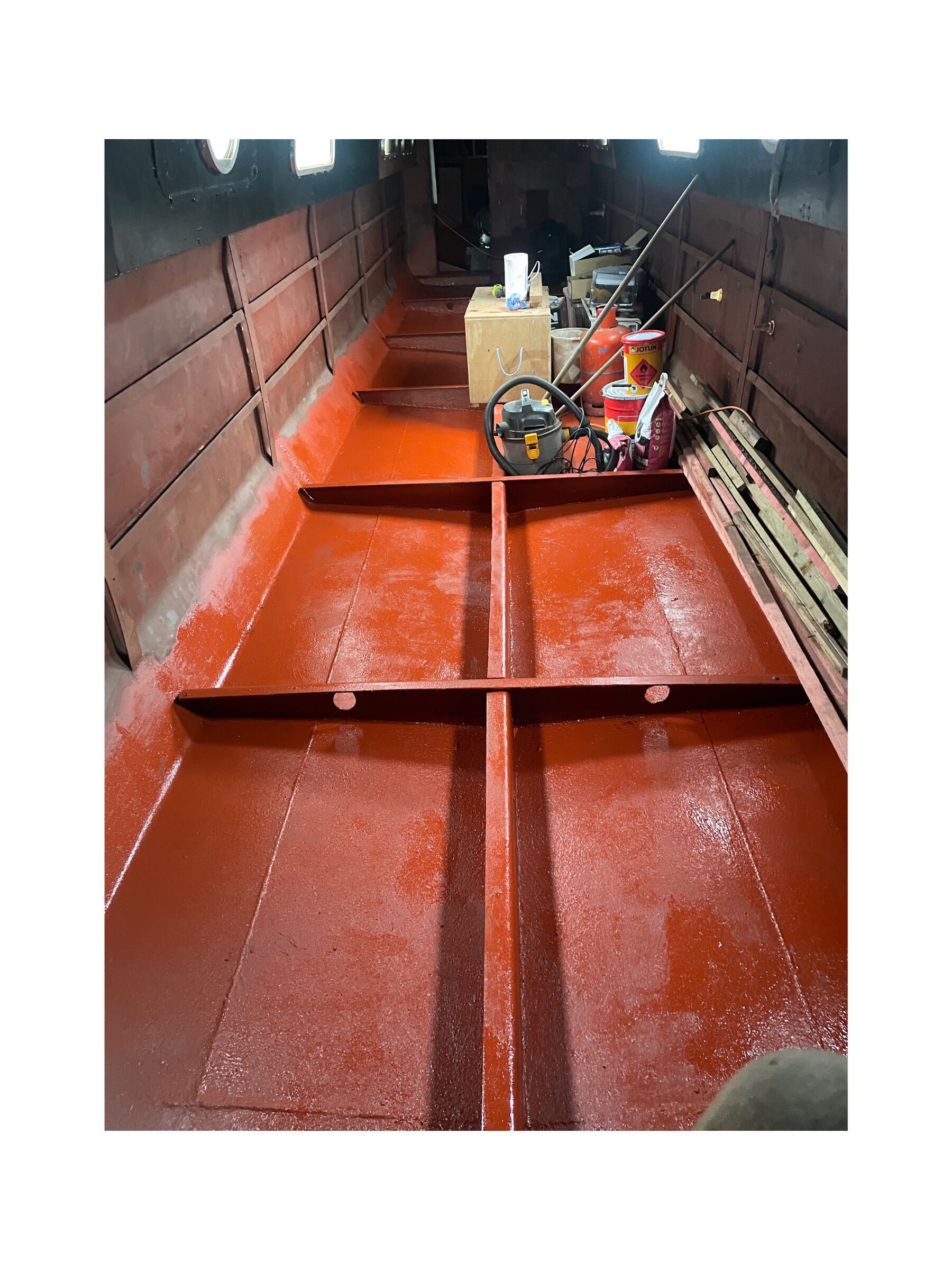

Flipflop Posted November 30, 2023 Author Report Share Posted November 30, 2023 I’ve not taken any wood out but I’m going to put protected wood in the middle of the bays for floor support 1 Link to comment Share on other sites More sharing options...
truckcab79 Posted November 30, 2023 Report Share Posted November 30, 2023 Just now, Flipflop said: I’ve not taken any wood out but I’m going to put protected wood in the middle of the bays for floor support Cheers. Presumably they never thought it required. Link to comment Share on other sites More sharing options...
Flipflop Posted November 30, 2023 Author Report Share Posted November 30, 2023 Just worried about the flooring bowing in the middle of bays as there quite big Link to comment Share on other sites More sharing options...
ditchcrawler Posted November 30, 2023 Report Share Posted November 30, 2023 2 hours ago, Flipflop said: I’ve done some Are there any dranage holes at the lowest point to let any water run to the stern in those cross members Link to comment Share on other sites More sharing options...
Peanut Posted November 30, 2023 Report Share Posted November 30, 2023 If you put timber longitudinal supports, along the length of the cabin, across the transverse framing, not only will it support the floor, but also allow ventilation from front to back, through the gaps between the timbers. With a ply floor, you will need to think about access to any shower drain pump and a trap at the back to inspect the baseplate for water ingress. Sorry, I know it doesn't help with the rear deck, which must be made to drain overboard. Link to comment Share on other sites More sharing options...
Flipflop Posted November 30, 2023 Author Report Share Posted November 30, 2023 Yer there are gaps all the way down the centre to let water run through I’ve cleaned all those out Good thoughts about long way timber water would have passage way aswell I’ve needed Link to comment Share on other sites More sharing options...

truckcab79 Posted November 30, 2023 Report Share Posted November 30, 2023 4 hours ago, Flipflop said: Just worried about the flooring bowing in the middle of bays as there quite big Yep. That would be my concern. 18mm ply is pretty rigid but on yours (and I think mine), it’s only supported on three sides so it’ll definitely sag without some extra support. Link to comment Share on other sites More sharing options...
