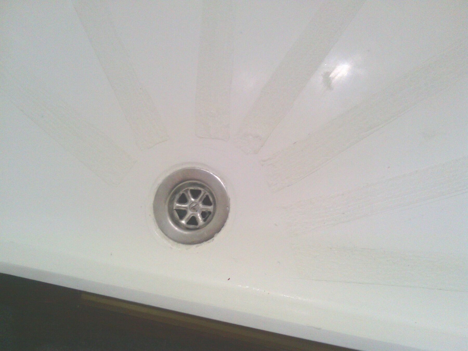

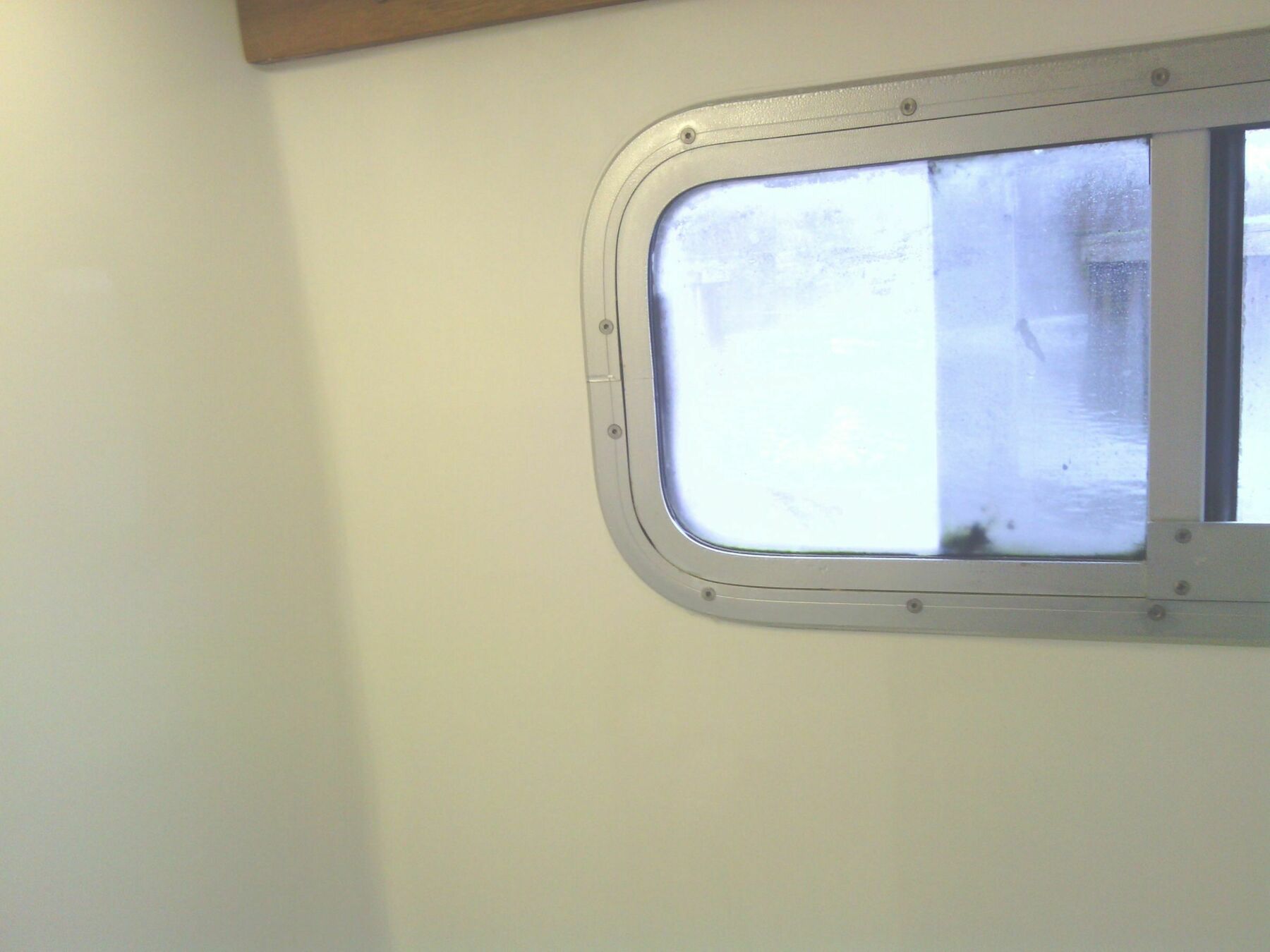

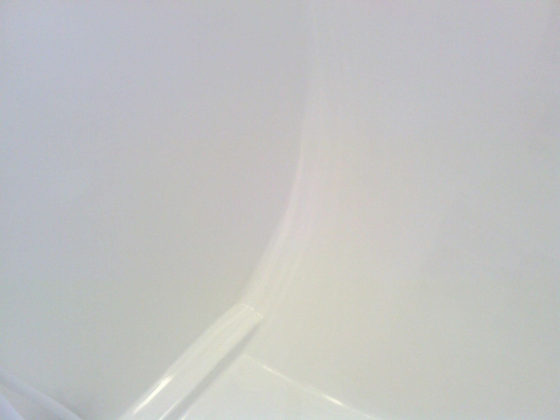

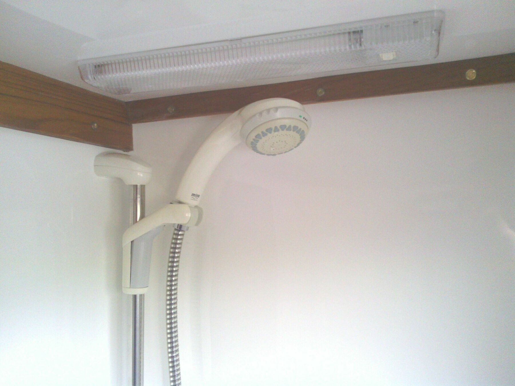

On our 36' cruiser we had 3 toilets so we decided to make one into a wet-room (shower), basically it was the size of a double wardrobe.
Got a 'man im' who measured up and then prefabricated the entire floor and sides in panels that'd fit thru the door, vam enad installed and gelcoated over the lot.
Made a tidy job.
Space is too small to get much in the way of a single picture, but a couple of pics showing the walls and floor.
1) Outside wall and window
2) Curve of the outside wall, an inside bulhead wall and the floor curved due to the shape of the hull.
3) Shower head and ceiling
4) Floor and plughole (water gravity fed into grey water holding tank)

1 hour ago, Bacchus said:
I have what I guess is a very similar boat (Linssen 32) which has a wet-room/loo adjacent to the after-cabin. It looks like a gravity drain to (I am guessing) a sump with a whale gulper on the midship side to pump the grey water through a skin-fitting. I don't know what the sub-floor is built of, but the flooring is lapped about 4" up the side of the walls to form a sort of integral tray, which is exactly what I did on my camper with fibre-glass (except that is gravity drained to a tank). If I was doing it from scratch I would be tempted to source some proper marine ply rather than WBP, but the latter will do the job for a good few years.
The shower area has a curtain to separate it from the loo, but you would have to walk through it as mentioned above (by @Ken X ), however I have found in the past that can be mitigated with a slatted mat type thing like this
thanks for advice and that type of slatted timber mat is called a ‘duck board ‘ perhaps connected to what the troops made for the trenches in W W 1
Made a tidy job.
Yes this looks and sounds the business. As I will be doing all the work on the tow path , as the space is tiny and as a tradesman with all the tools , trestles etc all the panels etc shall be easy to cut , shape etc and fit
