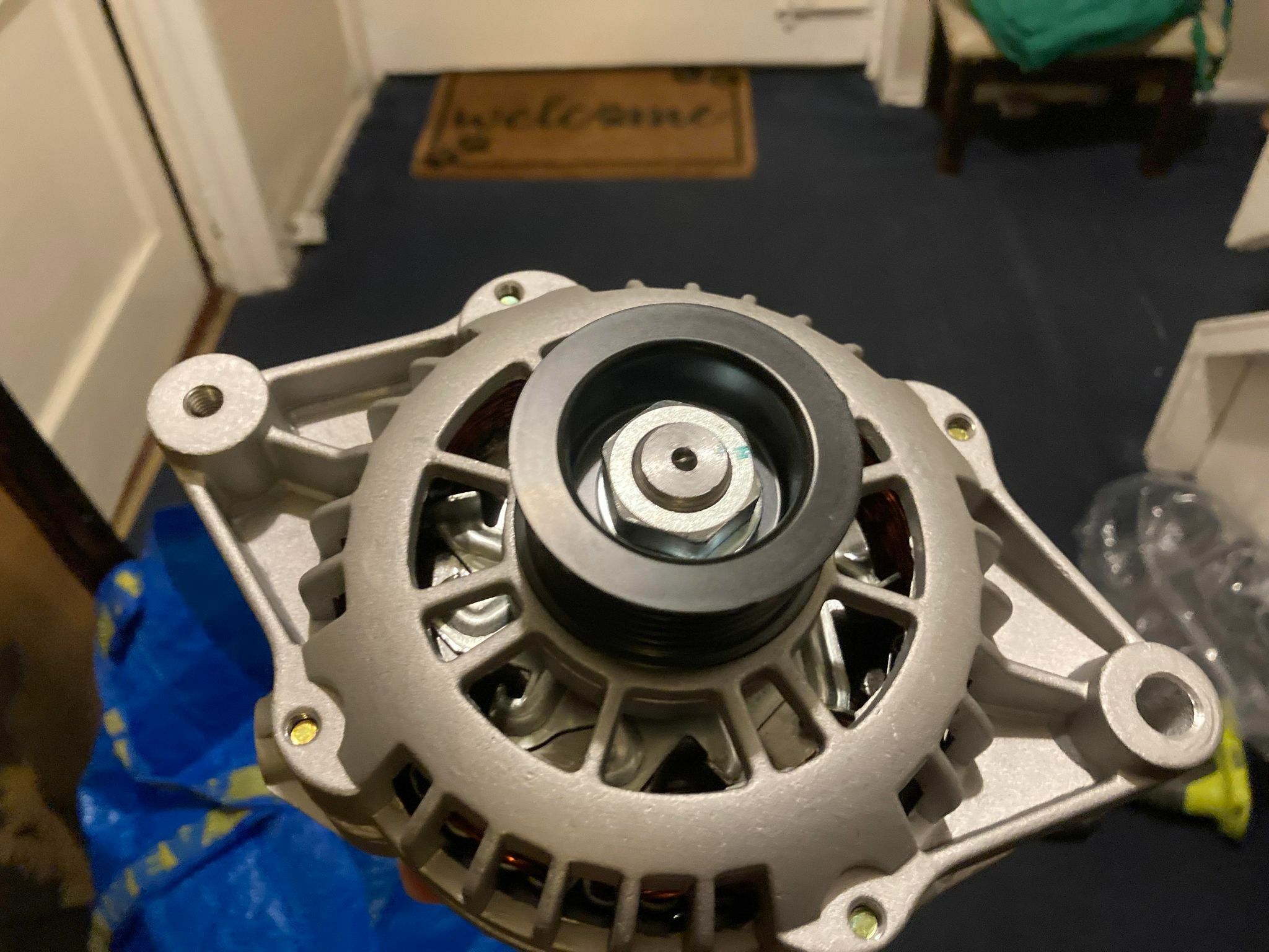

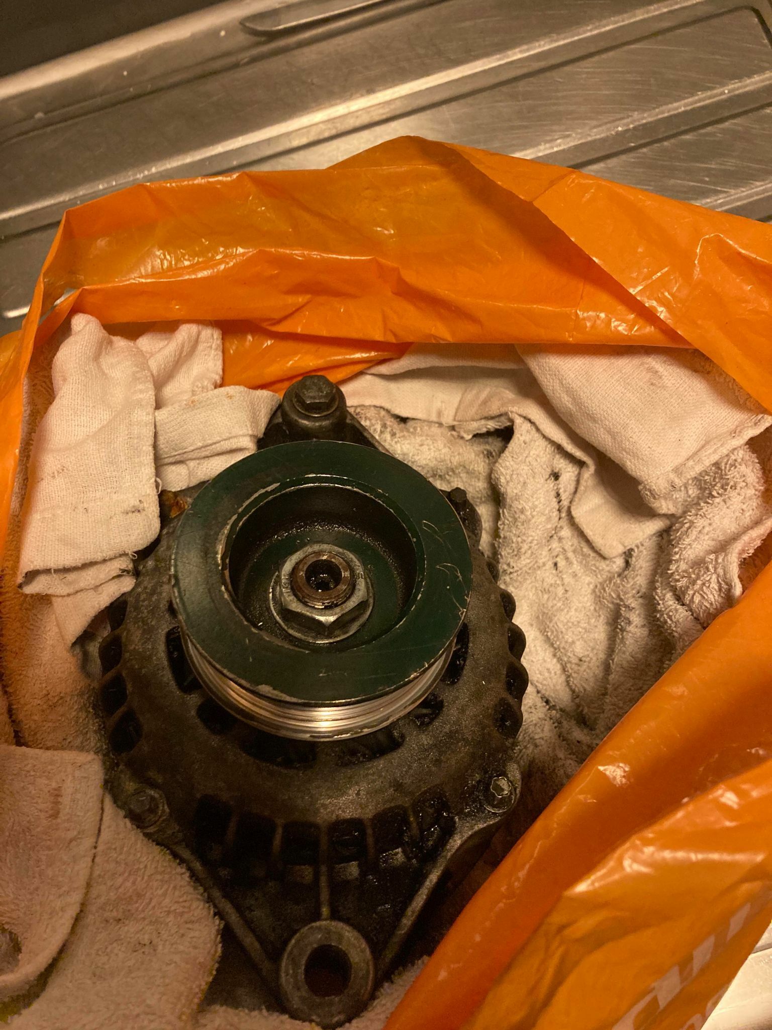

I am replacing my 100A domestic alternator - the model is pretty much a straight swap. Easy enough there. However, the pulley that comes with the new alternator has a 55mm diameter, where as the old one was 80mm.
As it seems to be VERY difficult to swap them over (I have tried myself, although keep reading that an impact wrench is the only way) - I was wondering if I can just keep the smaller 55mm pulley? Will that affect anything?

All boaty things are a compromise, and this includes the pulley size. How much it matters depends upon your engine and installation.
In general a smaller pulley is desirable as it gives more output at lower speeds and better alternator cooling.
But,
some engines, especially smaller ones, might not like a big alternator load at low speeds and in extreme cases damage can be done.
The smaller pulley has less surface area and will reduce wrap to some (variable) extent and this just might give belt slip or temp you to over-tighten the belt.
The green paint might suggest a Beta engine ??? and they might have chosen that pulley size for a reason (or maybe not)
If you do change the pulley then undoing and safely re-tightening the nut on the new alternator might be a challenge 😀
Do/did not Beta fit freewheel pulleys to some larger alternators? If the old one is a freewheel, then fitting a solid one might not be good for longevity.

What is the diameter of the engine pulley? What is the idle speed and maximum speed of the engine? Provided it doesn't exceed the maximum speed allowed for the alternator (ratio of the two pulley diameters), which is unlikely on most diesel engines, then it should be OK, all other things, like grooves are the same.

Thank you, all,  for your advice - I shall keep the 'new' pulley on the new alternator.

Just to update this thread... I was hoping to keep the 'new' pulley as, like someone said, it would likely be better charging. However, the old pully had a built in spacer that means the new would would not line up the same with the belt, so I had to swap over. I found a great little place called The Starter Bay in Gloucester that did this for me in the matter of minutes. So all is well now :) Thanks for everyone's input!
