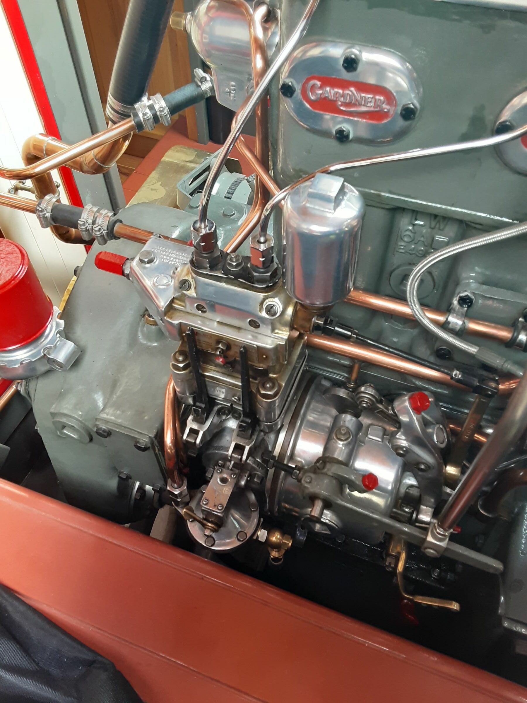

After getting back from our summer on the boat with no issues we left the boat for a week in the marina.
When we returned for a short trip it would not start. It turned over but instead of firing up after a few seconds it just kept on going. I pumped the lever on the fuel for a minute and tried again and it started after about ten seconds or so.
I had a look at the fuel filter, it was still clean, but changed it anyway. We went for a few days trip and each morning it started as normal.
Today after leaving it for a week, again it would not start. Pumping the fuel for a minute and again it started.
It has always been very reliable in the past, starting on freezing cold days after having been left for weeks, without a problem.
Any ideas would be welcome.

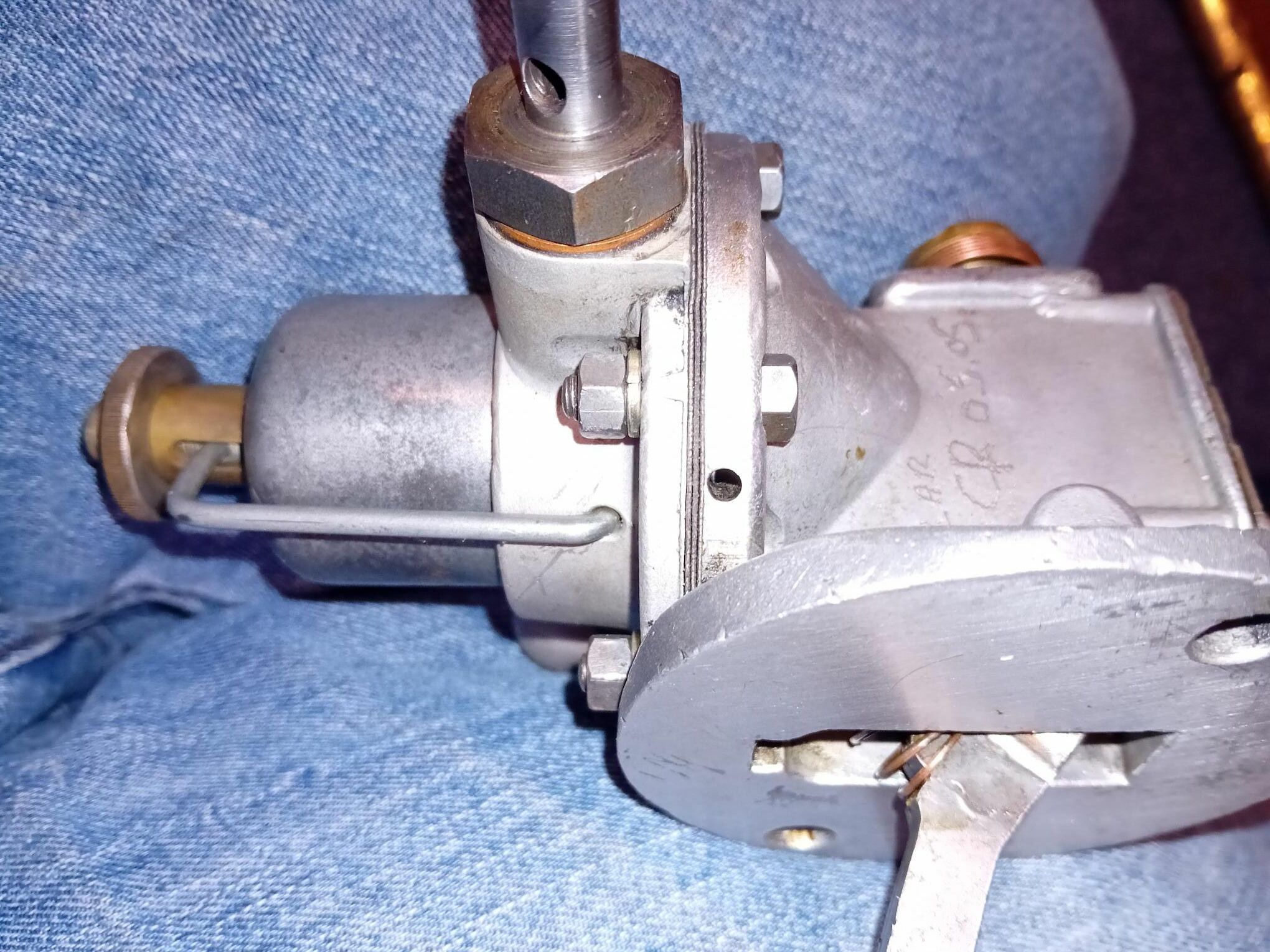

How much fuel around the lift pump and are you certain it is fuel and not oil? Some lube oil will get onto the top of the diaphragm and the upper pump body has drainage holes to clear this. in the past i thought i had a leaking diaphragm but in the end concluded it was oil.
Only a small amount around the diaphragm but this could have got worse! I wipe it clean and it usually stays dry until I run the engine again.
This may or may not be relevant. I don't know the details of that engine, but the fuel filter could well be a 296 CAV type. If so they seem to come in two forms. The early ones sealed the centre bolt with a soft washer onto a machined face. if yours is like this, then the Dowty washer is a good idea. later ones seem to seal with an O ring under the head of the bolt and this type still has a sort of machines faces but the top of the bolt hole is tapered. if yours is like this the lip on the rubber part of a Dowty seal may well just enter the taper and do nothing at all. If so it could well leak air.
If it is not a 296 type please ignore.
FYI two drain holes as in centre of this image

Whichever it is, I compliment the OP on having an immaculately shiny engine unspoilt by all the slight oil and diesel leaks mine always seem to display!
The 4LW in my old crane started doing that....after being totally reliable for 30 odd years .....fortunately the yard clear up was finished...........My theory was the rubber ring in the primary fuel filter had given up..........I have lots of the filter elements,but no rings ...so the ring hasnt been replaced ...........Anyhoo, I just walked away and left the crane there.
No, no, no. You misunderstand. These are not leaks.  They are the continuous  corrosion prevention system at work.
