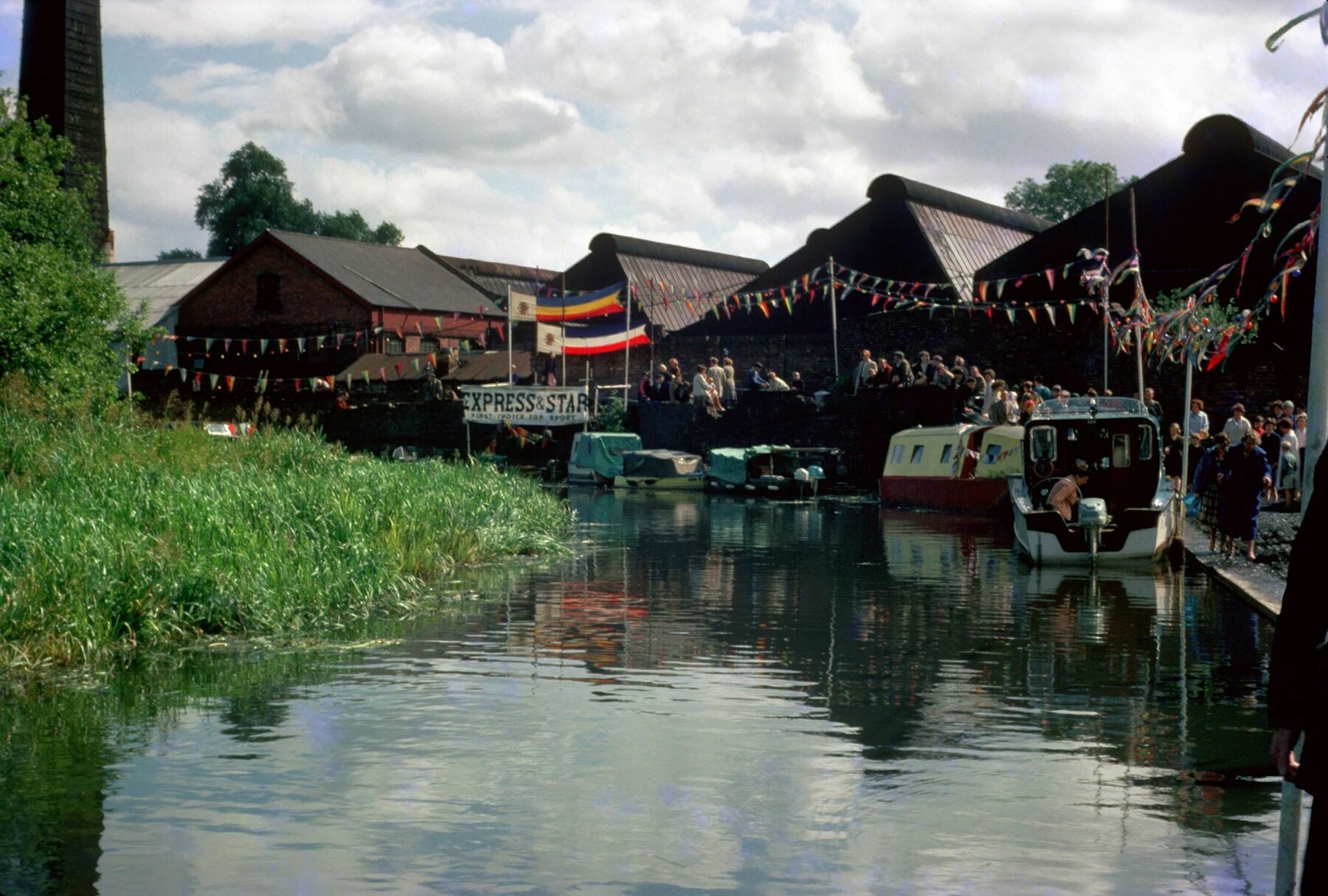

It does help when you have lived in the area for a good few years, another image taken by the late Alan T Smith M.B.E at the 1962 Rally, the yellow pontoon conversion was our family boat. so I had a bit of ahead start.
Foster & Rastricks Iron Works, home to the Argenoria, now the site of Lion Heath Centre housed in part of the old building An earlier image
