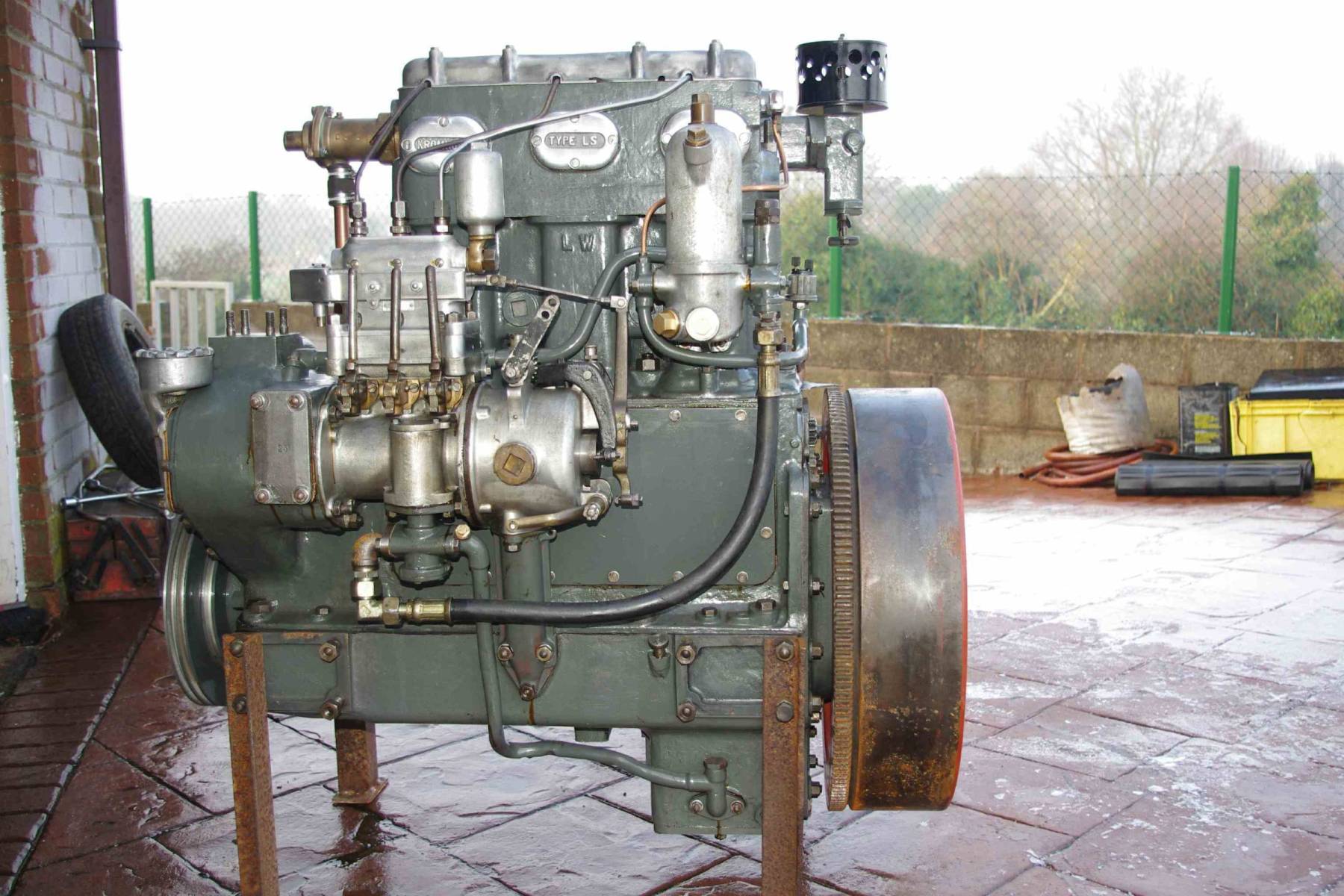

We have just bought a narrowboat with (allegedly) a 1935 Gardner 3LW from a Dutch Bus (so a Kromhout I guess?) but there is no sign of an engine number in the usual places. Nothing on the plate on the injector other than the pump number and I chemically stripped the paint from the block behind it and there is nothing there.  Is there any other way of finding out it's history?

Seems underpowered for a bus? ........prewar 3LW would be 48hp? ...........possibly a replacement crankcase .

I'd agree, and further I think the Kromhaut versions were proper marine engines where you can separate and lift off the cylinder block from the crankcase. Significantly more valuable than a basic 3LW.
Mind you I know nothing about Gardners. Not proper vintage engines if you can't see the flywheel!

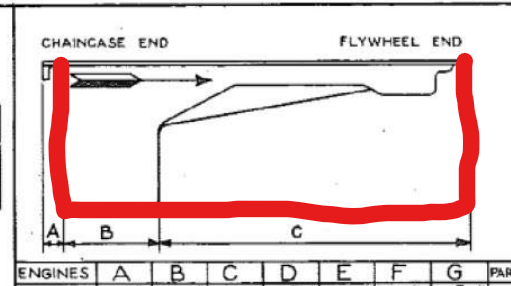

Went down to the boat today and took a look at the sump. Through the medium of my incredible art skills, let me demonstrate the shape/size of the fitted sump vs an illustration of the wonderful lines of the original:
I didn't have a measure with me, but it's basically a bloody big bath 😂

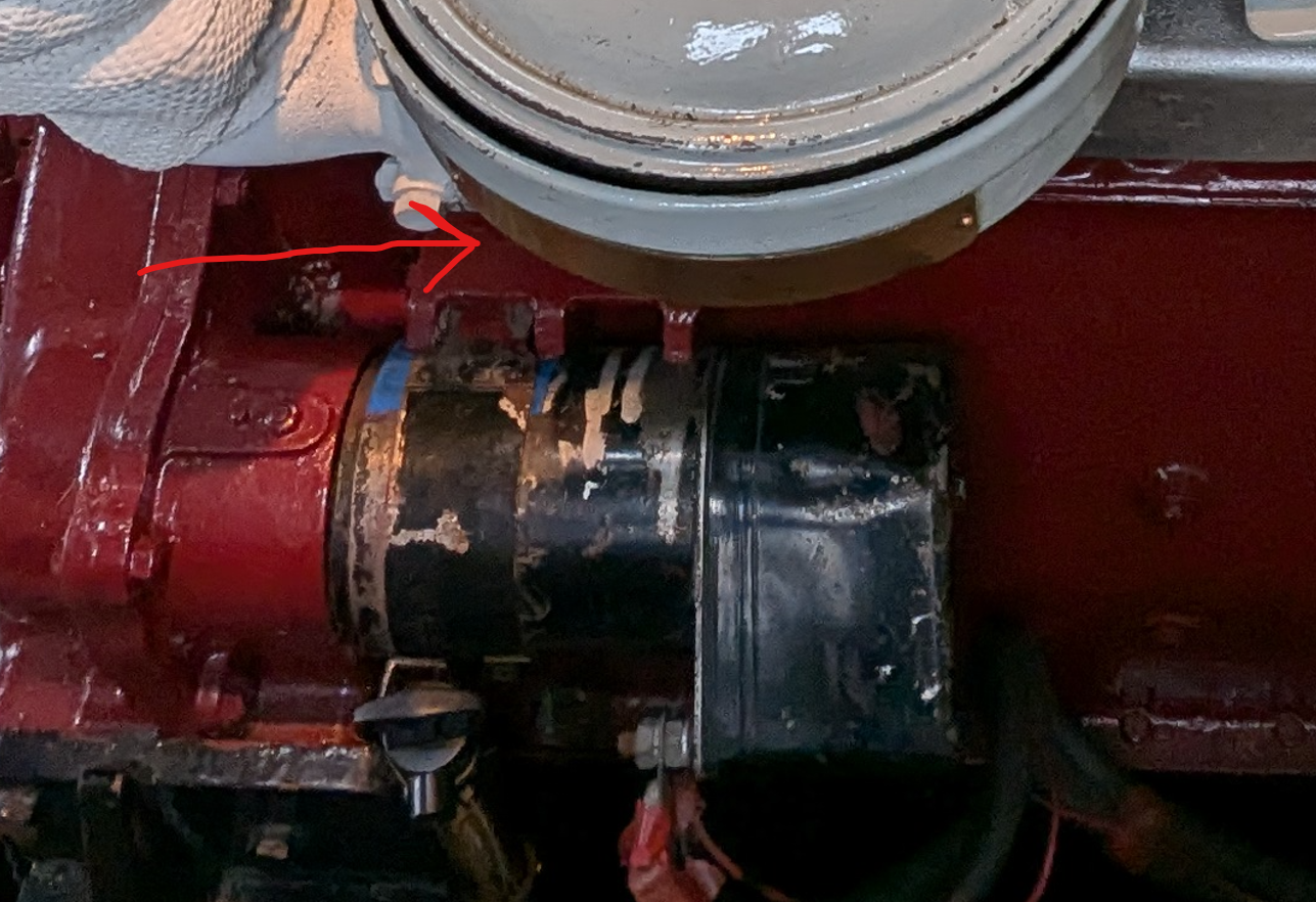

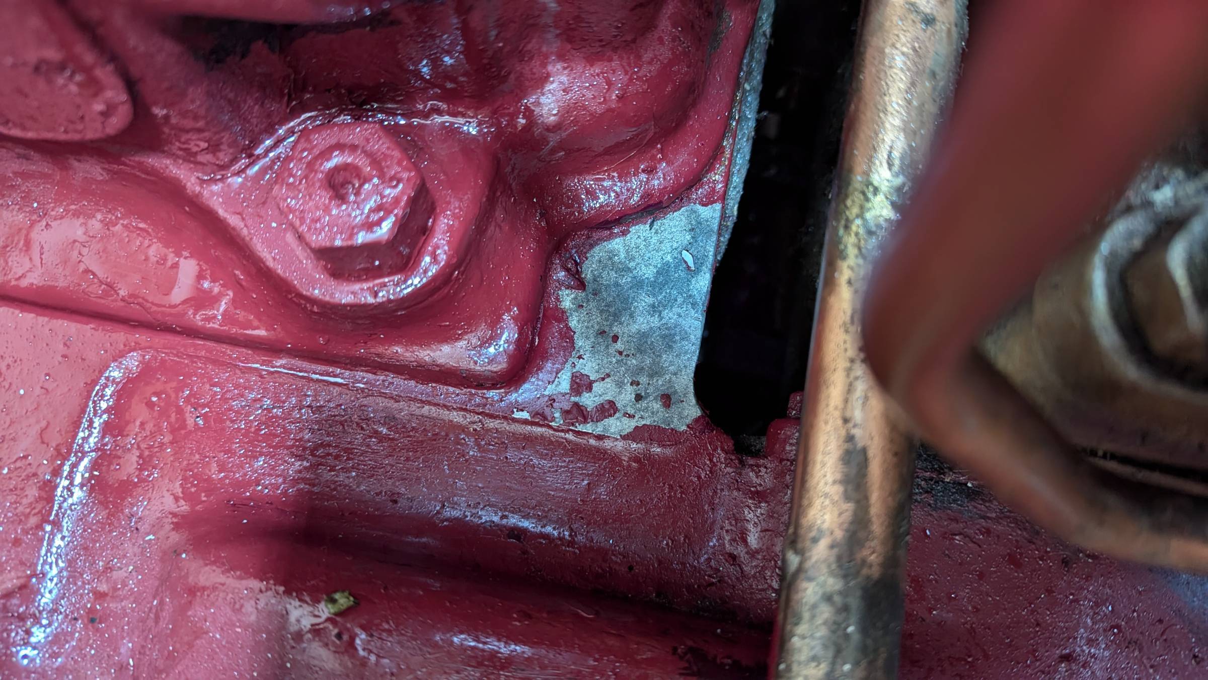

Thanks for that info Steven.  The numbers I have are:
  • Flywheel: 60082
  • Injector insertion plate (injector brass plate has no engine number stamped) : 122?75
  • Side of cylinder block (assume it's a part number as it's part of the cast) : E4934
It has the gauze oil filter and the oil bath air filter (we think it's a Gardner one based on the plaque, colour and size of the inlet), but not sure that ages anything other than those specific parts.
Quote
Another place that you may find a number or date is the flat surface above the starter motor mounting
Do you mean here (not the brass plaque but the flat surface with three prongs)?
#22
If the sump is the shape shown in the red outline in an earlier post could it have been a fabricated replacement for the original article?
If the original had been cracked or damaged somehow the engine might have ended up being sold for scrap value. Someone clever might have spotted it and had a custom made sump fabricated for it.
Much easier to fab a 'great big bath' than a shaped sump and there would be no disadvantages to having a large sump in a canal Boat.

I think you are right though, it's tough to see in detail but it does look "simpler" than the official ones and larger on at least one edge than the crankcase above it (i.e. the edge sticks out, not open to the world)

the flywheel number places it between July and December 1943

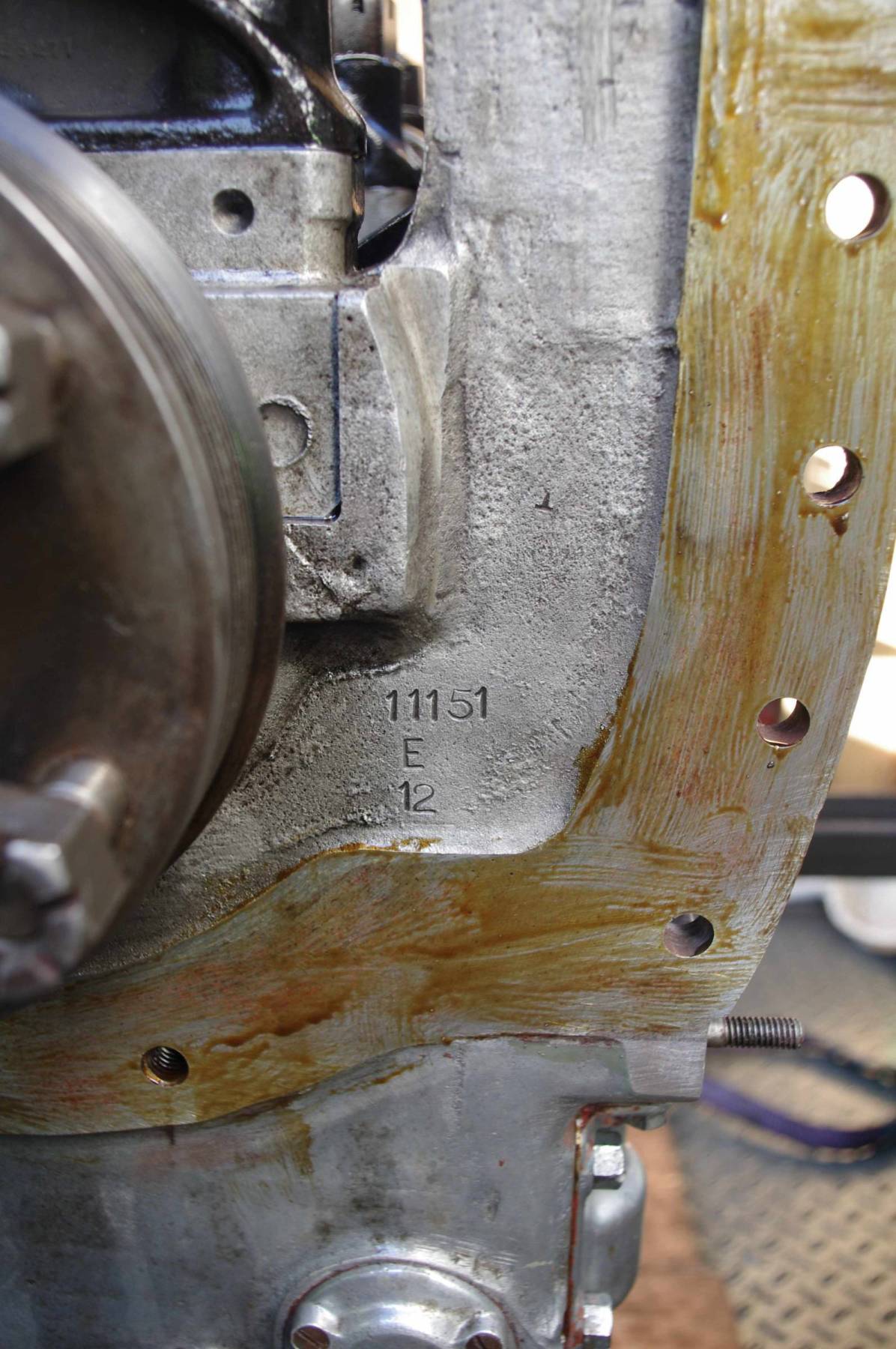

Yes that is where you may find a date.
 The E4934 is a casting ref number.
The other position is on the back of the crankcase as per the picture in this case the engine build was tested in May 1952
