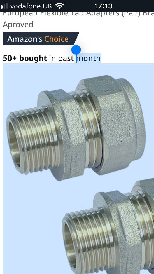

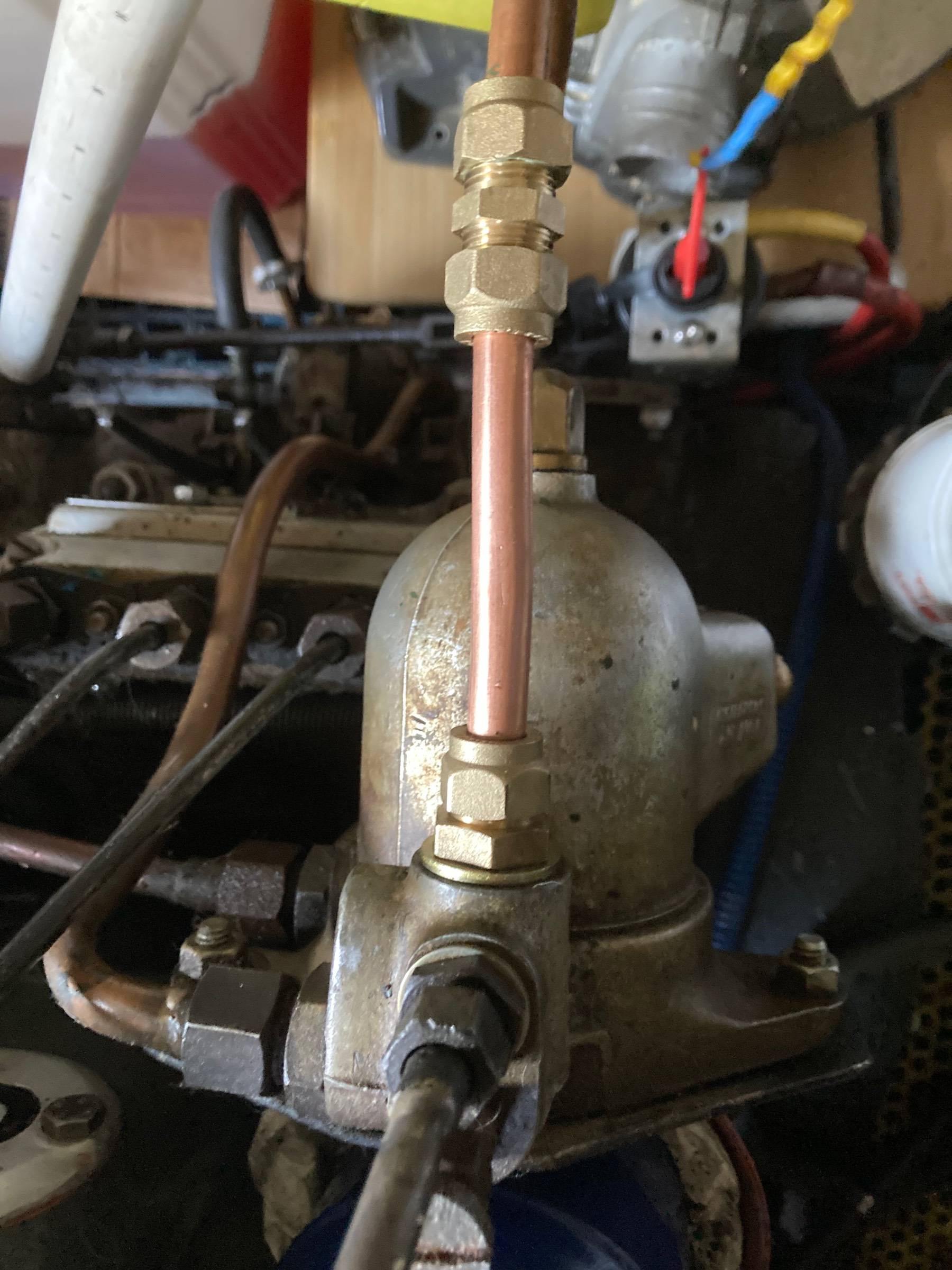

  1. Sorted 3/8”BSP X 10mm compression 10mm X 10mm running 2 hours not a drip

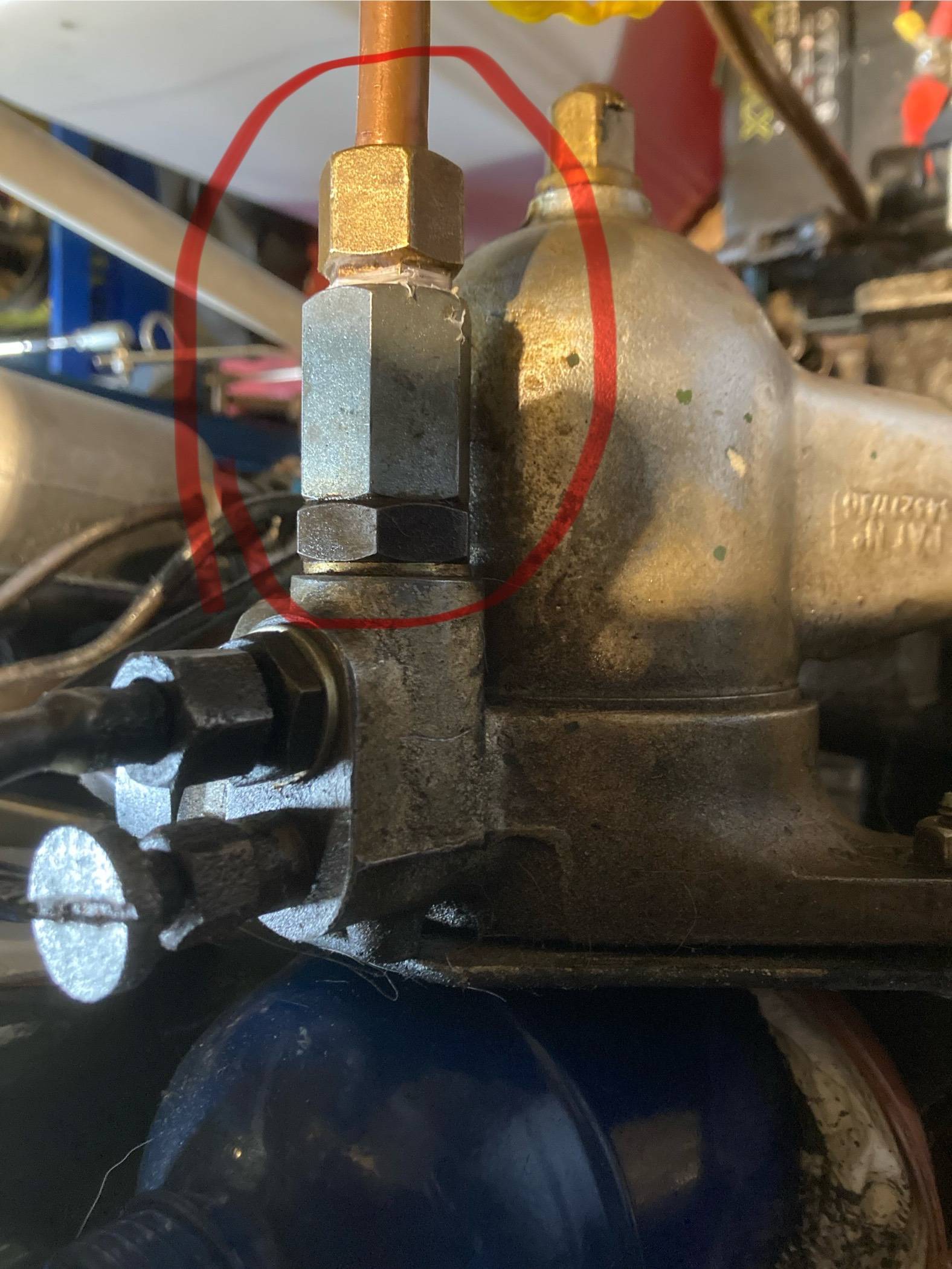

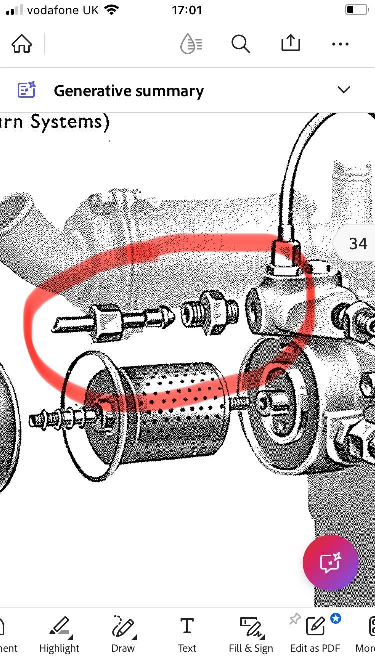

  2. Hi on a 3 LW the return is seeping, I can’t remove the 10mm pipe from the silver hexagon piece, I suppose spacer, I’m assuming it is a full internal thread there seems a to be 2 brass bits, maybe an olive inside outer nut Think maybe a quick fix when engine was on a fishing boat any guesses as to overcome the problem maybe something like this with a dowty between silver and brass man’s any ideas on BSP thread size

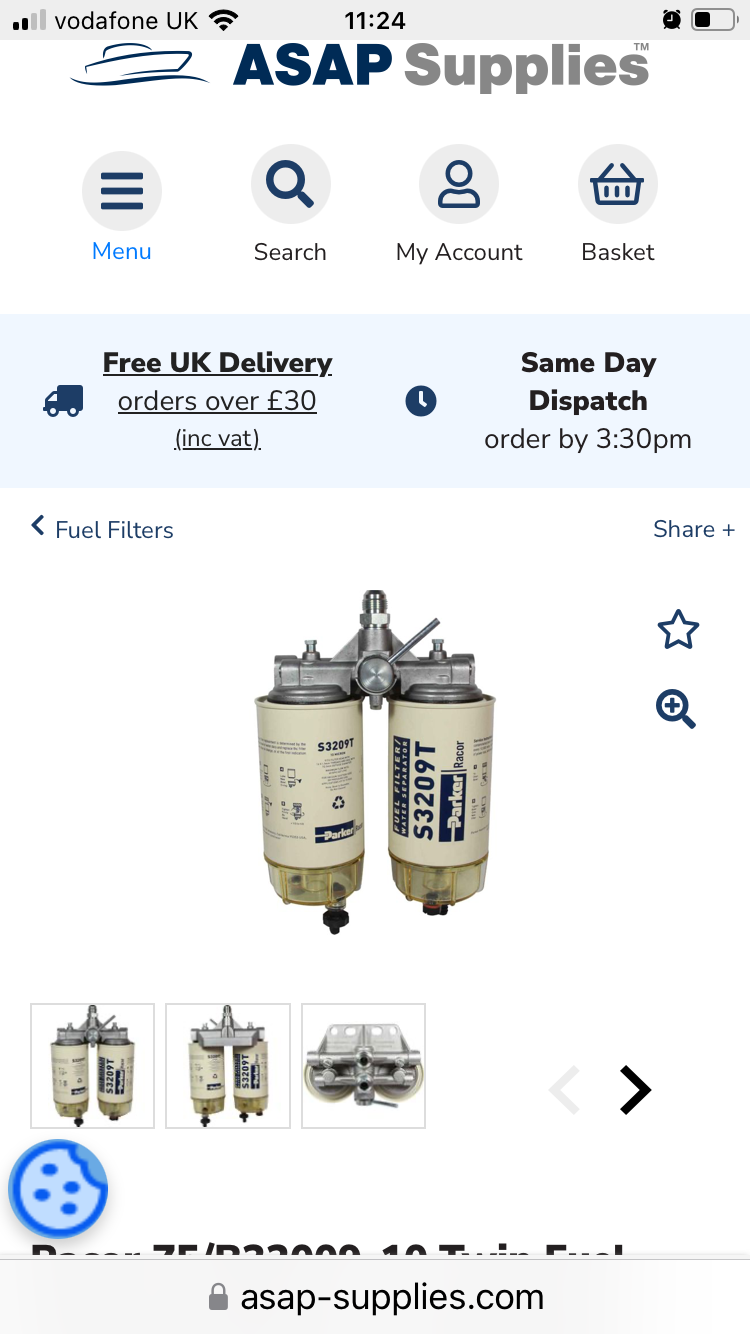

  8. I have a twin fuel/water separating filter unit The filters are S3209T that screw into the housing and metal base with drain plug screw into bottom of filter they are about 9-10” long I would like to change to filters about half the length Di any of you folk know of such an element steel bowls cost £90 each to replace for BSS

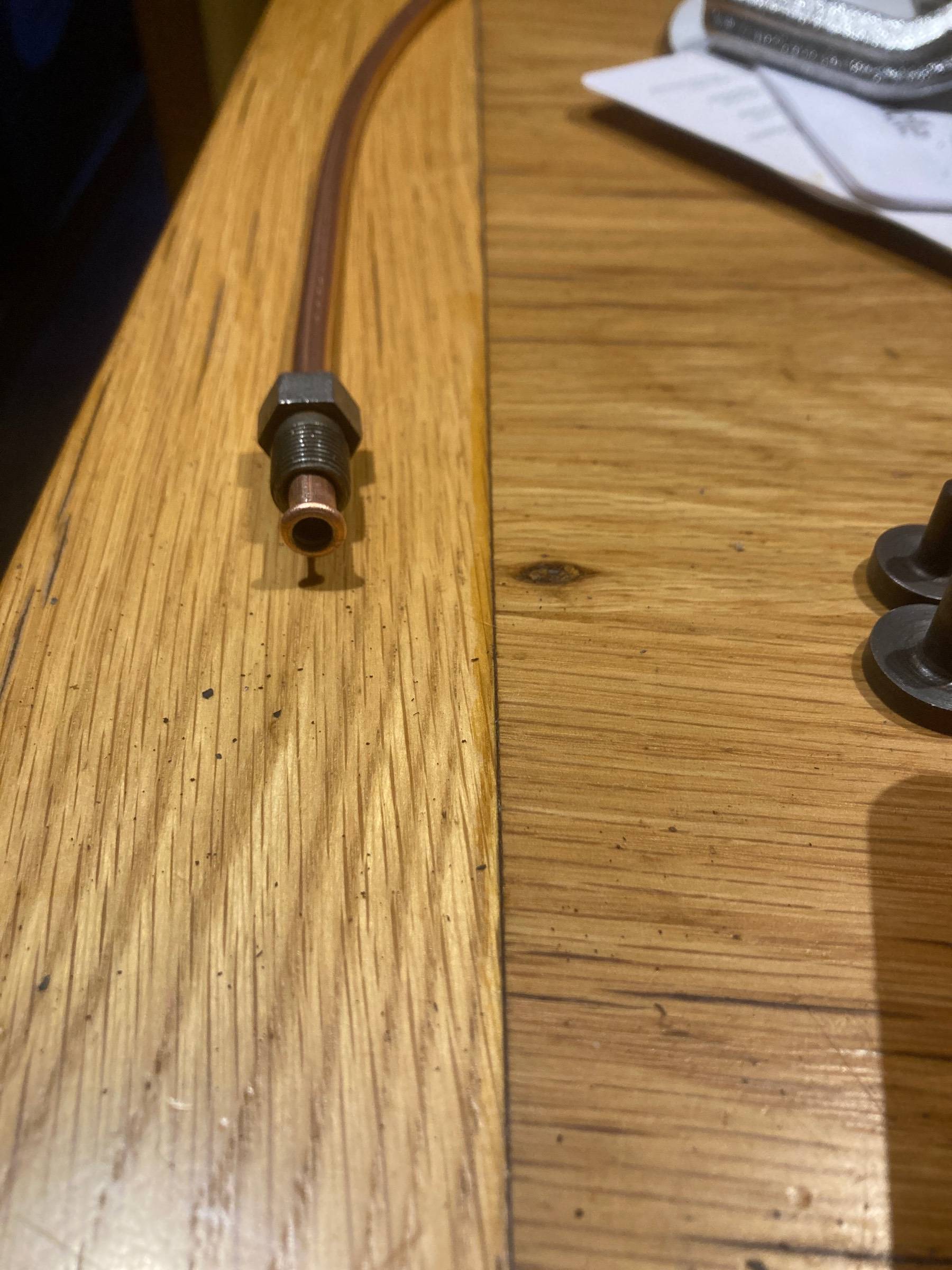

  9. Looking for a banjo 5/8” bolt size 1/4” pipe hole looking to purchase new or used cannot find in www Making new pipe up as original when bought engine had a soldered sleeve which j have re soldered twice I have the pipe and have flared end I don’t want to take original off and reuse until new pipe stood the test of time thank you in advance
