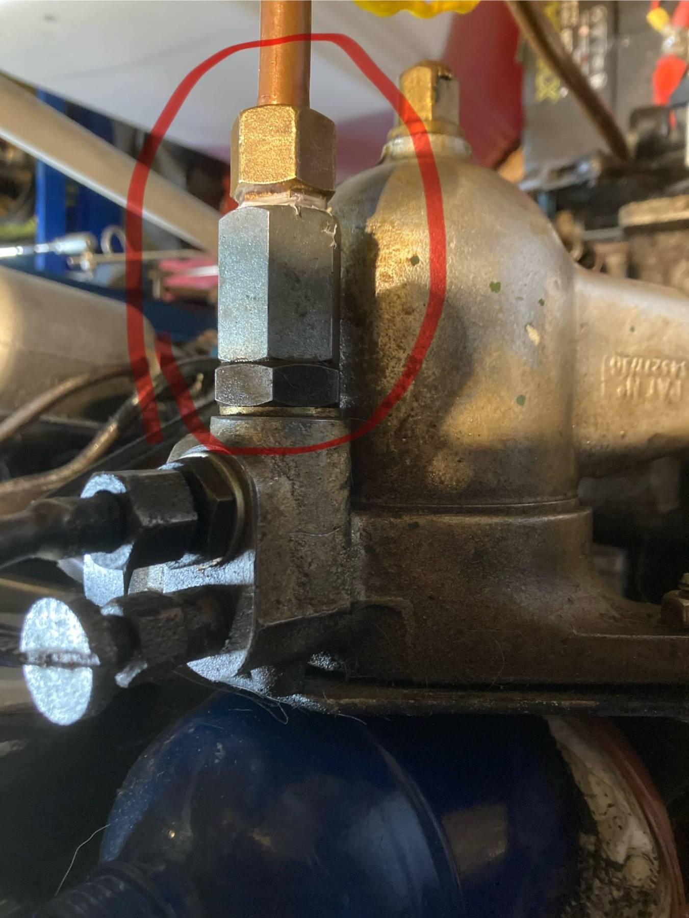

Hi
on a 3 LW the return is seeping, I can’t remove the 10mm pipe from the silver hexagon piece, I suppose spacer, I’m assuming it is a full internal thread
there seems a to be 2 brass bits, maybe an olive inside outer nut
Think maybe a quick fix when engine was on a fishing boat
any guesses as to overcome the problem maybe something like this with a dowty between silver and brass man’s any ideas on BSP thread size

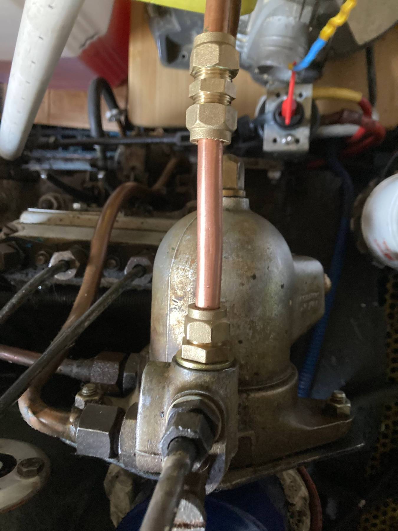

Sorted 3/8”BSP X 10mm compression 10mm X 10mm
running 2 hours not a drip
