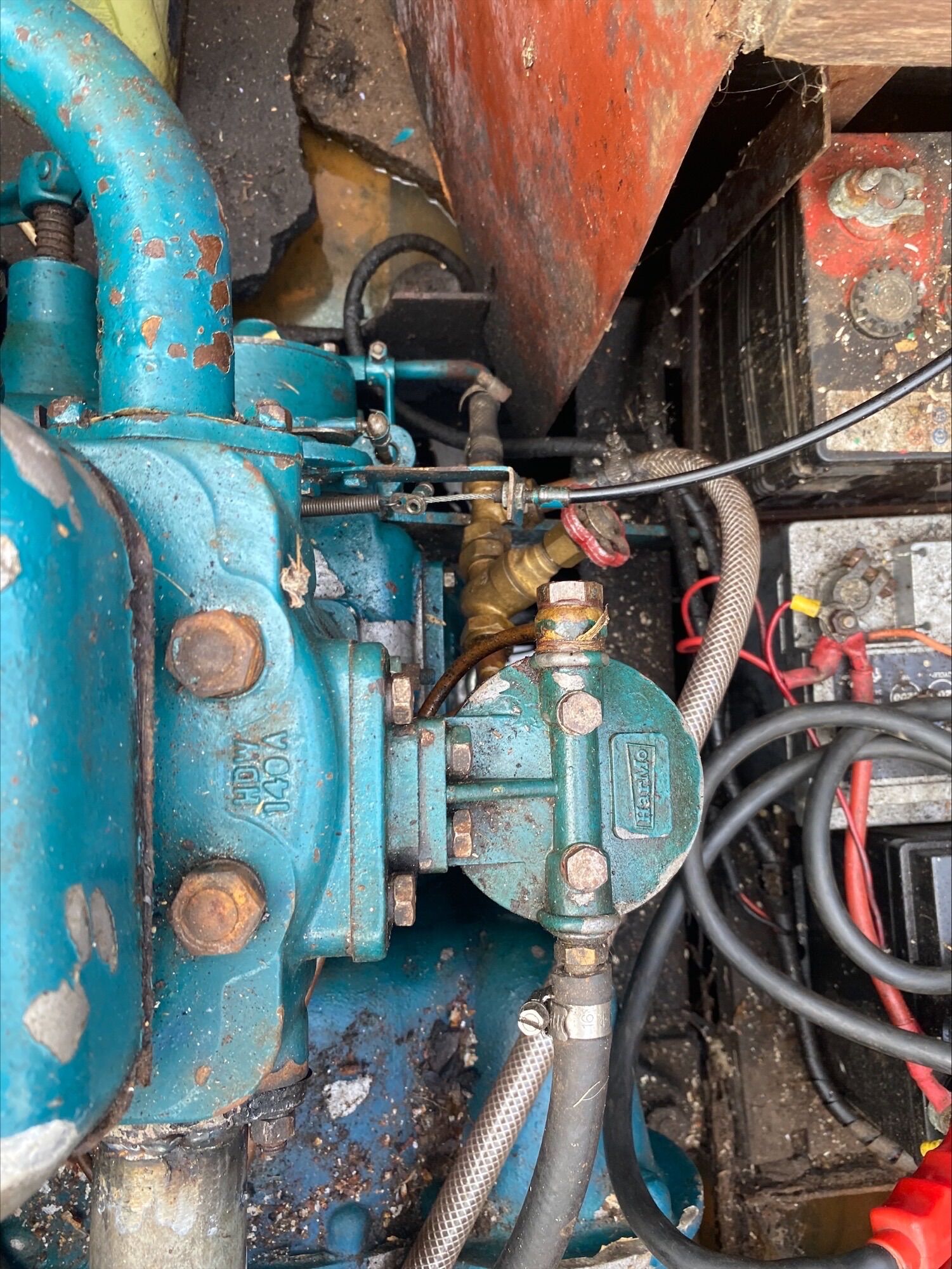

See pics.  This is the engine in our new (to us) narrowboat.   Other than the pics I know nothing about it so would appreciate a few pointers and direction to some reading material.
Went to the seller today to have a lesson on the starting procedure.  All seems quite simple(ish) but it didn’t want to start. I think a combination of water in diesel, their unfamiliarity with it and the fact that the gear lever slops about and ‘neutral’ is a bit hit and miss so initially I think we were trying to start it in gear.
Got it started and running nicely on tickover with the help of some easy-start eventually.
Starter motor is also a dynamo (which doesn’t work) and someone has tried to fit an alternator in the past but not sure how they thought they were going to run a belt to it??
Starter is sticky and engages about half the time.
Any pointers or leads for replacement parts appreciated.  Guy working on it said parts were pretty much unavailable but also honest enough to say he didn’t know much about them so that may or may not be the case.
They’ve got a few thing to sort before we take delivery. Happy to keep the original engine if I can make it reliable.

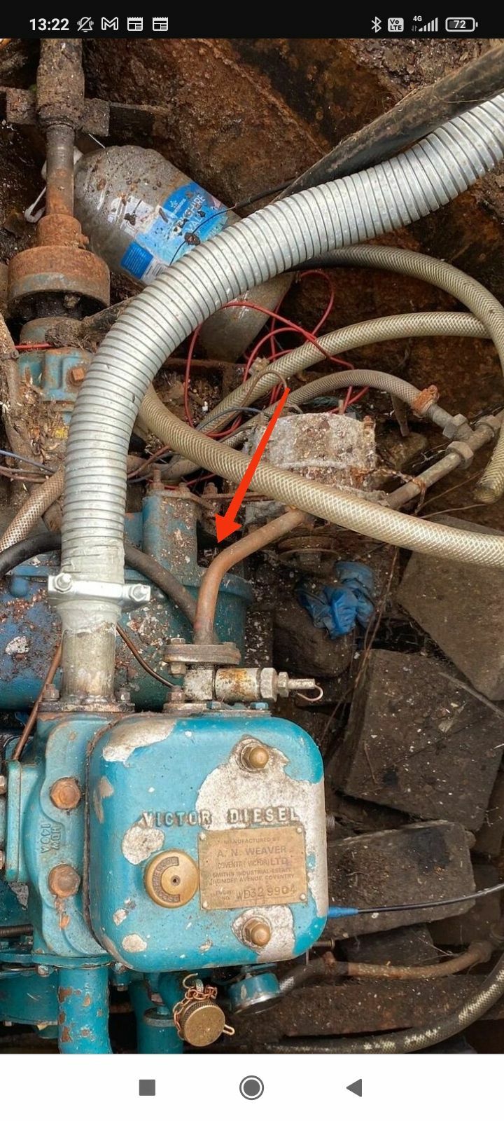

There is an alternator there but can see how they intended to drive it.

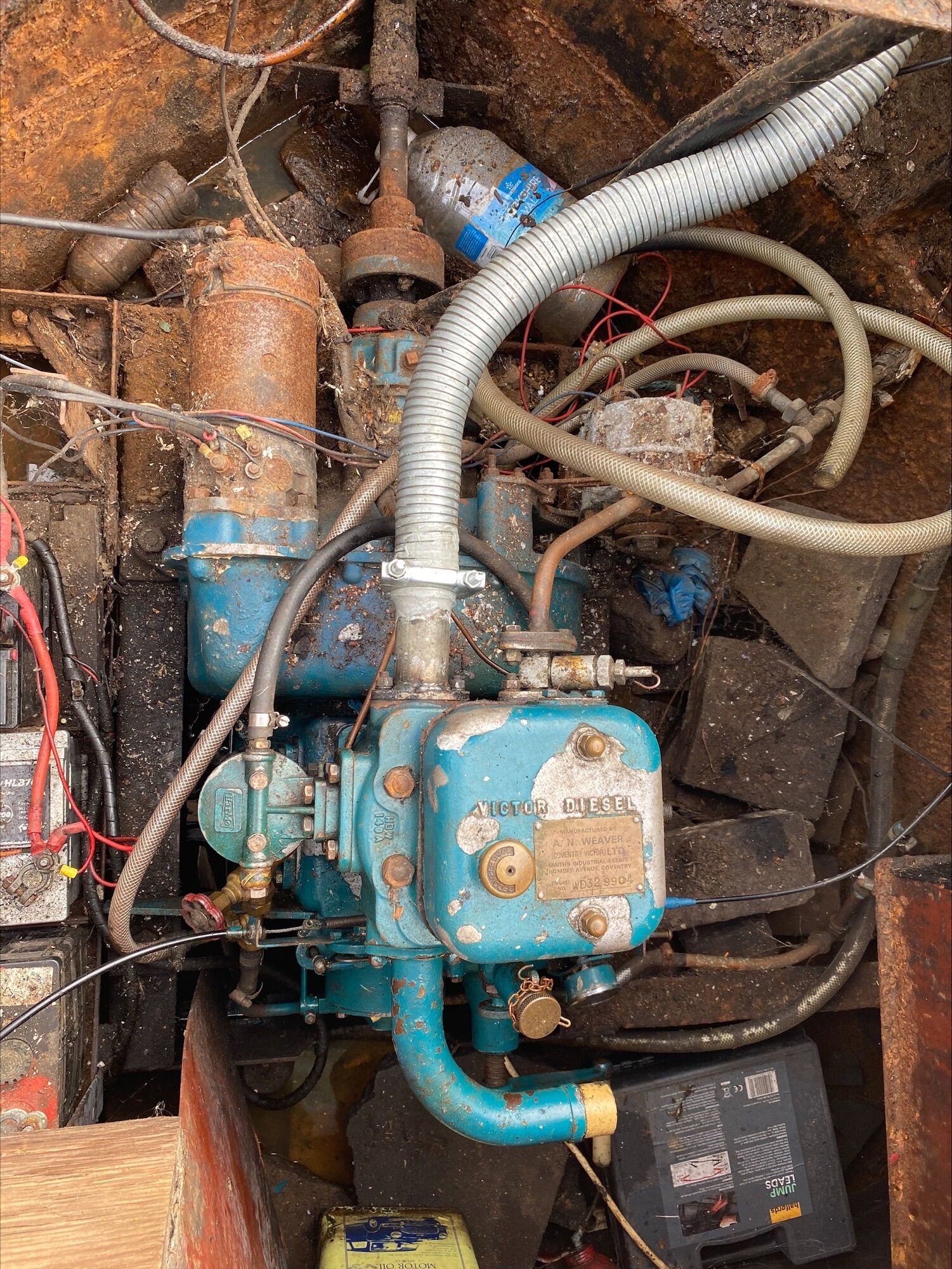

Other pics now attached.  You can just about see the hand-start.

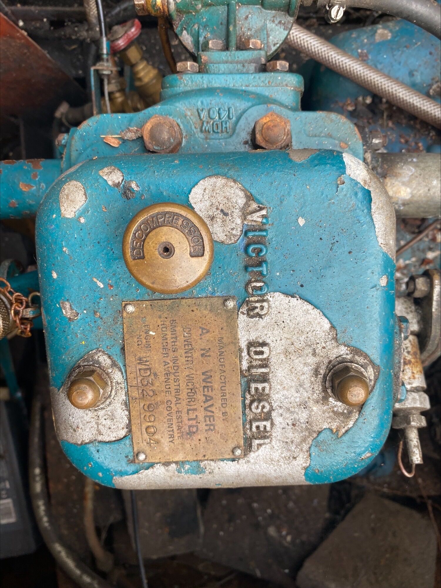

Thanks for the link.  I presume from that site and the plate on the engine that we have a single cylinder WD3. I’ll contact them and see if they have a manual as they seem to suggest might be the case. It’ll be a good start.

As mentioned the starter needs to come off, be stripped down new brushes and possibly also rewound.
Not a particularly cheap job. It looks like it has been underwater or under some drips from the deckboards.
The alternator is odd. Presumably there is a crankshaft pulley in the little opening to the left of the alternator to the belt drive.
Nice little engine if it all works but could be scrap being realistic.
Just thinking what else they put these on. Not sure if it was just for marine use or other things had them.
If that is a dynostart it seems awkward to remove the belt(s).
Is it definitely a dynostart rather than a bendix starter motor?
Its curious. I once looked at a boat with one of these in it but never investigated it any further.
ETA its not a dynostart it is a Bendix type stater motor.

And the alternator may be original and intended to be used with a link belt of some sort.
I bet there is a pulley in that little opening.
Someone has assumed that all starter motors have solenoids on the side. The Bendix type don't. They throw the pinion forward by inertia on a special helix with a spring to disengage.

The housing around the starter motor end is deceptive. I'm sure there is a ring gear in there. If you look carefully and ignore the odd shaped casting it is large enough to accommodate a flywheel and ring gear.
The starter I pictured is advertised for a Coventry Victor WD3. The OP engine says WD3 on the top of it.
I also think the alternator is factory fitted and was driven by a pulley from the crankshaft at the gearbox end..
If it was a dynostart how would you get the belt(s) off for servicing ?

Also if it was a dynastart it would need a way to tension the belts.
I'm sure that when you unbolt and withdraw it you will find it is a bendix type starter motor.
The more I look at the pictures the more I like that engine. Looks a mess but in reality it might be a real gem.
