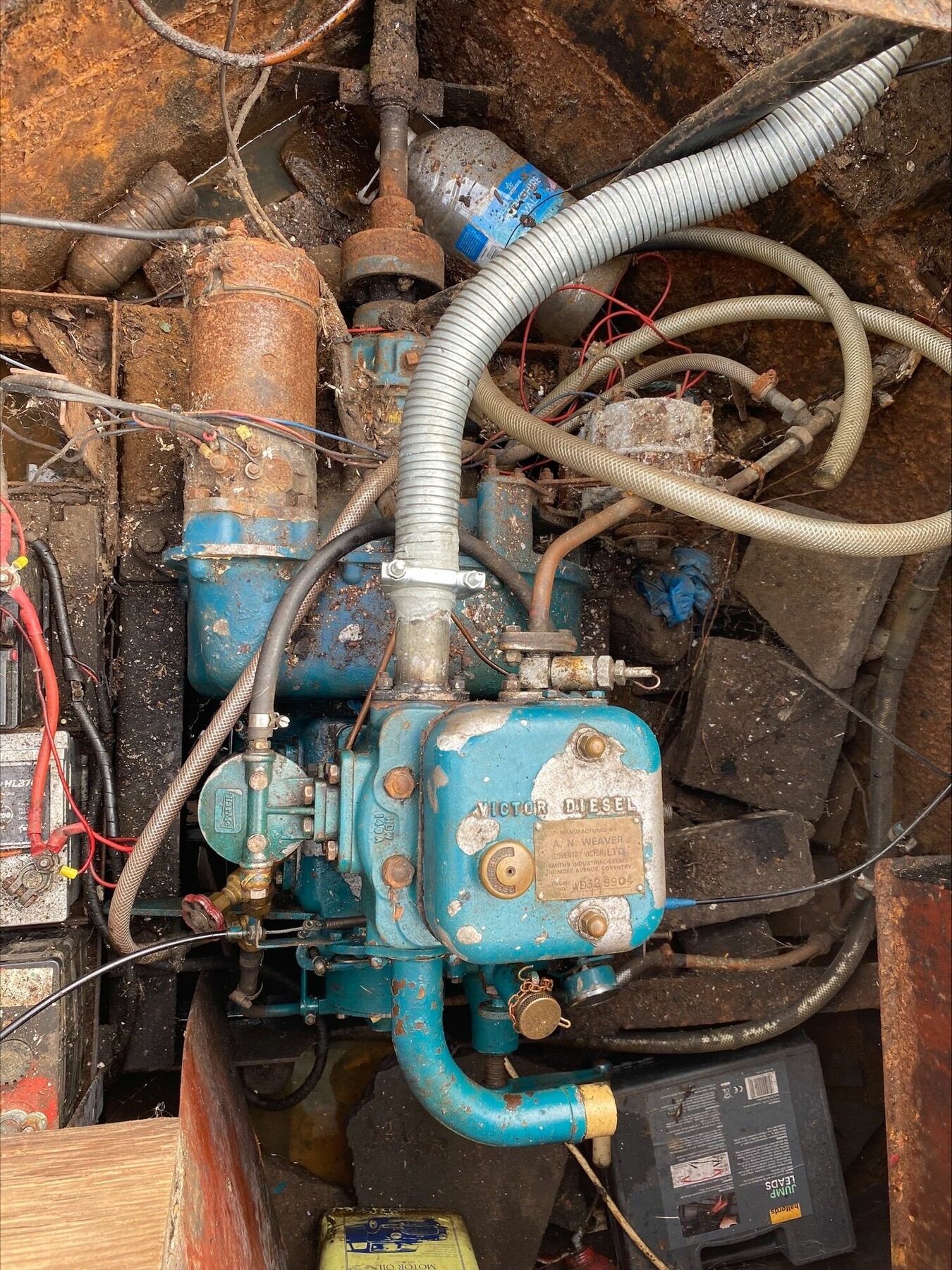

Well. Not sure which of my threads to post this in.  But it’s mostly engine related so this one seems best.
Boat was delivered to Croxley yesterday and we picked it up this morning to cruise to Harefield.
Thanks to the advice on the forum I’m now the leading expert on starting Coventry Victor single cylinder diesels.   Bit of blowtorch around the inlet and away she goes on the first turn.  Keep waving it around as it’ll want to stall until it warms up, then away it goes.  Couldn’t have been easier.
Set off slowly.  And LOUDLY!   Lovely old engine but really isn’t conducive to conversation.
Anyhow.  Took it slow, in part to ease ourselves into it but also because much of the route is moored boats and I always thought you were meant to be on ‘dead slow’ past moored boats.
Much longer than we thought but we ran from 10:30 until about 5pm.  Engine never missed a NOISY! beat.
Until about a mile from Harefield and it became unresponsive to the throttle and eventually stalled and we cruised into the towpath.  Classic sign of overheating on engines that I’m more familiar with.
Let it cool.  Starter still a bit hit and miss. Either a half-hearted rebuild by the marina or the ring gear is badly worn. Not great surprise given its age.  But it started.  And we carried on for almost all the remaining distance and then it did it again.  Maybe about a mile.  Getting too late to start getting the tools out as it was getting dark and more importantly we’d left our dogs at home on their own.
Did have a quick look though.  Engine clearly very hot, which it hadn’t been earlier in the day as far as I’d noticed.  Pipes on the cooling system were ‘hot’ but could well have been radiated heat. Header tank however was not hot at all. Could easily stick my fingers in it.  Suggests to me that it’s not circulating though why it took several hours to become apparent I’m not sure. Presumably it had been fine.  On a car my normal workaround would be to take the thermostat out as a failed one would be the obvious issue and I’d just bypass it.
But I have an original manual and can’t see any mention of a thermostat or can see one in the system.
Suggested causes in the manual are water low (it’s fine), blocked passages (need to flush them through, worn pump, or of course head gasket failure.
We’re going back in the morning as I’m pretty sure she’ll make it the remainder of the distance regardless and probably best to just take up the boards to keep it as cool as possible and nurse her down there.
Open to suggestions of stuff I can check if anyone knows, or how I can check if it’s circulating.
It may well be coming out anyway as it’s so bloody loud. I’d certainly be inclined not to run it in the marina for the sake of the neighbours, but I’d like to have it running for a while if I can, if only as it’s such a lovely simple old lump.
All suggestions welcome.
Oh and definitely not a weed or debris issue. Checked prop and clean as a whistl though we had been through an awful
lot of weed.
Maybe a blockage in the cooling pipes.
From the pictures it seems to be skin tank cooled rather than taking water from the canal.
Presumably that is why it is so LOUD as there is no silencer. If you fitted a Burgess silencer or just a normal small car type silencer into the flexible steel exhaust pipe it would make a huge difference.
I think this is meant to be a direct cooled engine taking water from the canal/river/sea and it has been rearranged to use a skin tank welded in to the side of the boat.
Dry exhaust will always be very loud with no silencer.
The overheating will be rusty bits in the coolant I think.
How far did you get? Must be quite close to Harefield. Black Jacks lock?
lot of weed.
We’re literally just before the final lock.
It does have a silencer. Not sure what type but the noise seems to be more ‘engine bay’ noise rather than exhaust.  The actual exhaust is a nice gentle ‘phut’ if you can separate it from the din.
Yep.  Probably just needs a good flush through.  I was surprised we had literally a whole days cruising before we saw any issues.  Ran lovely prior to that.
Edited by truckcab79
Thats good.
That engine will be fine. If it is too loud get a silencer box in the exhaust pipe..
And probably worth disconnecting all the cooling pipes and running everything through with a hose to clear the crud. If it did 10-5 then its not a problematic engine just needs some sorting out. It would have overheated much quicker than that if there was anything badly wrong.
That's a dry exhaust with no silencer. I think you could fit a small silencer on there with a bit of work and it would make a massive difference to the noise levels. Maybe a scooter silencer could be worth considering.
