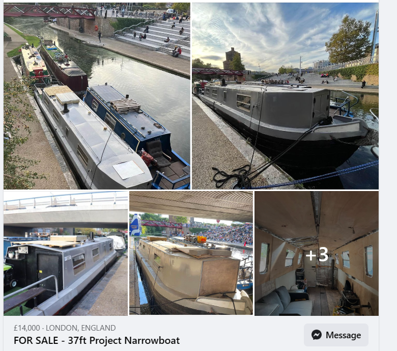

On 14/09/2023 at 21:28, ditchcrawler said:
I am just watching two girls who are doing an old Springer on TV on floating homes. More 4 They were going to do it for £10k in 6 months
Its now for sale on Facebook
[AS FEATURED ON MY FLOATING HOME - CHANNEL 4]
Built by Springer in 1986.
A fantastic opportunity for anyone looking for a project boat with lots of potential. Due to a number of personal challenges we are unfortunately no longer able to continue with renovations.
We have fully stripped out the interior and installed an enclosed steel bow, expanding the liveable space inside. The cabin has been stripped back to bare metal inside (above gunwhales), treated and coated with red oxide, insulated and had new plywood boards fitted across most of the internal space. The exterior has also been stripped back and repainted.
The boat is ready to be finished to your specifications, without the hassle of stripping out.
No boat safety certificate as it’s empty internally, and BMC 1.5 engine not currently running, but not seized.
Price reflects these issues and I am open to reasonable offers for a quick sale.
The hull is in good condition (and was blacked within last 3 years) and the boat comes with the following:
2x 100w solar panels
1250V inverter
3 Leisure batteries and 1 Yuasa starter battery
Engine serviced at the end of 2022 with new core plugs and a new head gasket fitted, and filters cleaned.
2 new anodes fitted in June 2018
Plumbing and infrastructure for kitchen and bathroom including shower pump and disconnected calorifier
Plumbing and infrastructure for pump out toilet if desired
Large water tank in bow
Multifuel wood burner and brand new chimney ready for fitting
Original windows - removed, cleaned, treated and resealed
Fibreglass insulation below the gunwales.
The boat can be sold with materials for renovation, including a large amount of plywood, paint, electrical parts and a couple of pieces of furniture (fold out table and small IKEA sofa) as can be seen in the photos.
I’m open to reasonable offers so if you’re interested and need more info then please get in touch. Viewings available.

That was a quick decision, only yesterday they seamed to love the idea of London boat life, what a change of mind in only 24hrs. No mention of the 2x electric rams In the ad, must be keeping those and putting them to other uses.
The worst programme ever, showed the type of new London boater quite well though😂

https://www.facebook.com/marketplace/item/1829339870815308?ref=search&referral_code=null&referral_story_type=post&tracking=browse_serp%3Ae2e70a1f-4485-4575-b349-d362f55cc9c3
Interesting standard of finish, I'm thinking of buying a blunt axe and calling myself a boat fitter.
Its certainly news to me that project boats don't need a safety certificate.

Perhaps they hoped the programme might help them sell the skip boat for a better price. If so it doesn't seem to have worked too well.
So.
14k, minus what it costs to remove the hideous and poorly constructed fwd extension, and put right any damage caused.
Minus what it costs to take the boat back to bare metal internally, as what they have done looks substandard.
Shall we call it 4k. Ok, I will be nice and round it up to 5k!

If there is no electricity, gas, or fuel sytems installed then there is nothing for the examiner to examine. No need for a BSS.
Same as you don't need a BSS fo an 'open boat'** powered by an outboard.
Or even a boat with an open cabin (aka 'cuddy)
I'm pretty sure you need a BSS on a boat with an enclosed cabin though, even if the entire checklist is marked "Not Present"
And the correct labels on the water and diesel filler, obviously!
Less sarcastically, an enclosed cabin will need fire extinguishers, smoke alarms, CO alarms.  If there's a battery to run eg lights and water pump that will need to comply.
You type faster than me 😎
Exempt and Non-Private Boats
For a craft to be exempt from holding a valid BSS Certificate it must meet the following criteria:
  • No permanently installed engine or motor, therefore must be propelled by an outboard only
  • No appliances installed for cooking, lighting, heating or refridgeration
  • Open boats only, therefore no small sleeping cabins
