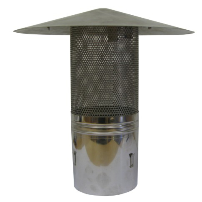

20230809_153911-min.thumb.jpg.999d04688eabe12466910fef21643bf9.jpgHi all.
I am new to boating as a live aboard and I had my first winter onboard 2022-2023.
I have just had my cratch cover replaced as it had preexisting holes burned through it by embers from the chimney.
These got progressively worse / there were more after my first winter.
How do I stop this from happening again?
The fitters reckon this is a common problem so I hoped the hive mind would be able to recommend things that I can do.
Thanks for your help in advance. 😊

I wonder whether a different chimney might help, one that doesn't have a flat cap that an ember might bump into and lose upward momentum. Perhaps one of the ones that turn with the wind like this one Narrowboat Chimney Bird Cowl - Smokie Joes.

I've never had that problem but then I've never had one of those stupid cones on the top of the chimney.  I also operate on the October to April  principal.

Ditch the coolie hat, it will only drop tar onto the roof. When the fire is out cover the hole with a dog bowl or saucepan sans its handle.
