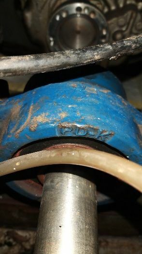

matty40s Posted July 8, 2023 Report Posted July 8, 2023 (edited) We have repaired several this year, you can buy this bit.. For a damn site less than £800, and you can also get the internal bearing for that onnits own for less than £50. I suppose you want the £800 blue one dont you. You also need to make sure you get the correct length if buying the middle bendy bit. Keep the locking thingymabbobbit off the old one( seen to the rear here as some of the newer ones dont fit on the shaft and might not lock properly. Edited July 8, 2023 by matty40s

matty40s Posted July 8, 2023 Report Posted July 8, 2023 Just now, TeeELL said: I require the complete unit unfortunately. So you keep telling us, but it doesnt ALL fail, one or more bits fail...and most can be replaced cheaper than the whole unit.

matty40s Posted July 8, 2023 Report Posted July 8, 2023 1 hour ago, TeeELL said: Look guys, the drive is comprehensively k*******d, 50p seals, wrong coloured bearings etc etc will not repair the fault. I am not a Python Sales manager - if I was I am sure I wouldn’t have needed to ask for advice here. It is a dig deep replacement regrettably. I am trying to ease the pain by determining if I can do the job myself and not bother a nearby boat yard and, undoubtably, get the cost to over a grand. The " wrong coloured bearing " is exactly the one that Python use, at a 1/10th of the cost. You asked if anyone had experience of replacing pythons, yes, but we also try to save our customers money
