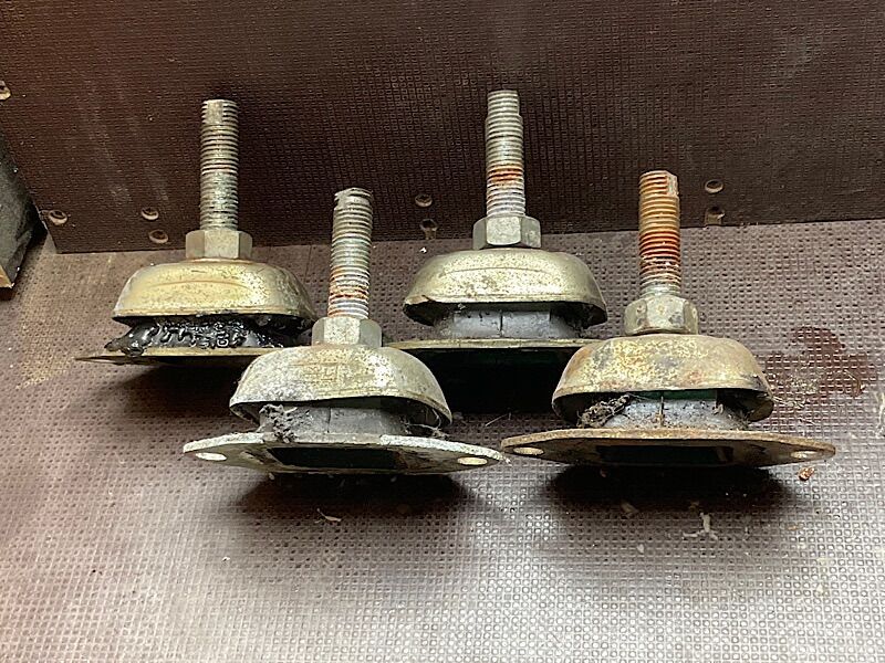

All done, new parts fitted and we are underway with a much quieter, vibration free boat AND the oil pressure gauge is reading properly again. Eeyor, thanks for the advice. This topic is now finished. Thanks to all the folk who offered advice, I am now a little more knowledgeable of the world of narrowboat mechanicals. -

Thanks Tony once again. Looking at the originals it would appear that the set up is such that the ‘supporting nut’ is actually hard against the top of the rubber mount. I will take a photo shortly to show that they really are ‘shot’. Here are the removed parts: -

‘Spec’ the engineer at Star Line boats insisted on checking - he had another customer with a similar problem last week; after the check he was able to reassure the customer that his issue lay elsewhere. His comment to me ‘it makes a pleasant change to find a customer who’s diagnosis is spot on’. We worked together to remove the old parts - and they do show serious signs of distress. Tracy, I have ‘a few bob’ in reserve and I am sure I can survive with one kidney! Lol ‘Be Over Another Thousand’! Thank goodness for Royal Air Force pensions! -
