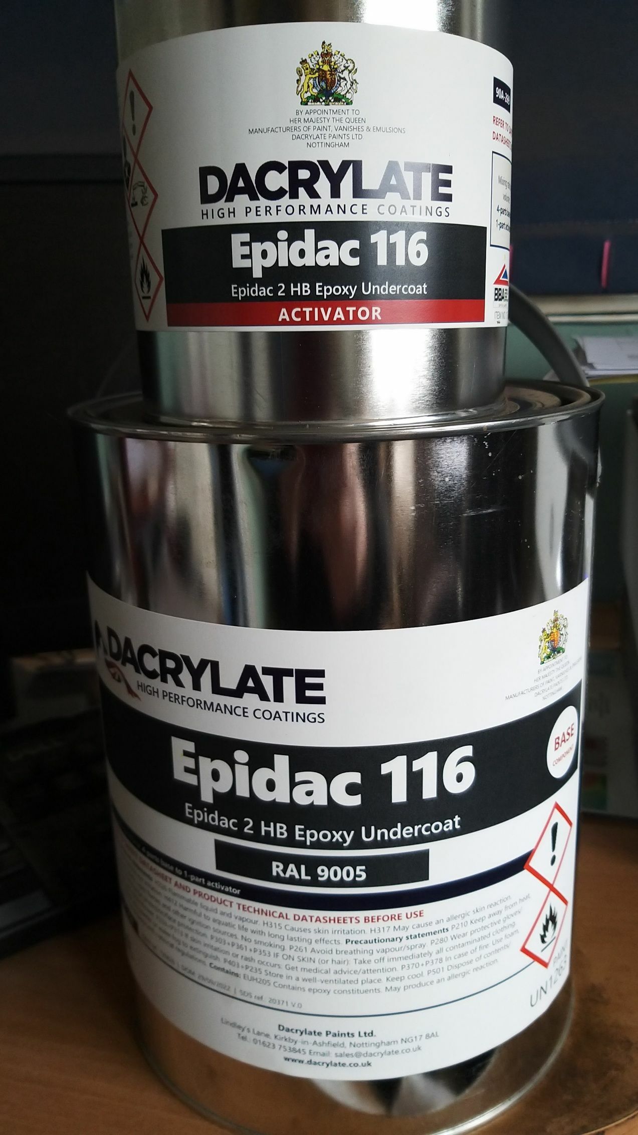

matty40s Posted January 30 Report Share Posted January 30 Ignore the prices this was the info from 2 years ago... Epidac 116 Black - £49.27 per 5L composite pack (4L base + 1L activator) - this is the product to go over Comastic. Any areas of bare metal with the comastic would ideally be spot primed with our Epidac 115 Aluminium which is £52.34 per 5L composite pack. This gives the anti-corrosion protection to bare steel 1 Link to comment Share on other sites More sharing options...

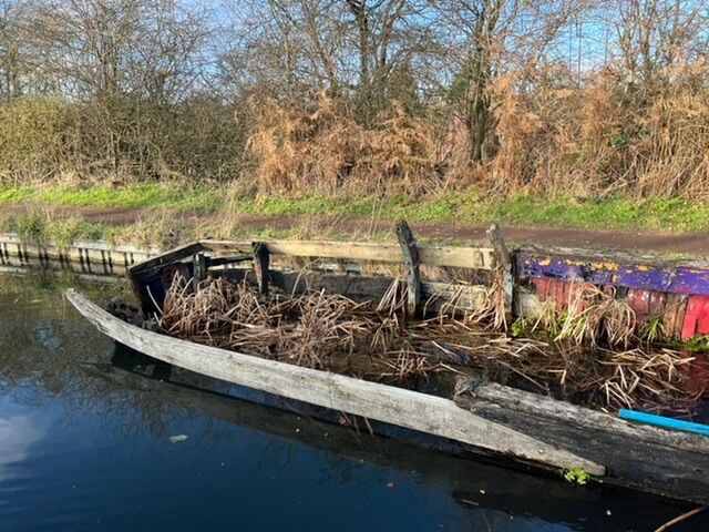

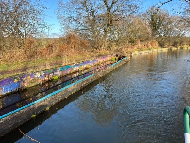

Goliath Posted February 1 Report Share Posted February 1 Here you go rusty69, this is what happens mixing epoxy and bitumen! Can happen in two weeks or two years. But it’s sudden death 💀 either way 1 2 Link to comment Share on other sites More sharing options...
Rob-M Posted February 1 Report Share Posted February 1 2 hours ago, Goliath said: Here you go rusty69, this is what happens mixing epoxy and bitumen! Can happen in two weeks or two years. But it’s sudden death 💀 either way Is that the one on the Stourbridge...? 1 Link to comment Share on other sites More sharing options...
matty40s Posted February 2 Report Share Posted February 2 21 hours ago, rusty69 said: Well, mr dacrylate is reading this thread right now. You might get it straight from the horses mouth if you are lucky. This is what I have used since Comastic was removed from the planet. It is a high huild epoxy coat that can cover chlorinated rubber, vinyl, acrylated rubber, oleo resinsous, alkyds, silicone alkyds, and similar. It is a Highways England product. It is not the same as the SML product to my knowledge. 1 Link to comment Share on other sites More sharing options...
rusty69 Posted February 2 Author Report Share Posted February 2 24 minutes ago, matty40s said: This is what I have used since Comastic was removed from the planet. It is a high huild epoxy coat that can cover chlorinated rubber, vinyl, acrylated rubber, oleo resinsous, alkyds, silicone alkyds, and similar. It is a Highways England product. It is not the same as the SML product to my knowledge. Thanks for that. I think I am going to use one of the Jotun products, probably Jotmastic 90. Whilst I have been able to determine that the SML ballistic epoxy is not the same as the Dacrylate epidac 2 HB 90-294 (though the numbers are the same), it has similarities, according to SML. The comment made by dacrylate paints that 2 HB 90-294 is NOT designed to go over bitumen, and their reluctance to comment has left me a bit suspicious. Link to comment Share on other sites More sharing options...
