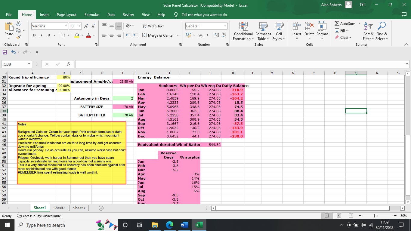

Or you can just do it in the excel spreadheet.
Just fill in the 'blue' column with your power audit and it'll tell you how much solar you need by month, or put in the solar you have and it'll tell you how many months youw eill be self suffcient.
Damm ............ the forum will not allow me to attach an excel document.
Edit to add a screenshot - once you enter your usage, battery size and solar size it shows you both your shortfall / excess by Wh or by %.  by month.
It tells you what size battery bank you need to meet your required days of autonomy, and what total wattage of Solar you need.
If anyone wants a copy send me a PM with your email and I'll forward it to you.
