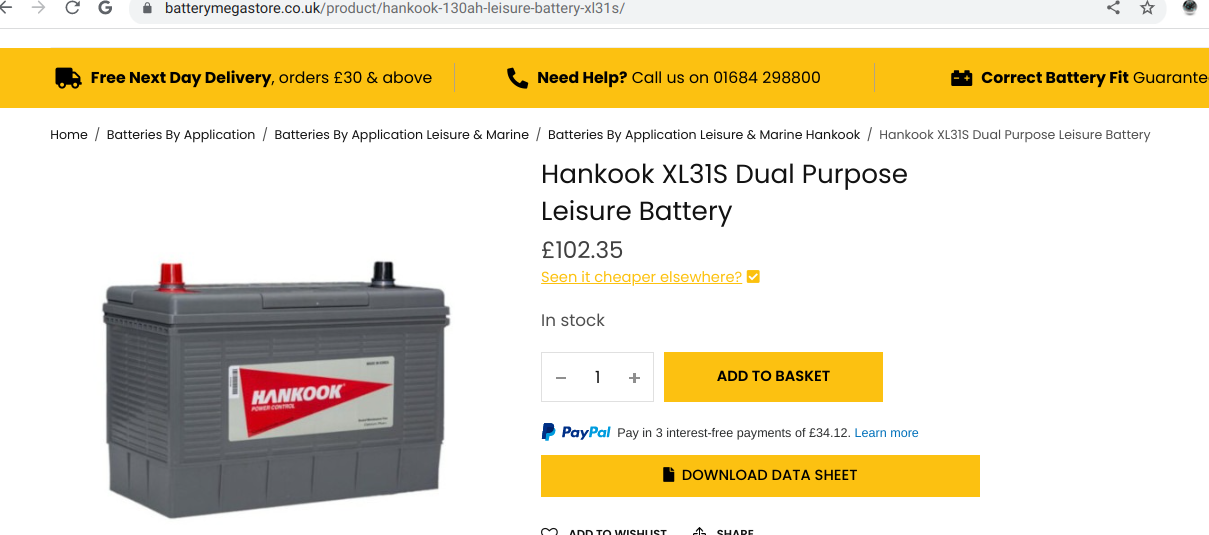

Without thinking too much about my choice, I have rep[laced my domestic battery bank using sealed Lead Calcium batteries.
These ones in fact, although the price already seems to have gone up...
Enduroline Lead Acid Battery
I don't think I have previously had any batteries with calcium technology.
In simple terms what do I specifically need to be aware of in respect of things like charging voltage, please?
Many thanks.
