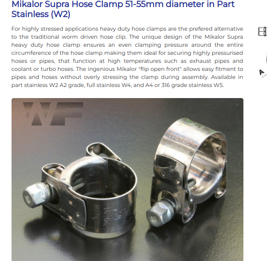

Marine engines should have stainless steel clips really .
This type looks quite good although I cant say I have used them
I agree. Those I think do have flared up sides.
These are good. Expensive though. They also cover a narrower range of hose sizes for each size clip than more traditional jubilee clips, so you need to measure your hoses outside diameter very carefully.
