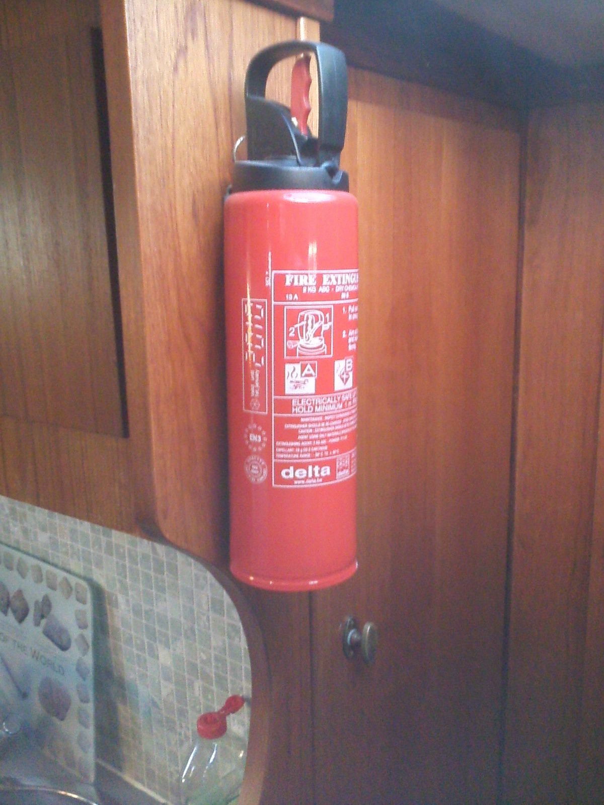

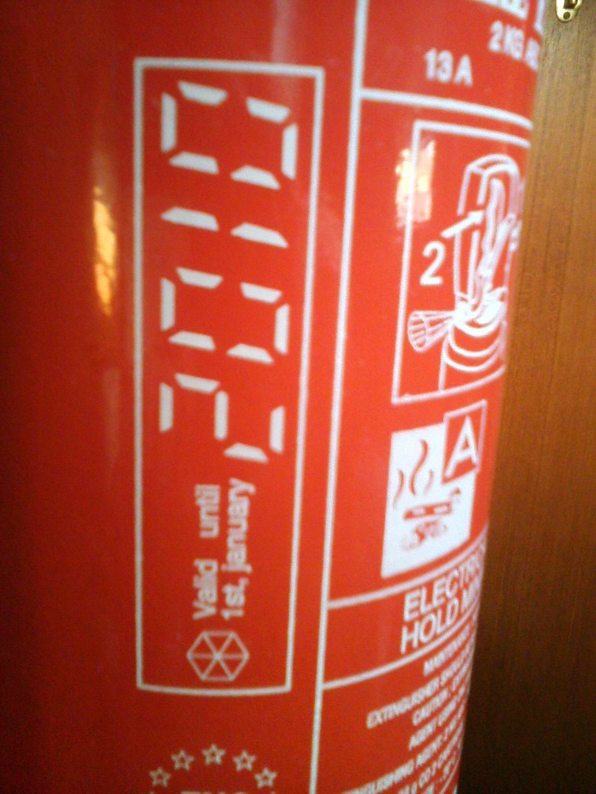

In which case I wonder why the BSS Examiner decide to issue a 'pass' in 2015 when the extinguishers were clearely dated as expiring in 2010.
The examiners (in both 2011 and 20165) appear to disagree with you about the importance of fire extinguishers :
Edited by Alan de Enfield
Perhaps because he didn't have all day to merss about examining every single line of the BSS spec.
