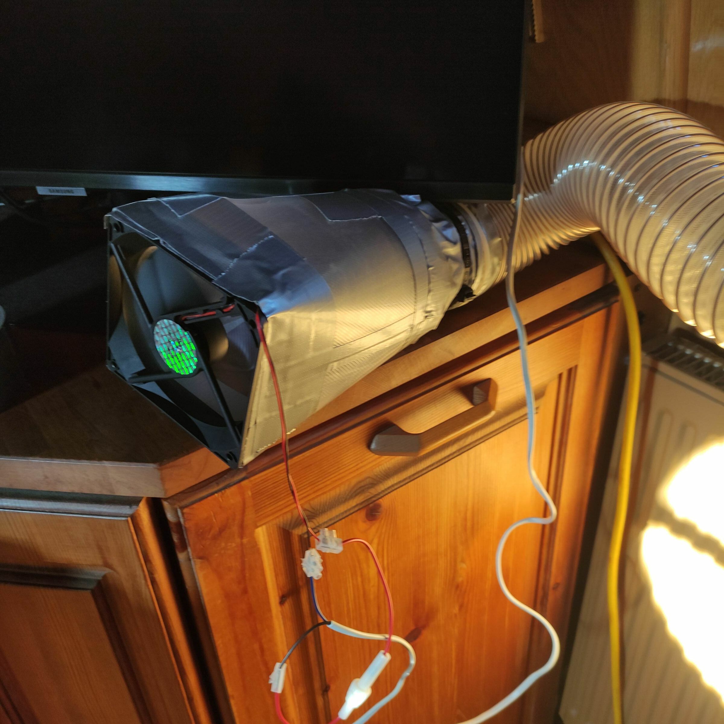

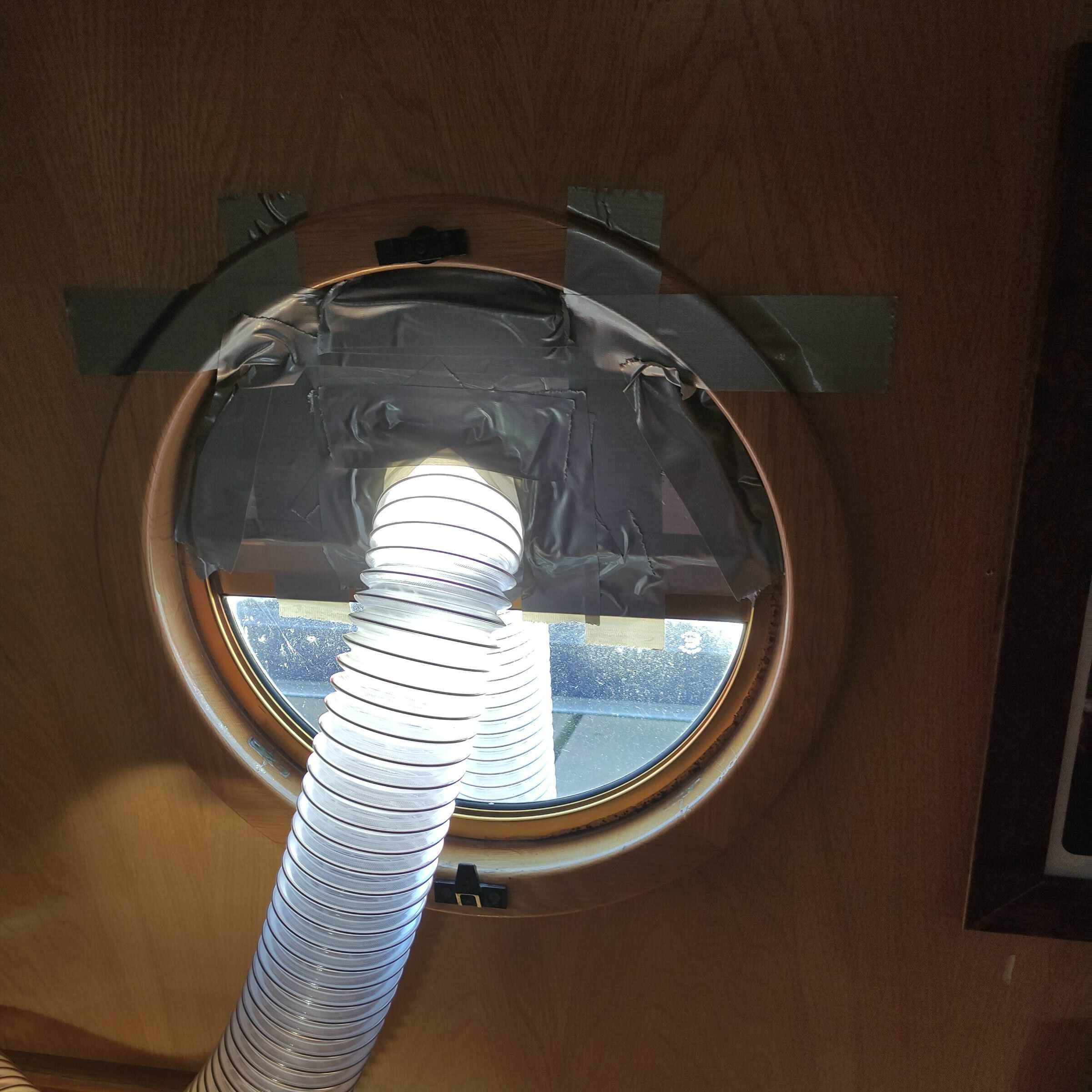

Well this is what I've done using a 12v computer fan (drawing 0.3A). I've sealed the pothole using kingspan and duct tape and also used masking tape over the low level vents at both ends of the boat as the fan is bringing in plenty of cold air from outside. The 4 mushrooms on the roof are still half open but I've taped over the sides facing the prevailing wind.
I've used a 1amp fuse for the fan as that's the smallest I've got. Is that ok for a 0.3A fan? I know the position of the fuse isn't ideal but the 12v socket is fused. I'll figure out a better position for the fan, probably just hang it down from the window.
I don't know the volume of air moved by the fan but it's a lot more than is normally drawn in through the vents. Good job I changed my mind about using the bilge blower!

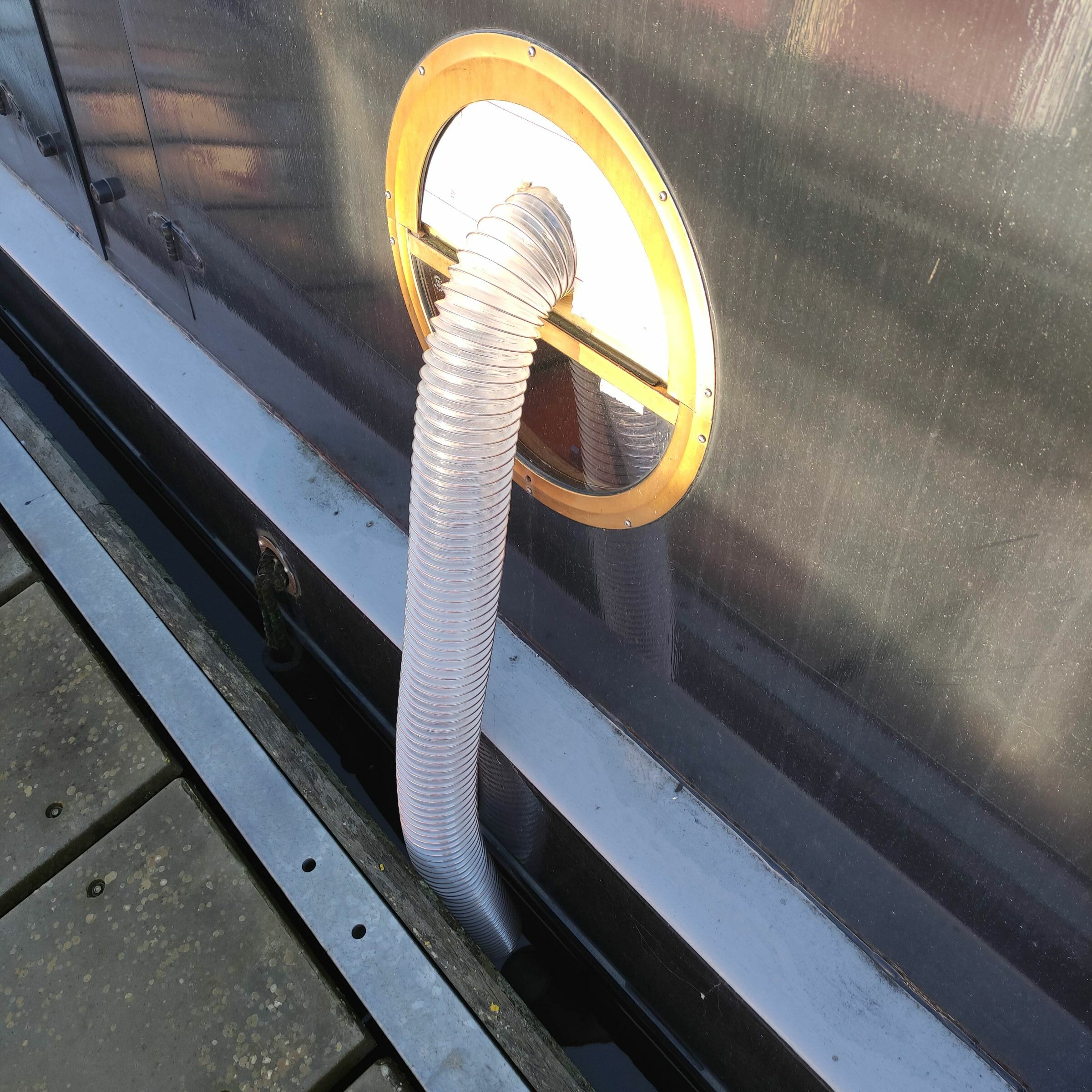

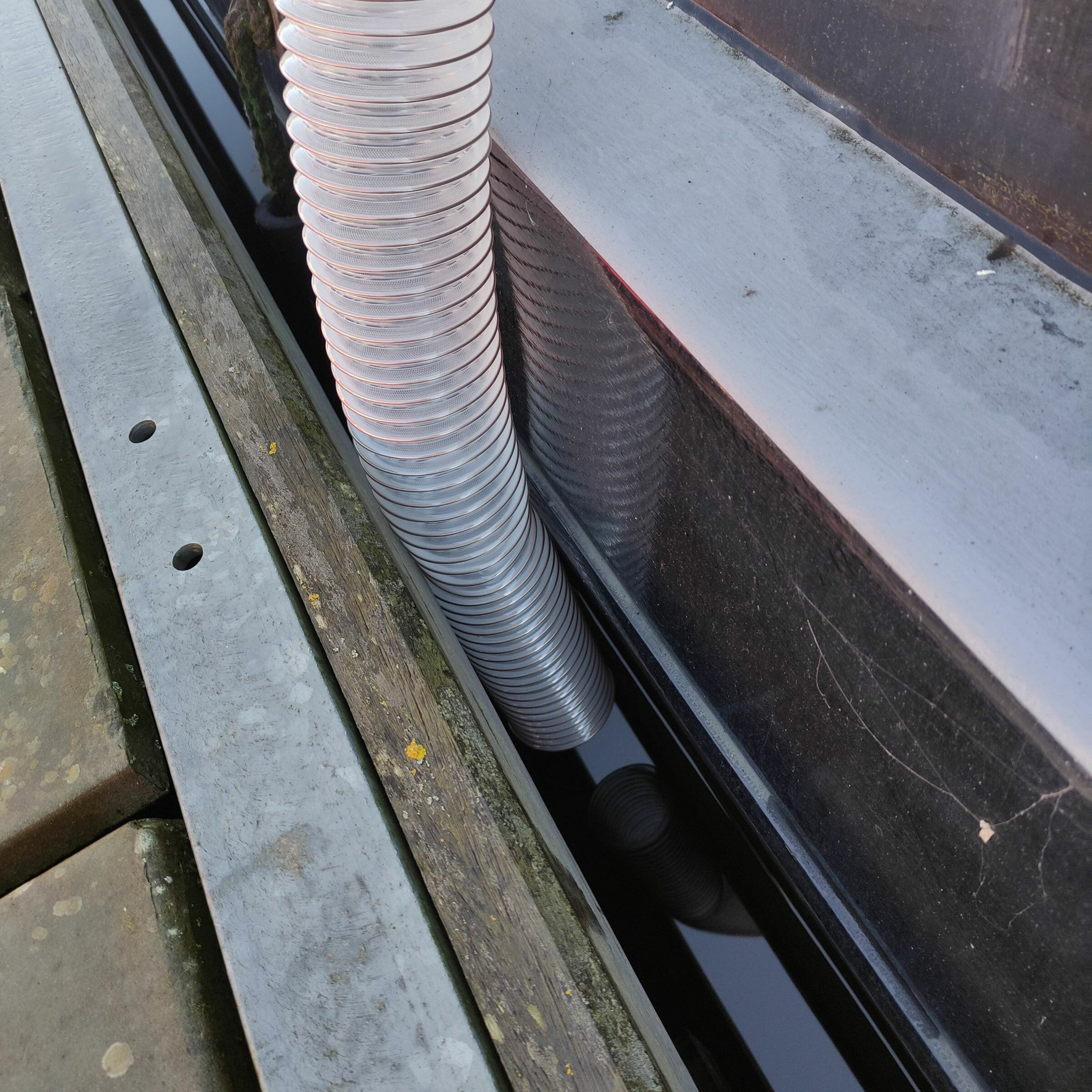

I got the 3" dia polyurethane ducting from eBay. I was surprised at the quality. It's very tough indeed. The end of the ducting outside sits about 5" above the water on the downwind side of the boat. There's no smoke down there.
