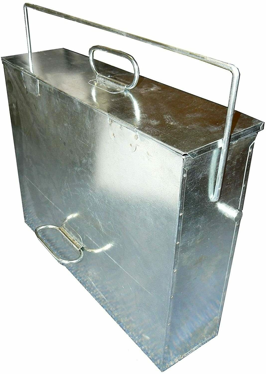

On 06/12/2021 at 21:11, MtB said:
Yep, i should have said so.
I should also have pointed out that rather than a bucket (with lid or not), a "Tommy Tippy" ash container is the thing to use to minimise CO risk. Or one of the many clones around nowadays.
With these, you can put the whole ash pan inside it filled with the ash, close the lid and carry the whole lot outside. Open the lid outside and get the pan out leaving the ash inside. much cleaner than tipping ash into a bucket inside the boat. Then leave the container containing the ash outside with the lid closed to cool and dispose of later once cold. that's how I use mine anyway.
https://www.ebay.co.uk/itm/265313196429?epid=1374579566&hash=item3dc5e6198d:g:oKIAAOSwvVxhQMah
I've got one of these these things but I never use it. The ash pan for my double door 9kW stove is quite big and the oversized carrier is just too cumbersome.
