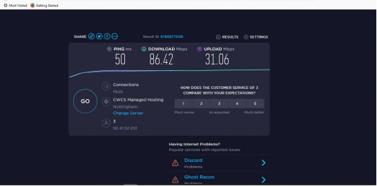

MR600 is crap compared to the 535!
I tun a Huawei B818 at home and see 50mbs minimum normally up in the 80's
Location has more bearing than kit on what you can get.

Equipment does matter more than I implied. In the same location using the the same network,  same mast and cell when looking for a new router I noted the following  maximum speeds
Huawei B525 30mbs
TP link 600 25mbs
Huawei B535 50+mbs
Huawei B818 90mbs
The reason being the difference in the way/speed  they implement MIMO.
