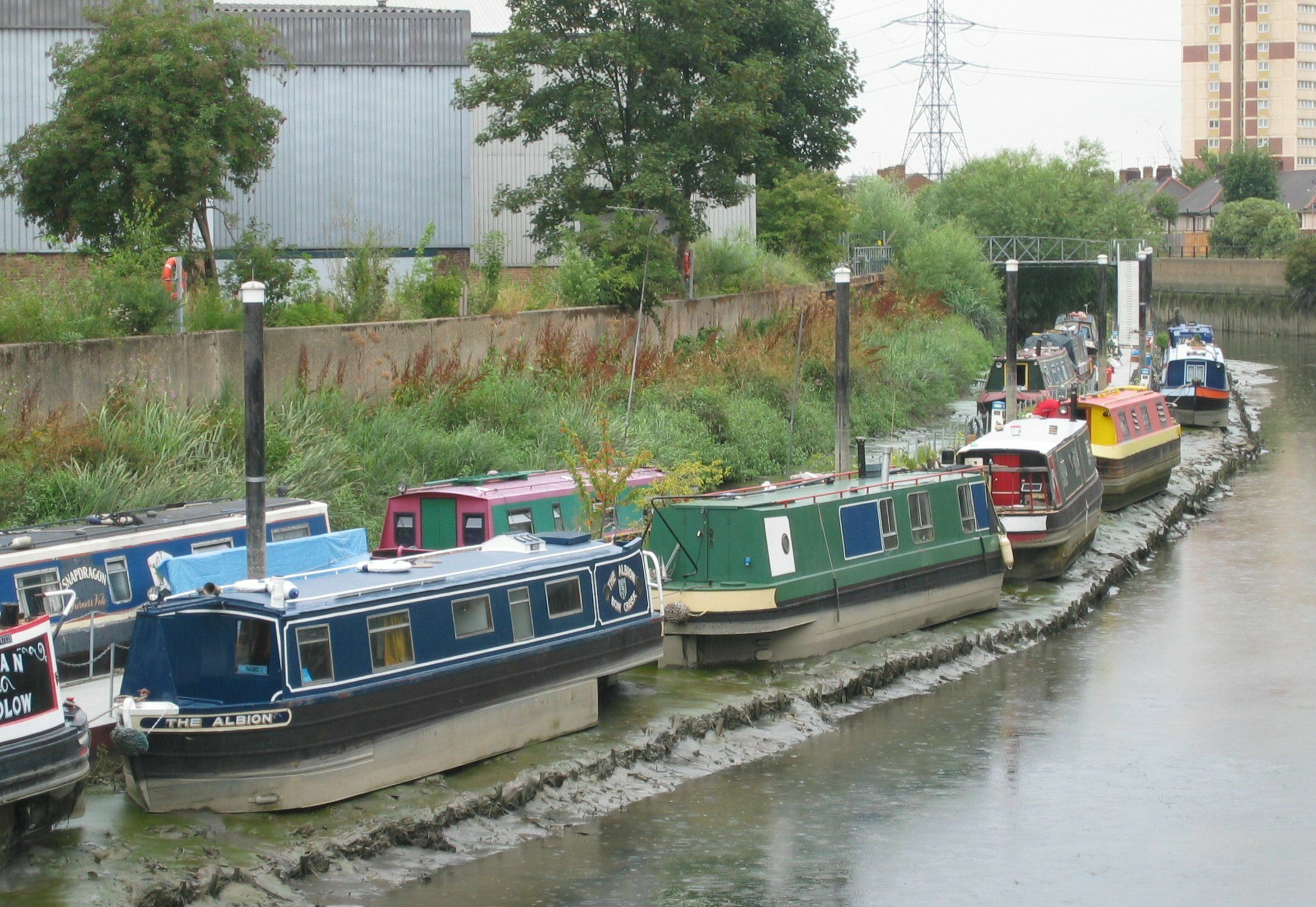

Narrow boats that used to moor on the tidal bit behind Three Mills used to use ropes connected from the offside of the boat under the boat to the floating pontoon to "roll" the boat out of the mud if it did stick.
Narrowboats at low tide on the Three Mills Wall River, the moorings are no longer tidal.
Edited by Tim Lewis
6 minutes ago, Tim Lewis said:
Narrowboats on the Three Mills Wall River, no longer tidal.
I believe that shelf was built to prevent, or at least minimise, mud-sticking instances - as can be seen once off the shelf there is a greater depth of uneven, glutinous stuff.
As an aside there was an unhly row between BW and Crown Estates about who owned the bed
