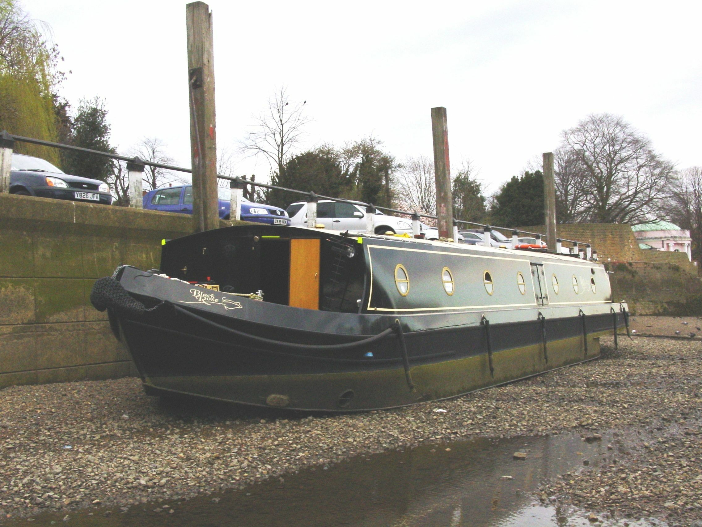

I would also be wary of mud. People beach narrowboats all the time crossing the wash but that's sand rather than mud. I've never seen it done on a narrowboat but lots of people use the mudflats outside Portishead marina and that is most definitely mud. I'm sure it must have been done by narrowboats there too?
The only time I've done it was on the tidal Thames and that was gravel.
Hi Blackrose, great photo by the way. Yes, if it was shingle/gravel as it is in your photo then it wouldn't be a problem but the whole of Penryn river is thick oozy mud at low tide. I am seriously thinking now that I would need to have some sort of addition to the bottom adding, whether it is bilge keels or something similar to stop the flat bottom settling on the mud....question is, how deep is the mud , I have just had a vision of 10ft high bilge keels on it lol.
