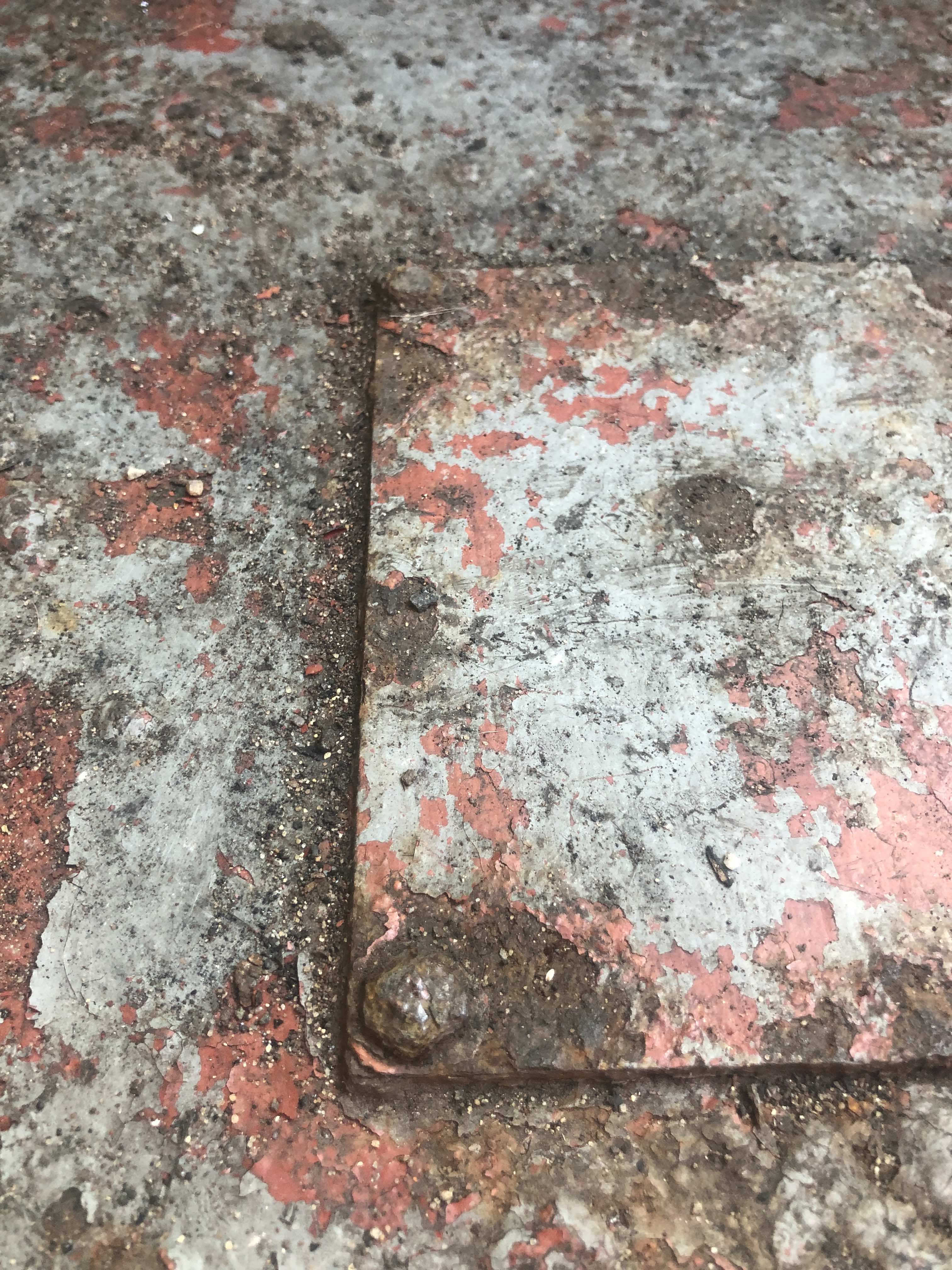

This is what I'm working with:IMG_2142.jpg.add4c10740aa11005be4fa641926975a.jpg

That deck is horrid and needs a bare metal repaint. The hatch is also horrid as it sits proud rather than flush. Do the deck and get a new bigger hatch fitted at the same time, as big as you can manage. Ideally this should be flush which involves welding a flange under the deck which is a bit tricky.
Very unlikely to have an access hatch on the side of the tank as its a big potential leak.
The welding will likely be quicker than the preparation and painting.
..............Dave
Yeah, defintiely needs attention. What do you think - scrape it all back as much as possible, apply a rust converter, then undercoat, then paint?
An angle grinder fitted with a rotary wire brush is excellent for removing that sort of rust. Heavy leather gauntlets and eye protection are advisable in case of flying loose wire strands.
Edited by Ronaldo47
It depends on how long you plan to keep the boat etc etc
I took mine almost to clean steel with a wire cup brush in an angle grinder, then two coats of surface tolerant epoxy primer, then whatever paint and colour you fancy as a top coat.
It has lasted really well, just needs occasional local repairs after big impacts like dropping the windlass on it from a height.
If you can get very close to clean steel then primer is preferable to rust converter.

Leave that foredeck floor to rust a bit longer and you will have all the access that you need !
eh?   I see lots of flaking paint but no sign of serious rust - except the hatch plate that is a load of rubbish.
