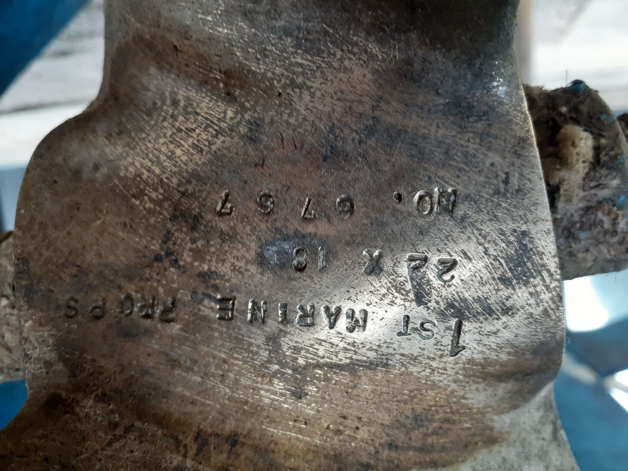

Detling Posted April 27, 2021 Report Posted April 27, 2021 When I moored the other day I had noticed the boat behaving oddly. Today I decided to brave the weed hatch and the cold water, whilst removing the polythene sheet and the thin cutting wire I was able to see that the prop blades are not exactly the same. One is 2cm from the rear edge of the hatch and the other 2 blades are 3cm away. This was visible due to sun over my shoulder and clean water, and time, conditions I have never had on my previous trips down the weed hatch. The boats tiller has had a small vibration in the 6 years since I bought it. So how do I get this fixed, is it possible to get the prop straightened? As the leading edges are not smooth any more, several nicks, will it be cheaper to get a new prop.? How can I find out what size propeller I have without taking the boat out of the water.?

Tracy D'arth Posted April 27, 2021 Report Posted April 27, 2021 The diameter and pitch should be engraved near the central boss. You will not be able to do anything with it still on the shaft. Better to get it fettled, good new props are expensive. Don't be tempted to buy a cheap one, they can make noises that will drive you mad. Its a shame that Crowthers have closed down, they were really good. 1

Alan de Enfield Posted April 27, 2021 Report Posted April 27, 2021 As Tracy says - it will be marked on the boss, if the water is clear enough youmay be able to see it whilst still attached - you could then price up a new one and see which option is the best for you. Example from my props : 1
